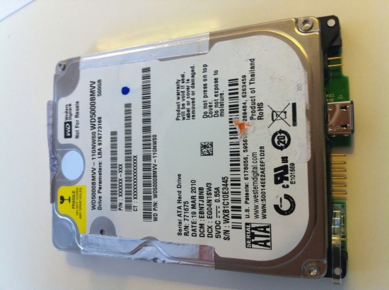

Hey,
I have WD My Passport Essential 500 Gb
WD5000BMVV
LBA:976773168
The drive was working perfectly alright, but recently i've unfortunately upgraded the firmware, apparently it went well and completed but after that the drive stopped appearing in My computer, Disk Management and device manager.
This was backup drive and i had loads of archive data stored in it with no other copy.
I've been trying to contact WD but they are all stupid idiots being of no help at all. Moreover the drive is not a simple IDE/Sata and has no standard connectivity other then USB. there are 12 pin male connectors, but can't find a cable to connect them.
Contacting local technician the only way i figured out was to change the circuit board with old firm ware and the data will be accessible.
Now i dont have any idea where to buy a circuit board for the model, i'm a student and cant afford much for the data recovery companies. can you kindly suggest me how to solve the issue.
I would highly appreciate your time in replaying me, and helping me get my data back.

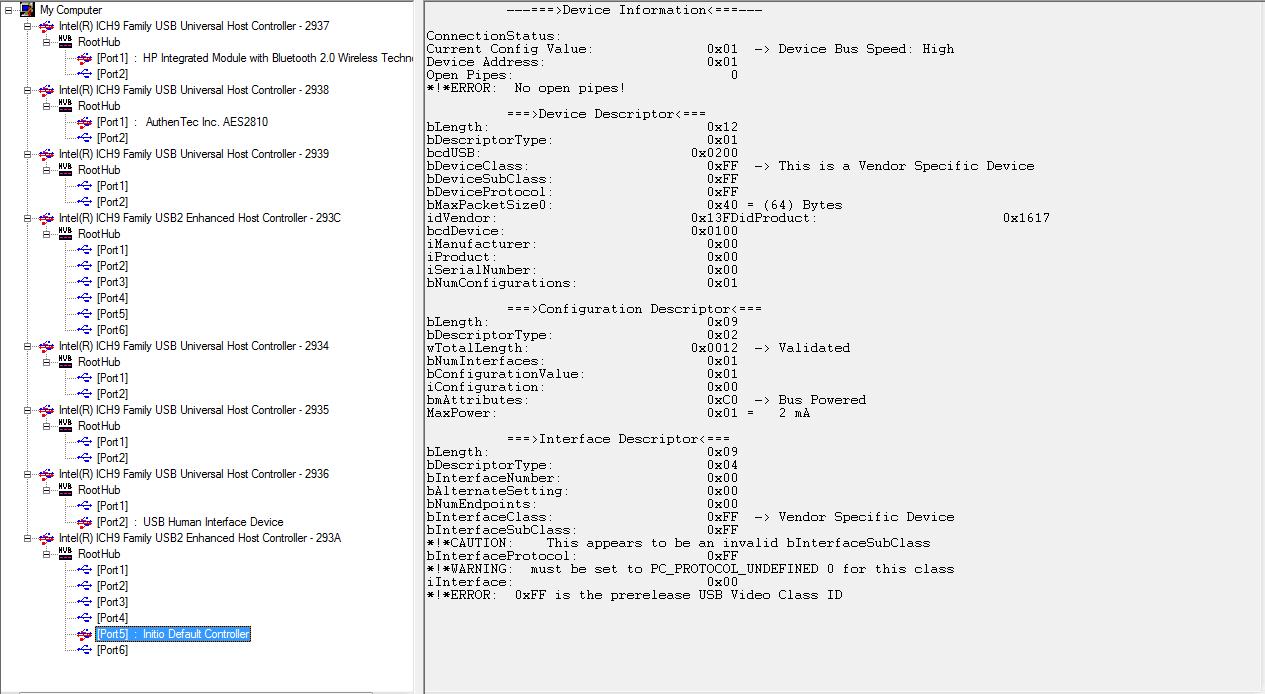

Can you see the drive or its USB-SATA bridge chip with Microsoft's UVCView utility?
http://www.users.on.net/~fzabkar/USB_ID ... ew.x86.exe
Does it still spin up?

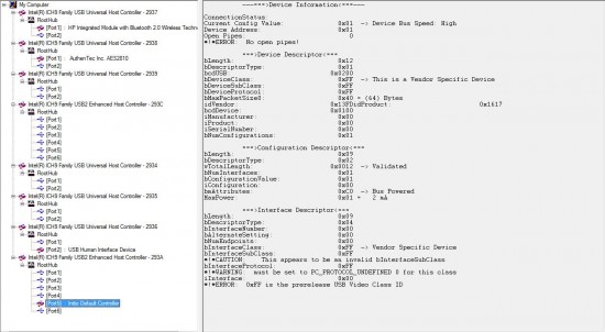

Please find attached image of the USB Device that appears when drive plugged in.
The drive is working and spinning perfectly, i could feel it spinning upon touching and more over the indicator light is blinking, as normal.
The only problem is, the way i can access the drive is corupted, the drive is perfect and hopefully the data in drive is in perfect condition. Just wondering isn't there any way at all to access the drive data other then this USB connection? I wonder what those 12 pins are ment for anyway? :(

The fact that you're seeing the Initio Default Controller suggests to me that the 8-pin serial EEPROM chip attached to the Initio INIC-1607E USB-SATA bridge may be corrupted, rather than the drive's firmware. Other people who have had similar problems with external WD drives have simply removed the SATA drive from its enclosure and attached it directly to a motherboard.
Unfortunately, in your case the bridge chip is part of the drive. Worse still, it handles the encryption. :-(
BTW, there are many reports of failed firmware updates at WD's forums. ISTM that something may be amiss with WD's update procedure.
