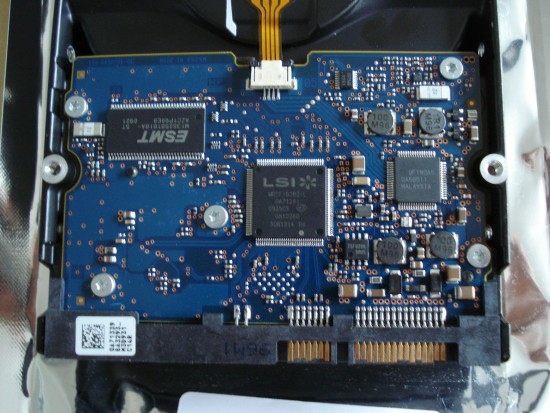

My PSU fried most of the parts in my server, I´ve recovered from that only to find that one of the harddrives have also been fried (Completely dead).
I have tried with another PCB (Not exactly the same MLC & FW as the broken drive) and the the drive spins up but is not recognized in BIOS. I think that only the PCB board is damaged, I cannot smell or see any burnt circuits. I do have a multimeter but I do not know enough about electronics to try and find the issue myself.
Maybe someone can help me?
Here are the details of the drive:
Hitachi Deskstar (7K2000)?
HDS722020ALA330
P/N: 0F10311
MLC: JPK20N
FW: 20N
Manufactured SEP-2009
What information is necessary to find a suitable replacement PCB? Do I need to move the FW circuit over to the new PCB on a Hitachi?
Are there any companies doing just PCB replacement so I can recover my data myself? I have googled and checked ebay for a suitable PCB board but to no avail, does anyone know any better place to look?

I´ve read a bit more and it seems that it might be the TVS being faulty, where is it located and what measurements should I be reading on the multimeter?
 Post subject: Re: Fried Hitachi 2TB drive
PostPosted: July 18th, 2010, 4:23
Posts: 17261
The 8-pin component marked 25FU206 near the SATA power connector is the serial EEPROM.
LE25FU206, Sanyo, 2Mbit, 256Kx8, serial flash memory:
http://www.sanyocomponentsdirect.com/co ... U206TT.pdf
Here is the relevant area of your PCB:
http://www.users.on.net/~fzabkar/HDD/HD ... EEPROM.jpg
I would set your DMM on the 200 ohms scale and measure the resistances of the components in the white boxes. I can't see for certain, but they appear to be TVS diodes and fusible resistors. If the damage was contained by the diodes, then an easy DIY fix will be possible.

I measured the Fuse next to the 5V TVS, and it seems to have been triggered as it doesnt give a reading. The fuse next to the 12v TVS is OK (shows 0.03).
Should I measure the TVS diodes with 200 Ohm setting? I do have another setting showing a diode on the multimeter. Should I measure in both directions?

Well ,
Thats the Two Black Things Near the SATa Power connector One is for 12 volts protection and the other for 5 volts .
