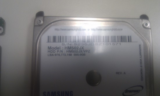

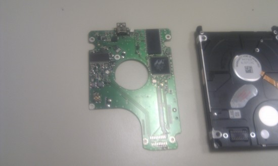

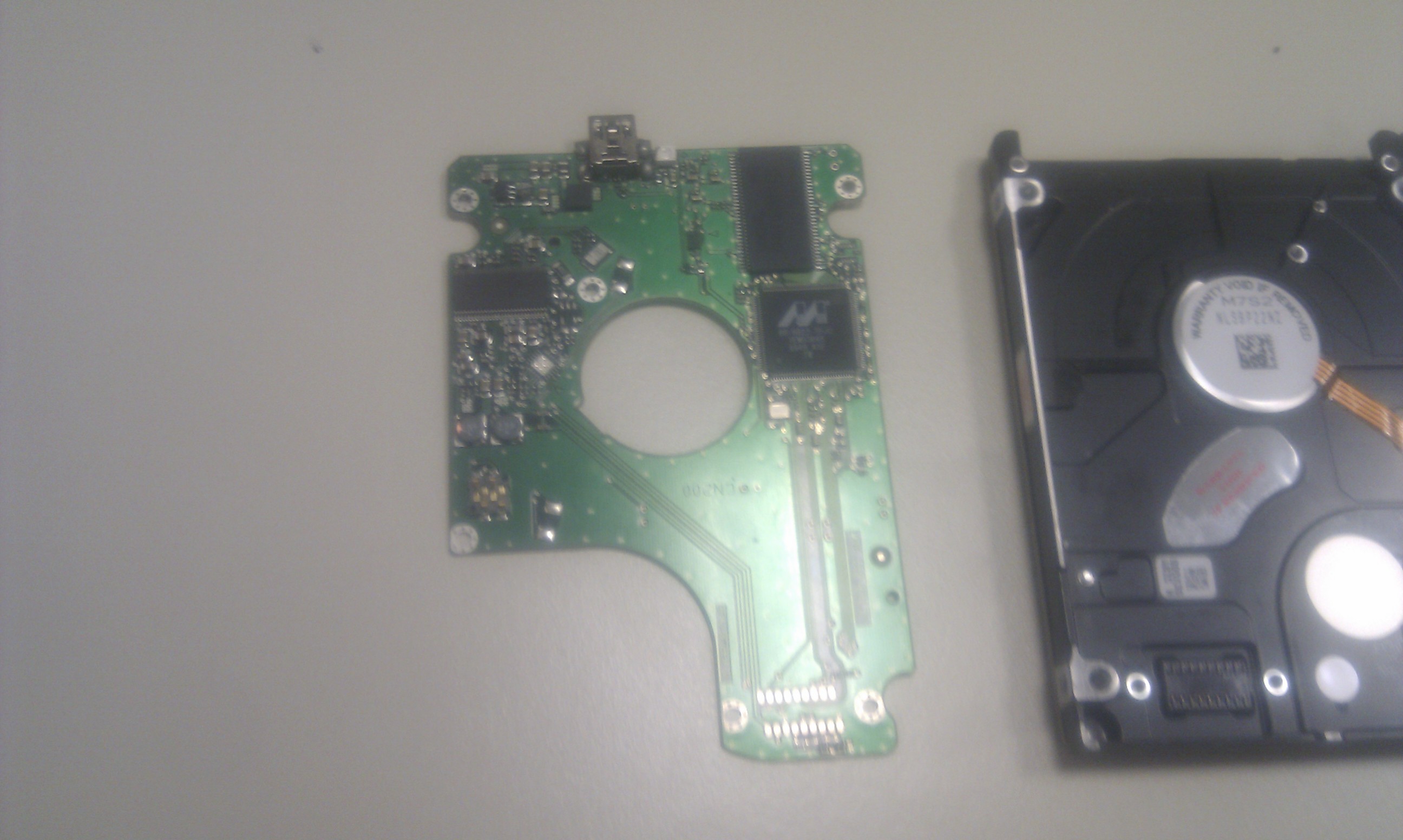

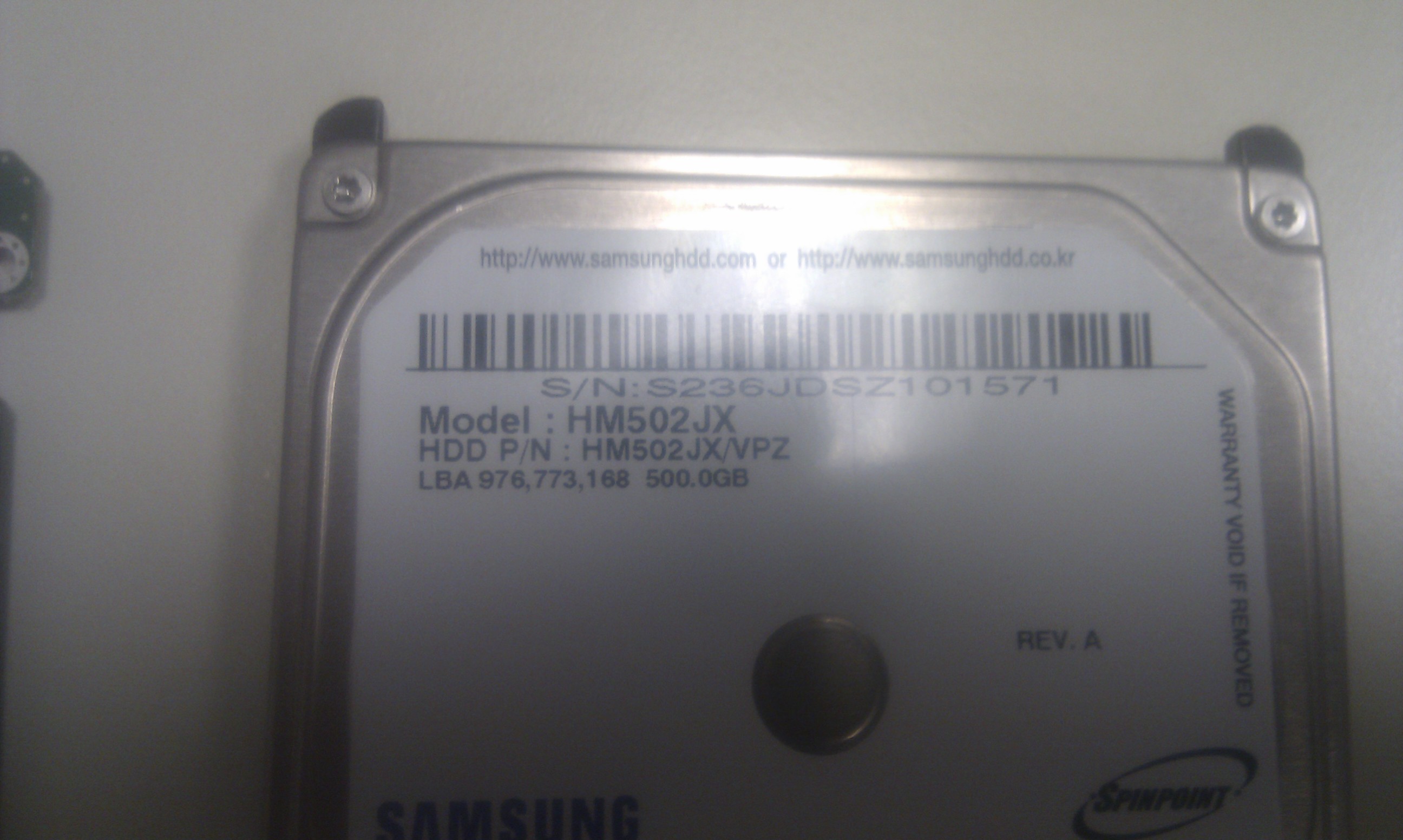

Dear friends,
I have a big problem and I suppose that you can help me. I have a portable Samsung 500GB HDD and probably PCB's defectived. I have to access my HDD to recover my data and because of that I bought a new HDD to change PCB and access to my old HDD. But it's didn't work :( . Please give a some advice to me about how can access my old data drive and get my datas!
HDD model : HM502JX
HDD P/N : HM502JX/VPZ
Capacity : 500GB
PCB : BF41-00288A 01
Many Thanks.

PCB ROM Transfer.
There are companies available which can do it for you.

Dear Loki, Sorry, You are right.
Fault : USB port broken, I repaired and tested, not worked! Get a new HDD, take off PCB and tried, didn't worked!
Spin : Yes, drive spin with original PCB
Sound : There is no sound, just flip-flop light of old and also new PCB!
Port Solder : I repaired old one, also I have new one.
BIOS : Not recognised by Bios, not on Windows, I didn't tried with third party Disk management programs!
Thanks for support again.

The square chip that has the big M (marvel) on it has embedded rom info that is unique to the drive.
This would require specialist harware to copy over to the donor pbc - not DIY
A quick search on this forum showed you might be able to remove two pairs of capacitors & connect the Rx & Tx to a SATA connection on the original pbc.
samsung-hm502jx-usb-only-t15310.html
If you decide to opt to try a DIY fix then you accept the responseablity if it goes wrong.
Loki
