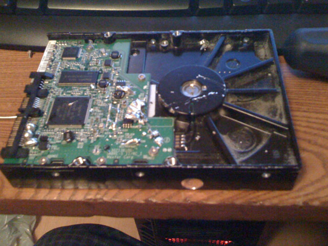

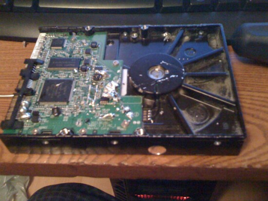

After literally hours of training...... little johnny became quite an expert in spotting PCB's that 'looked' damaged.
Thats one way to keep your Son occupied. :D :D hahaha
