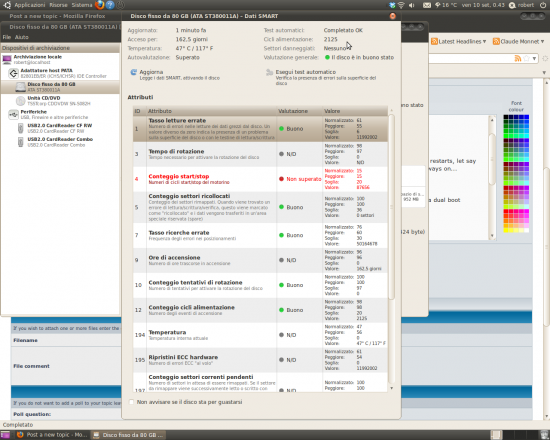

I have a strange issue on an Aspire 1710 notebook with its internal 3,5" ST380011A drive
First of all please note that the drive looks healthy, except but the issue I'll go to expose.
Drive motor continues to stop and quite immediatly restart, I've not been able to measure the time between cycles, let say that they happen while the notebook is not used... but since I started writing this thread is has been always on...
SMART start/stop count reports 87655 starts/stops :shock: against 2125 power on (see attached screenshot)
The rest of the SMART values are green or grayed.
I first supposed it could be something failing with XP energy saving, but in the last period I've made it a dual boot notebook with ubuntu and also in ubuntu, the drive acts the same.

try to backup your data
seems the drive is having problems with the spin up motor :o
send the drive for replacement
