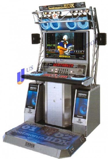

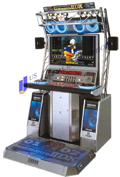

Hi..
Is this the kit you have?
If so forget the part where i said you need to send it with the hard drive. You going to need a tech to come to you :) If i were near you i would offer help just out of curiosities sake.
You got that in your bedroom? :D
