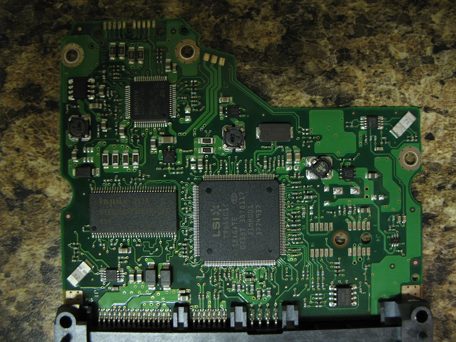

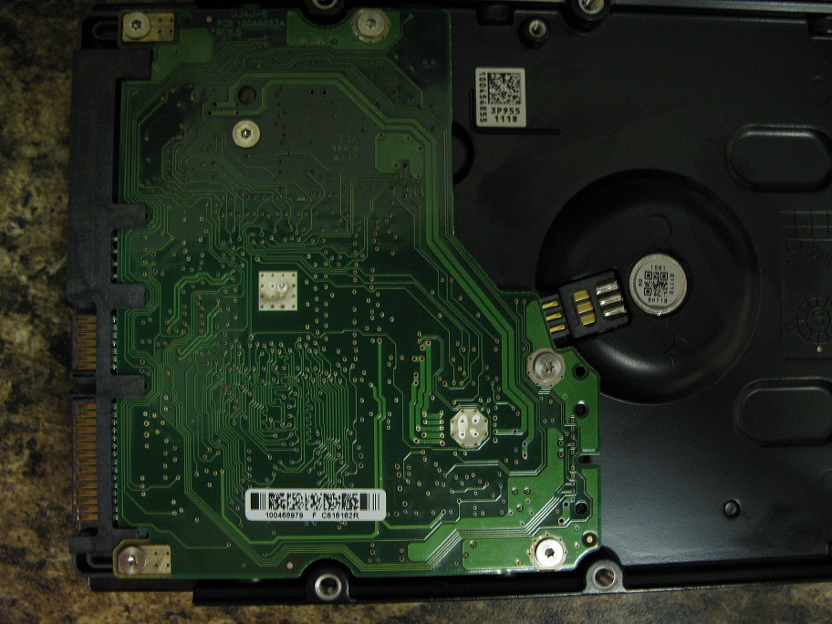

here are two pics of the pcb, the back pads for the SMOOTH chip and the other look discolored a bit, maybe burnt?

PCB looks fine. To confirm, if the drive is clicking, it's highly probable that it's a head failure. There is one model of 7200.11 that clicks as a result of a system area failure. Perhaps you can post the full drive model...e.g. ST31000xxxxxxx
