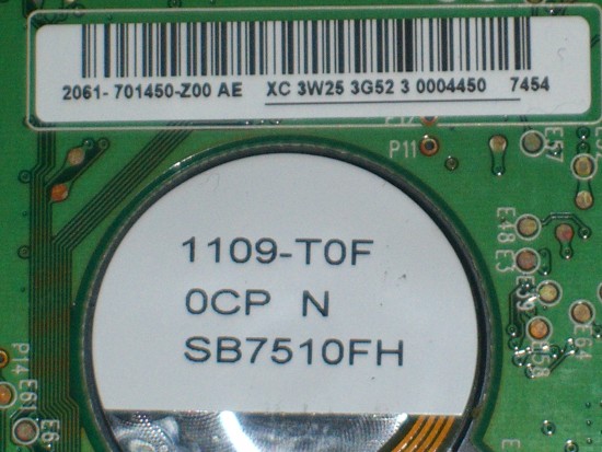

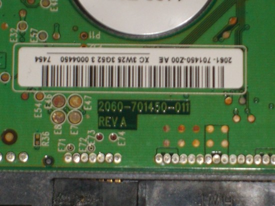

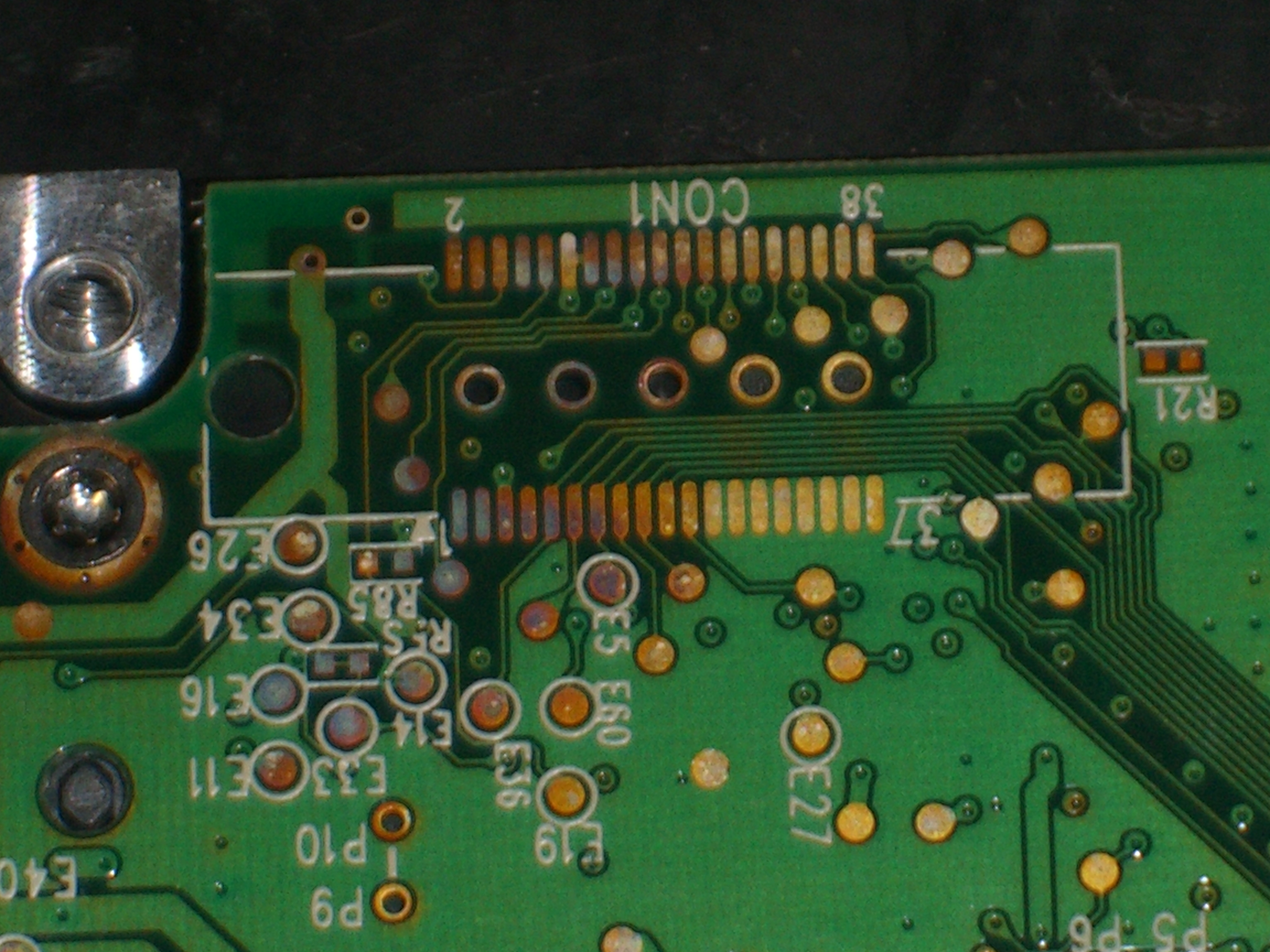

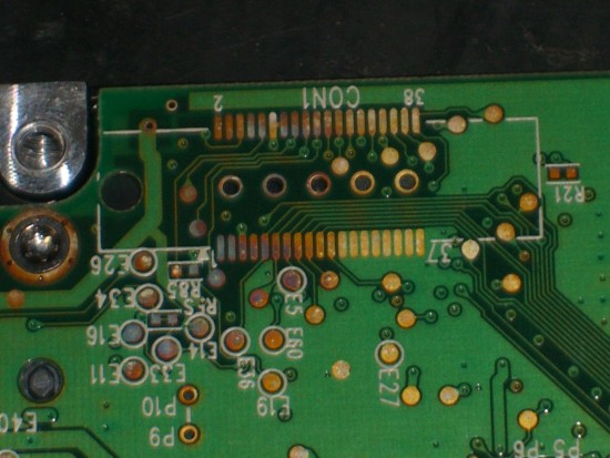

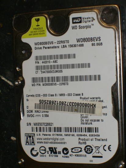

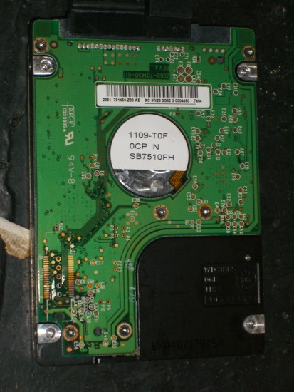

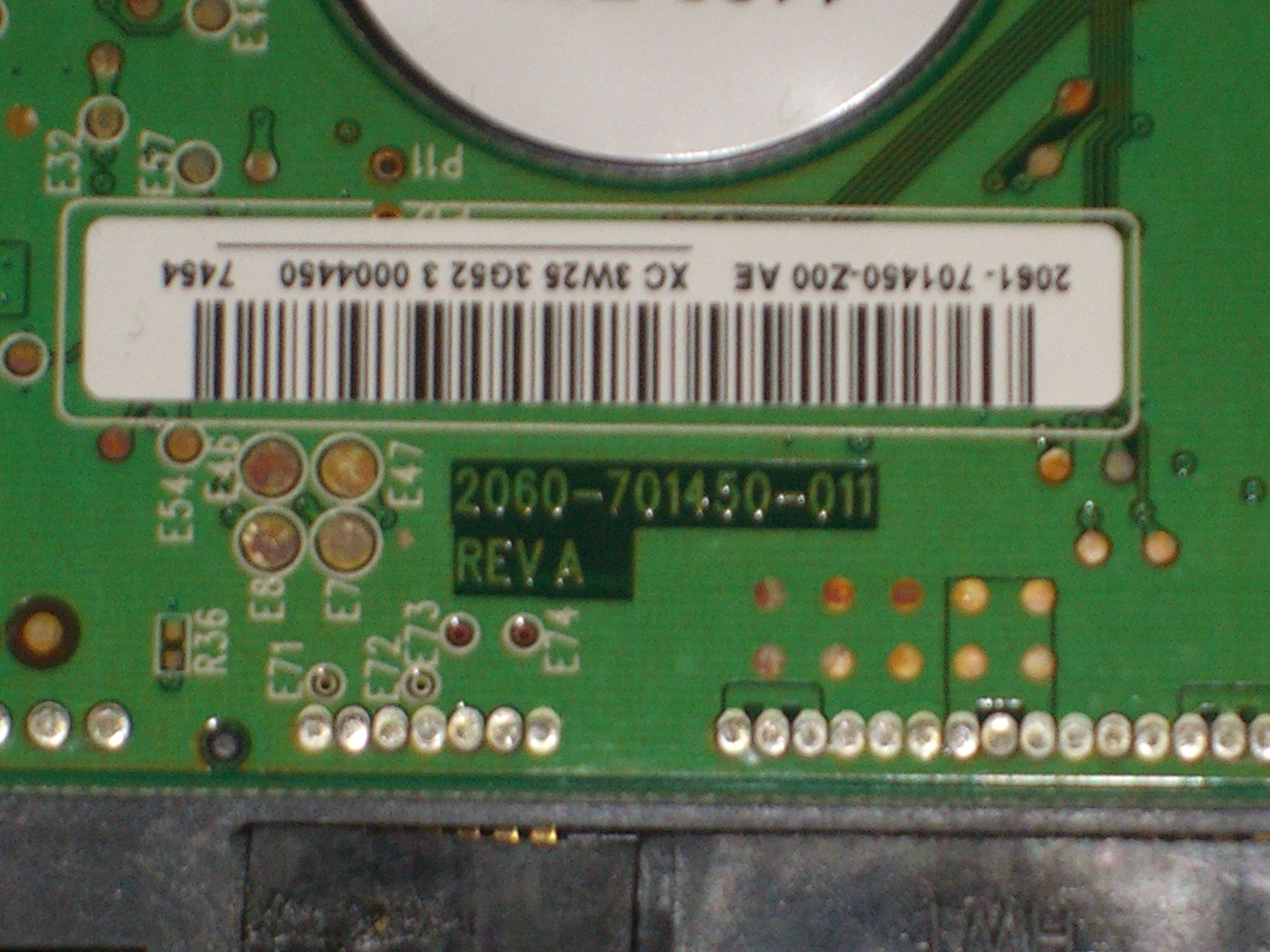

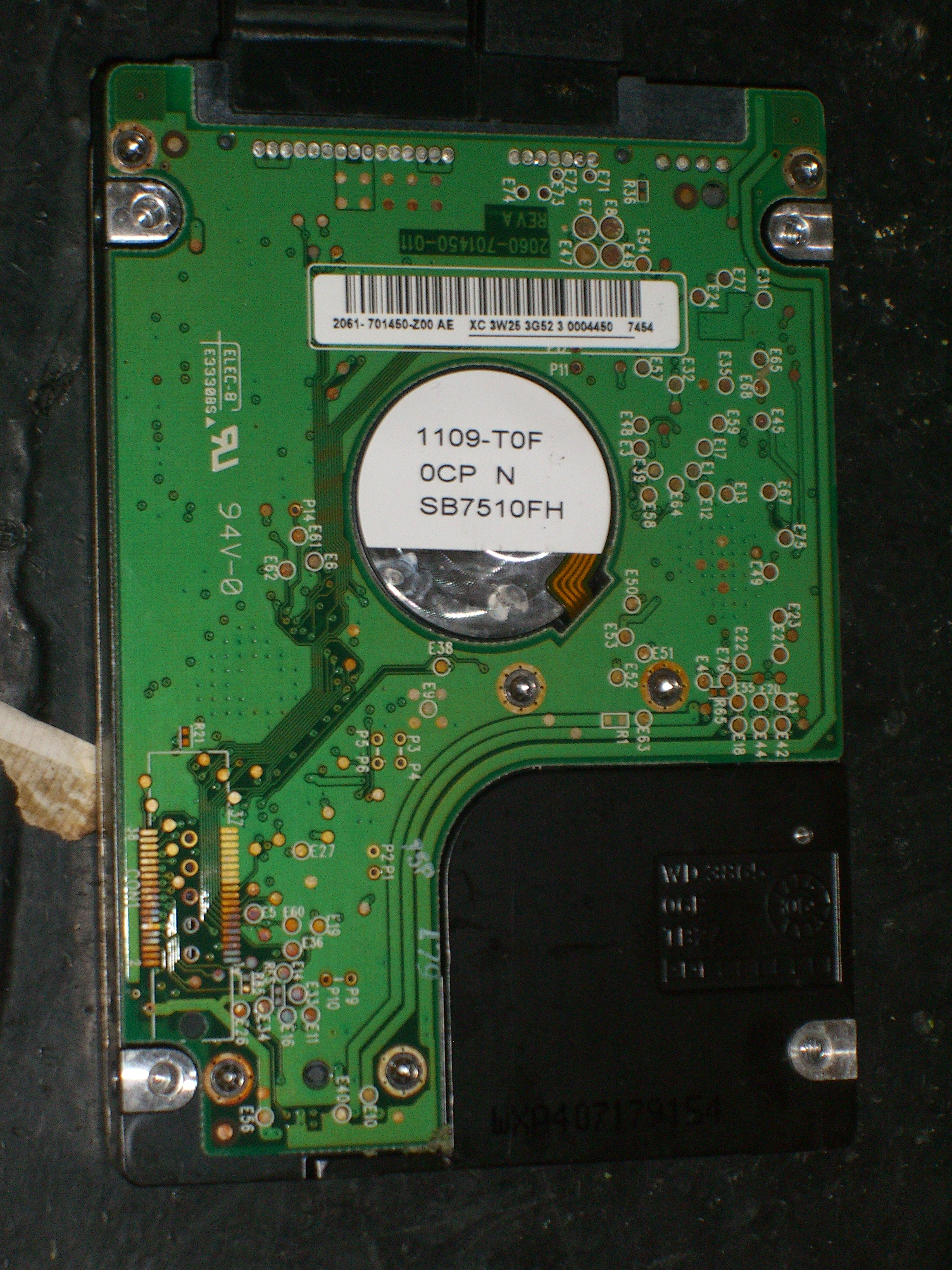

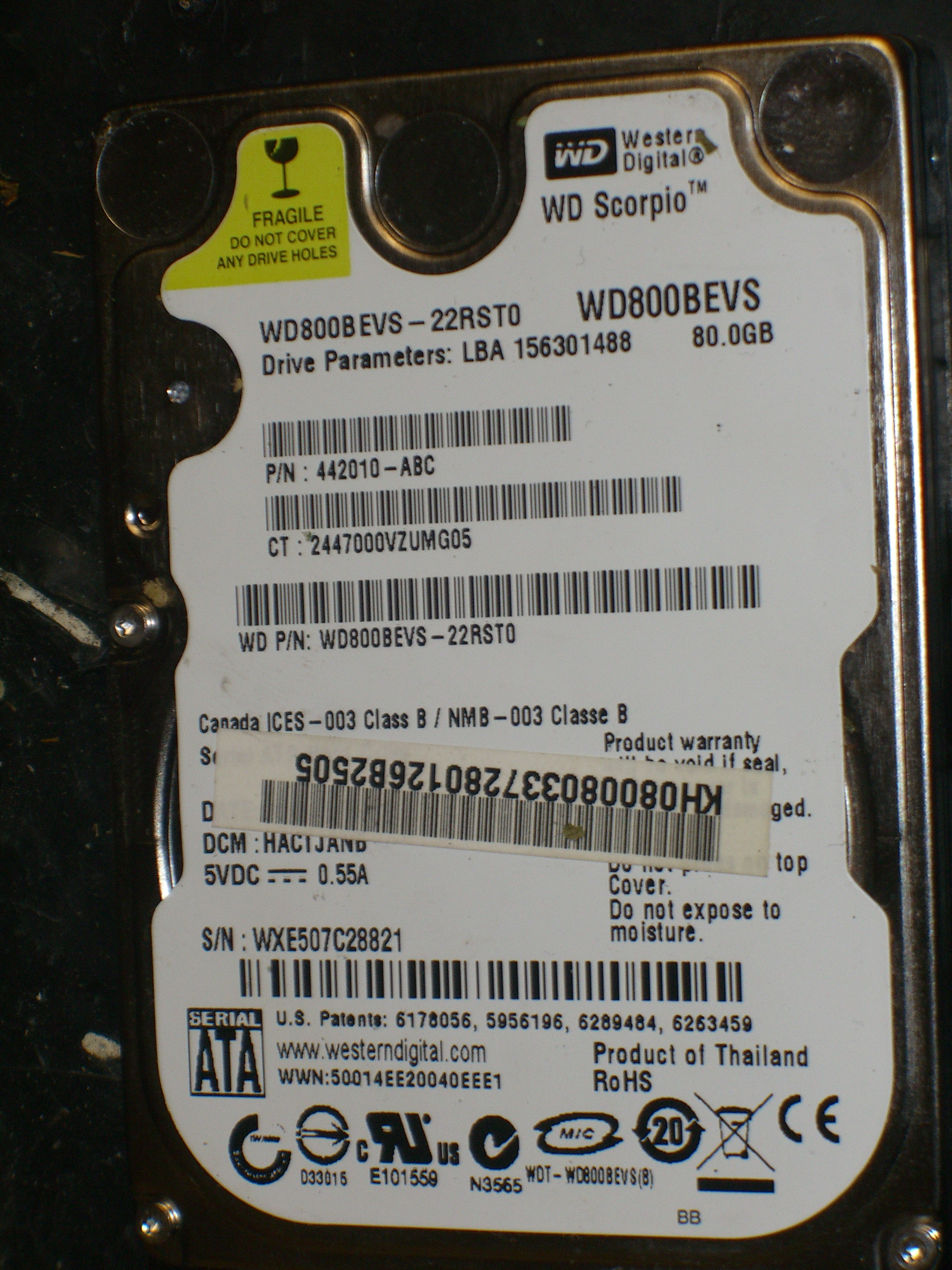

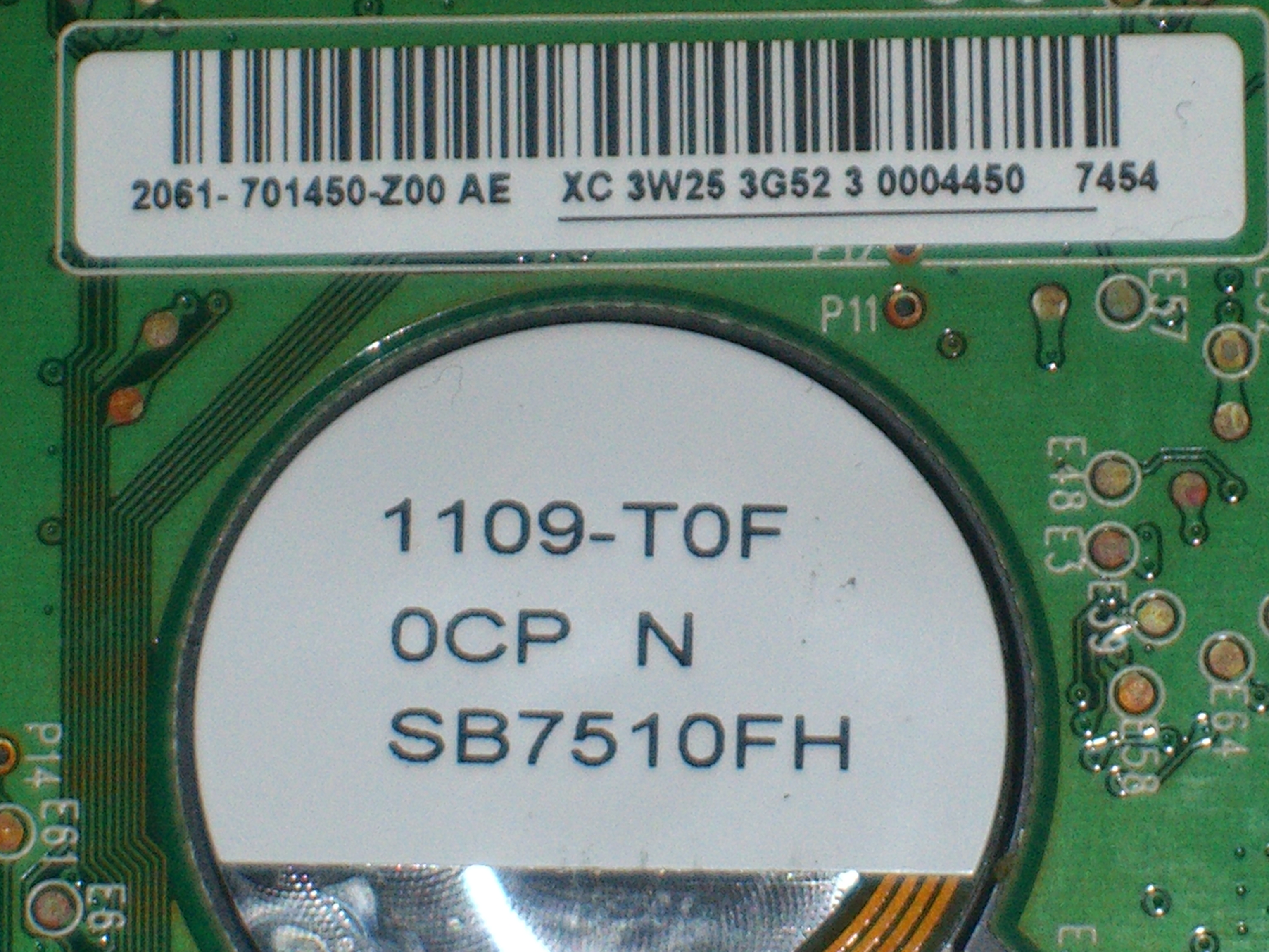

Tried the freezer thing and lightly banging it. I don't want to hit it too hard. Neither worked. Put it in a drawer for a couple months and decided to have another go at it. While I was looking at it this time I noticed what looks to be burn marks on the PCB board. Is that normal for a HDD over time or does it look like something is actually fried?? Would a swap of the PCB possibly let me get this spinning again? I included photos and a link to a youtube video where I recorded the actual behavior of the drive. Any recommendations on how I may be able to get my data off here. Its somewhat important but not $1500 important. I want to use this for practice as I also have a WD3200 that fell and has the same problem (click but no spin) and the same PCB burn marks. Now the data on the 3200 Is quite important.

Broken heads, and maybe bad surface beside that also.
Sorry to say that you can do nothing with this issue.
Yes it's normal.
Unfortunately, no.

I think the drive spins... The clicks i heard on the video sound like ur standart timeout and back to parking routine. Its like this If you are right and a 2.5 drive is not spining after the fall - most likely cause is the head sticktion. Ammount of damage suffered while the heads griped the platter and the ammount of damage during the dismount will determine if the heads are still usable. I had a lot of drive come with sticktion and id release em with no need for head swaps after. Image and done.
But for what its worth - you tube vid does not sound like it.
Head swap / media damage jobs in ontario will cost ( depending on the shop ) from 1k and up. IMHO 1500 CAD is average price.
