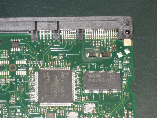

Here's a pic. Both of my PCB's are pretty much the same... my laptop sucks and problems uploading photo's today so hope this one pic works.
I removed the burnt chip closest to the power input. (I dont' think the burnt part was the TVS?)

The two smaller components are/were inductors (or low ohm resistors?).
The 5V and 12V TVS diodes are the two larger, horizontally oriented components, each with a stripe adjacent to a "V" on the PCB.
You need to remove the 12V diode, and replace the two inductors with wire links. Alternatively, you may be able to jumper pins 13, 14, and 15 of the SATA power connector to the pad at the striped end of the diode (after removing or replacing the diode). I'd like to confirm certain resistance readings before you do this, though.
If there is no other damage, the drive will work without the diode, but there will no longer be any overvoltage protection on the +12V supply. Be sure your PSU is OK.
If, for continued protection, you wish to replace the diode, you can obtain an SMBJ12A from Farnell, Mouser, Digikey.

I got one drive working!
Unfortunatly I dropped a piece of solder on the other board and now need a solder sucker so I don't make a mess.
I did get my data off the drive though so thanks for all the help!
