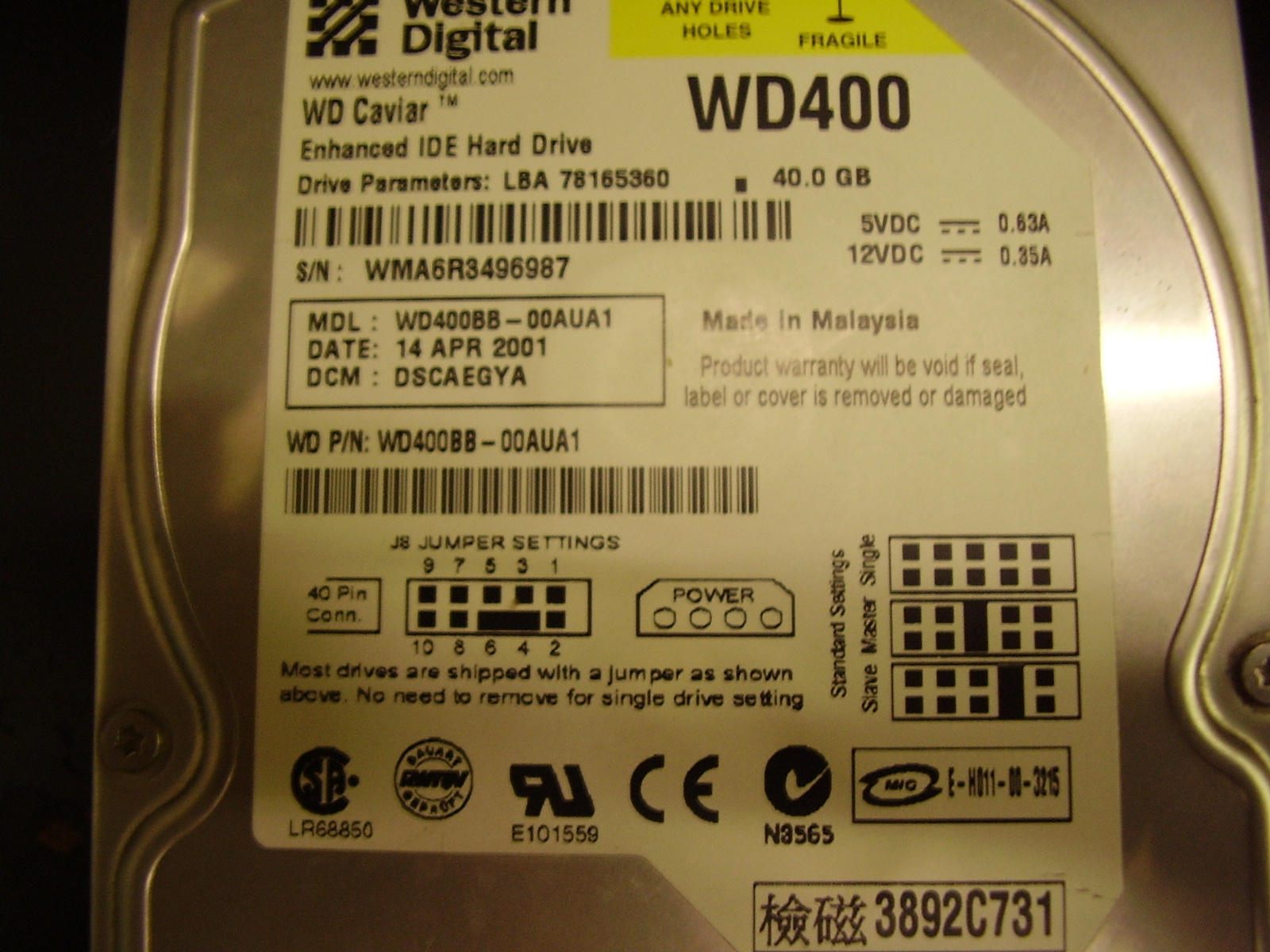

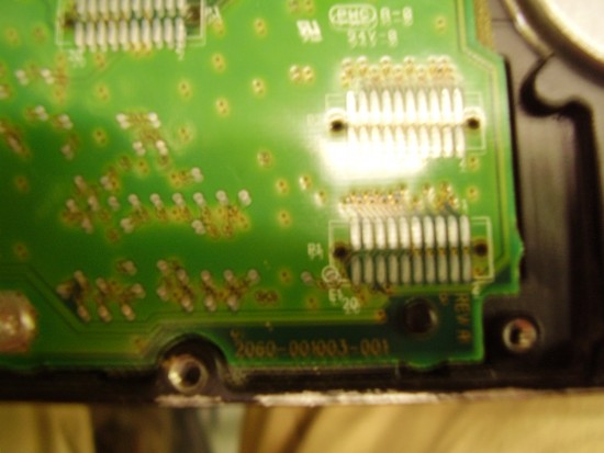

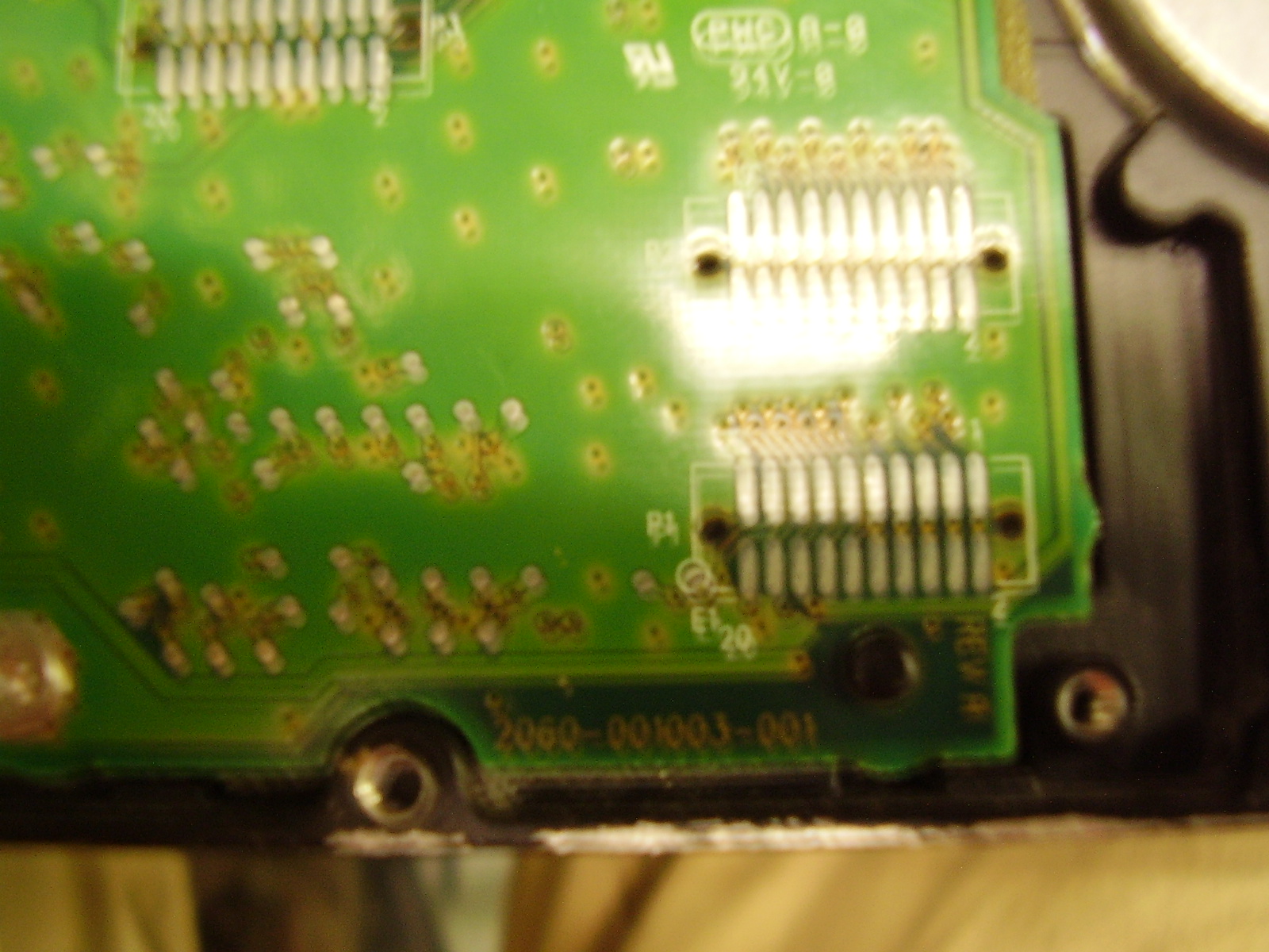

Thanks much for your comments. I am going to try to find a comparable PCB and replace it. Hopefully I get a matching one and it works. Also hope this is not heat seizure problem as ppumpkin sais. Question. I heard that I might have to resolder the eeprom from mine onto the new PCD. Is this correct?.
 Post subject: Re: WD400BB won't spinup
PostPosted: August 17th, 2010, 9:56
Posts: 775
Location: Toronto
Nex, ur PCB photo is bad =) 1st u need to unscrew it and put a nice picture with components visible to us.
And yes u will have to take the eeprom from ur patient board and put it on donor board. However , i remember some members of this forum saying that with this particular model , if u can aquire a drive with exactly same model , u wont need to swap the eeproms.

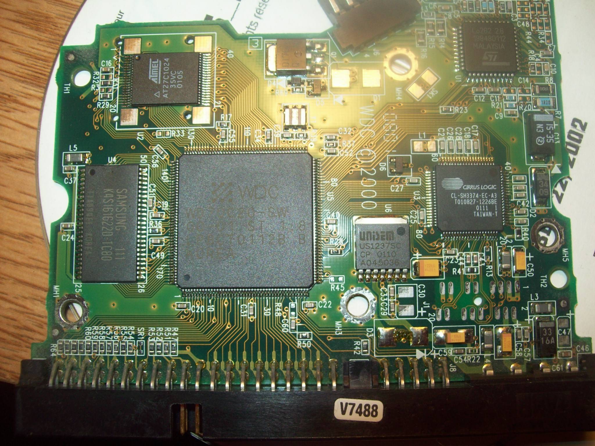

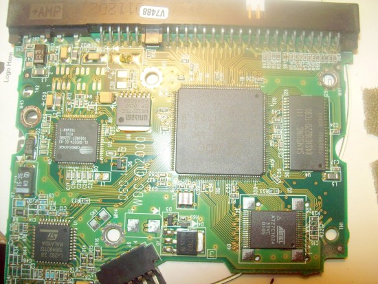

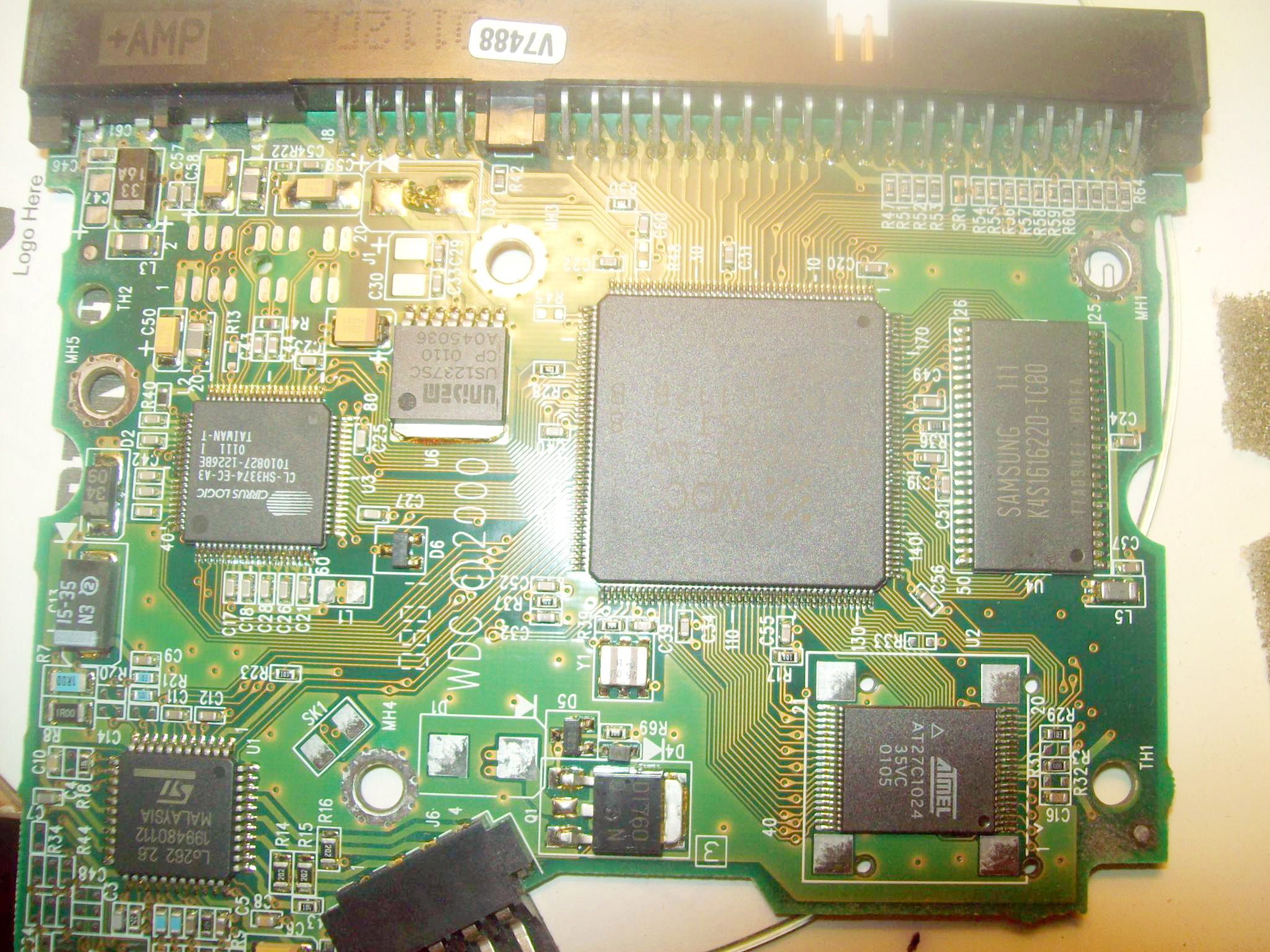

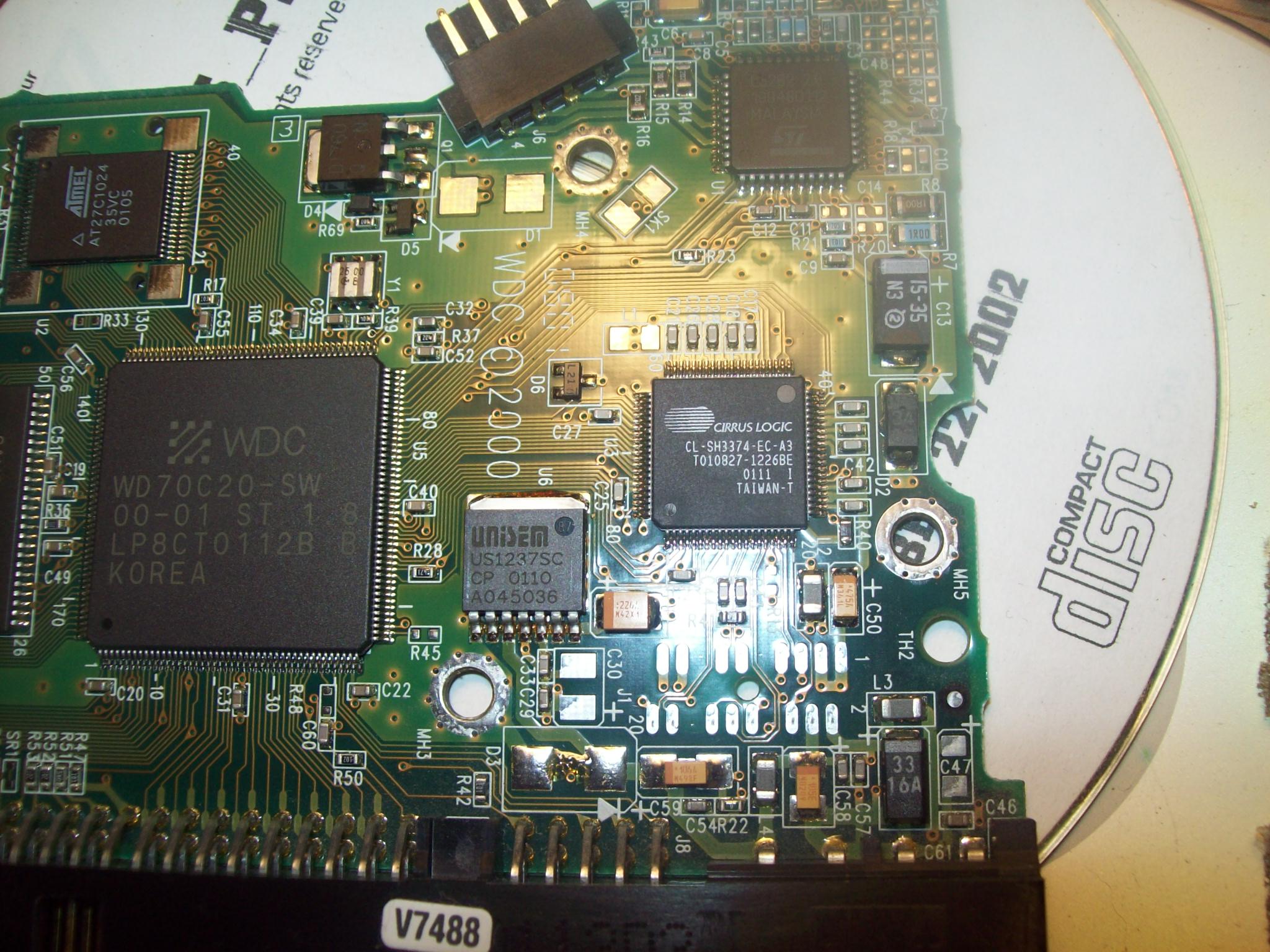

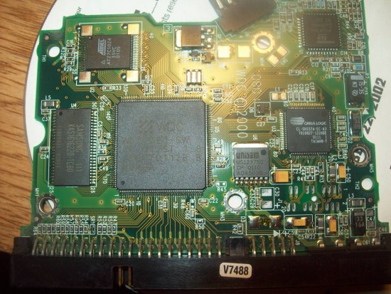

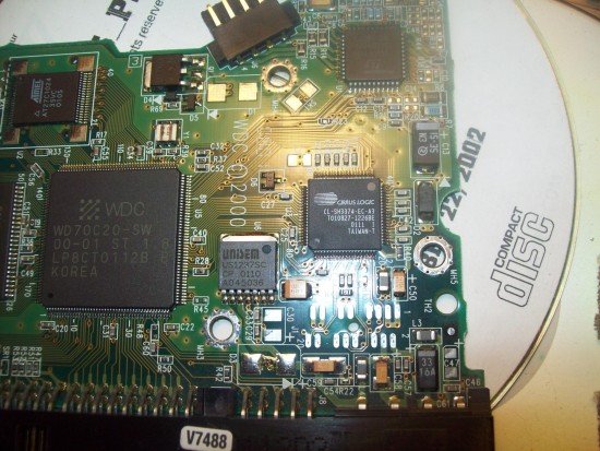

Here are pix of PCB.
PostPosted: August 19th, 2010, 1:18
Posts: 2984
neximile wrote:
@hddguy
So can I request a specific Rom version. Or do I have to trust to luck?
To buy a pcb you will need to be lucky. You could get specific rom version from members of this forum, but will be no use without proper tools to write to your pcb.

Nex, get a donor PCB with exactly same model number. Preferably close date as well. And just swap the PCB. If the drive works - grats. If all u hear is the drive spining up and the heads clicking - meens u need to take the ROM from ur original PCB and put it on ur donor board. If u are not comfortable with it - find a tech shop. It takes a minute to swap it , so ima sure for like 25-50$ some bored techi is going to do it =)
PostPosted: August 20th, 2010, 9:48
Posts: 2984
The ROM chip is not standard 8 leg chip, and will definately be more difficult for the OP to attempt. If replacement PCB does not work, he should seriously consider getting it done professionally.
PostPosted: August 20th, 2010, 10:07
Posts: 775
Location: Toronto
I should have looked closer at the PCB on the picture =( Hddguy is right.
