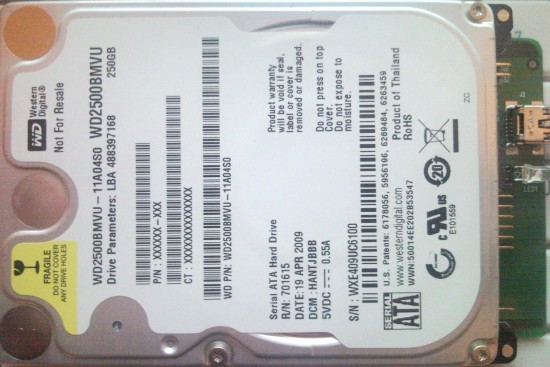

Hi
I have a WD WD2500BMVU 250GB 2.5" with integrated USB interface on the hard disk PCB. There is no regular SATA interface only USB interface on the hard disk PCB.
You can see the photo here in this thread
http://groups.google.com/group/datareco ... 69d82d6f6b
Is there any known SATA converter/interface for this kind of WD hard disks?
Cheers
-Jag

upload a back PCB photo ...

 Post subject: Re: WD 2.5" 250GB SATA - No SATA Interface on the HDD PCB
PostPosted: December 26th, 2009, 5:00
Posts: 1726
you can convert your drive's PCB with (USB interface) with another PCB (SATA interface) if you have the skills to do this.
or you can seek for a pro to do this for you.

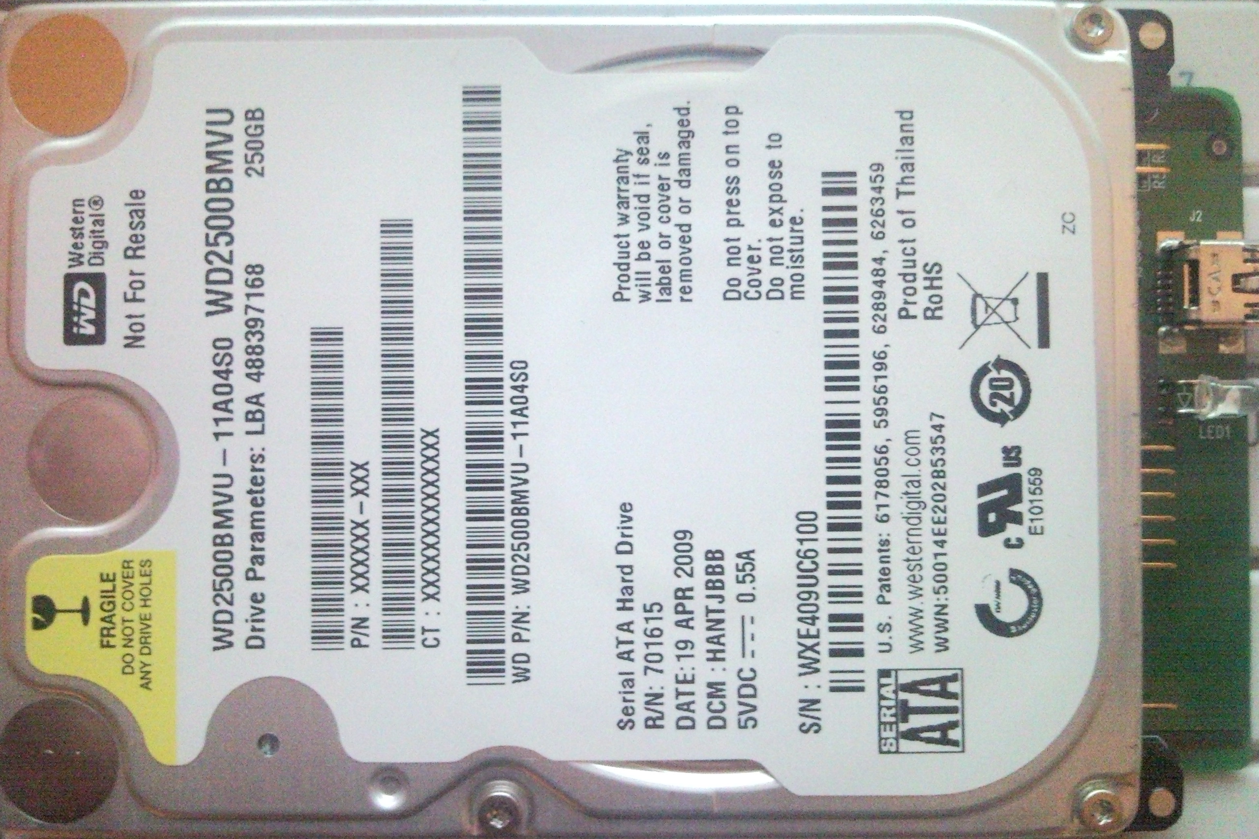

Photo here

you know what PCBA is?
where is the PHOTO , how you ask for help and you don't listen .

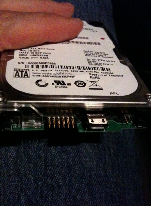

PostPosted: September 26th, 2010, 15:36
Joined: September 26th, 2010, 15:31
Location: hamburg
Hi, i have the same request... (if the HDD is connected via USB no recognition takes place although the drive sounds are pretty nromal....) Does anyone have an idea, what the pins (see the photo above) are for...? I.e.: Is there anyone suggesting to connect these pins to....?
Is there a pro around ?
BR, Alex

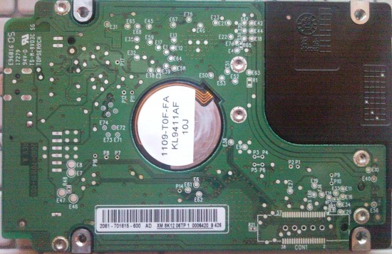

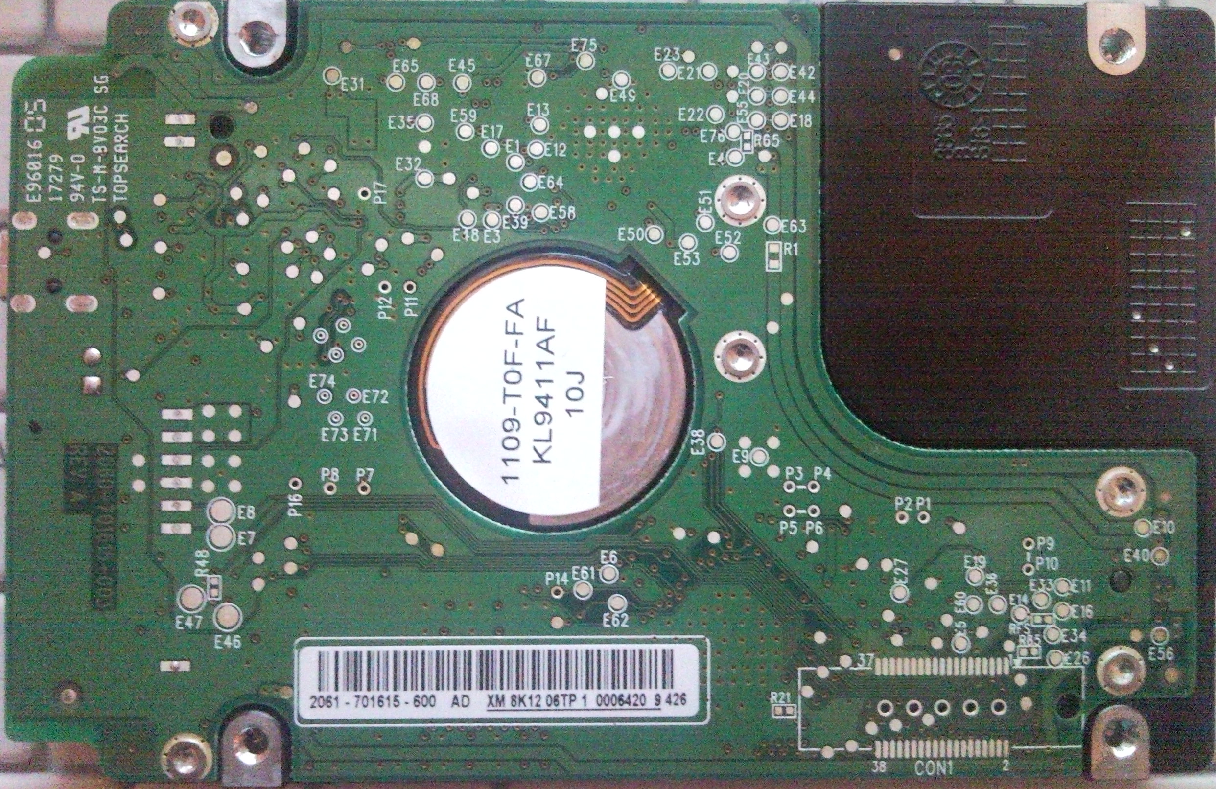

PostPosted: September 26th, 2010, 18:18
Posts: 17217
Can you upload detailed photos of both sides of the PCB? AIUI, there is no SATA access available via the header, but you can tap into the SATA signals on the PCB. Whether this will help you at all is another matter entirely.
If you are using Windows, can you see the USB-SATA bridge chip with Microsoft's UVCView utility?
http://www.users.on.net/~fzabkar/USB_ID ... ew.x86.exe

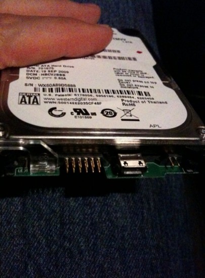

i did not unmount PCB ..therefore i can provide only these pics
Answer: Nope: No change... The reaction (tested at several Windows versions (and 1 Linux) was the same like attaching a usb-led-light: Power is consumed, but no "intelligent" reaction
PostPosted: September 26th, 2010, 19:51
Posts: 17217
That doesn't help me much at all. :-(
However, the easiest thing to do is to hook up the USB cable to the drive. Then, with the other end of the cable disconnected from the computer, measure the resistance between each pin at the PC end and the corresponding pin on the component side of the drive's PCB.
If you have no continuity at either the Data+ or Data- pins, then this will explain the non-detection, in which case a simple soldering touch-up may get you going again.
If the above is OK, then your next step would be to determine whether the USB-SATA bridge chip is alive or brain dead. How you go about this will depend on a detailed photo of the component side.
