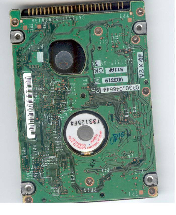

 Post subject: Re: Fujitso MHR2040AT Rom Required
PostPosted: October 4th, 2010, 13:21
Joined: July 12th, 2010, 4:38
Posts: 1455
Hi Again
Can anyonme tell how to put this drive into safe mode?
Thanks.
ACELab partner

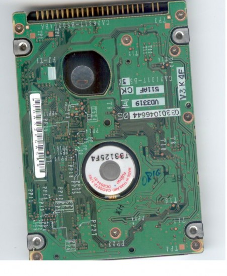

PostPosted: October 4th, 2010, 18:17
Posts: 922
This is for 2040MHT. Should be similar
PostPosted: October 6th, 2010, 4:22
Posts: 1455
This is my disk.
No the same model...
