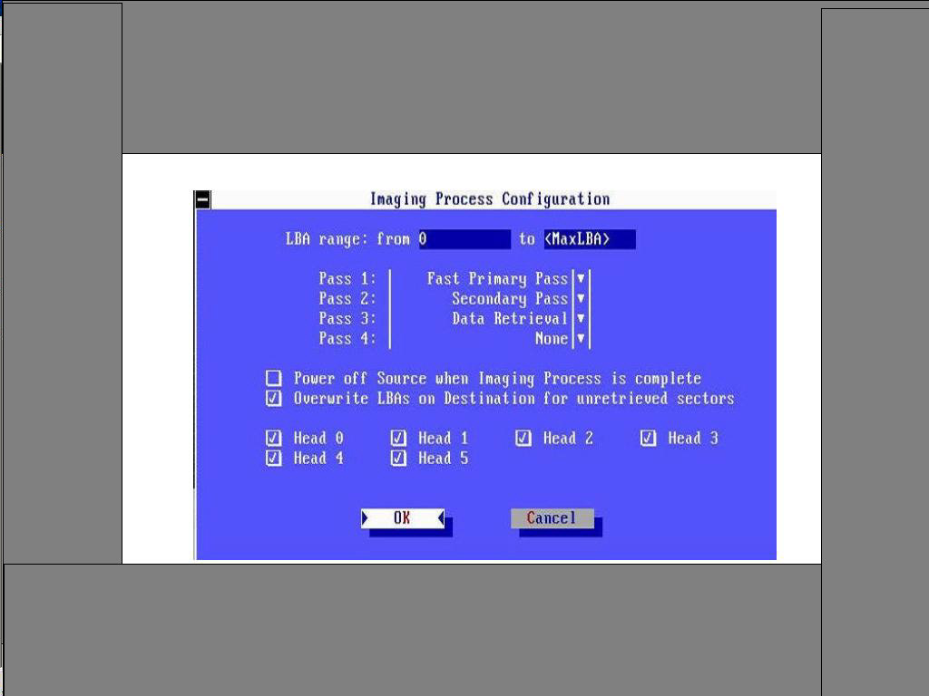

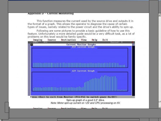

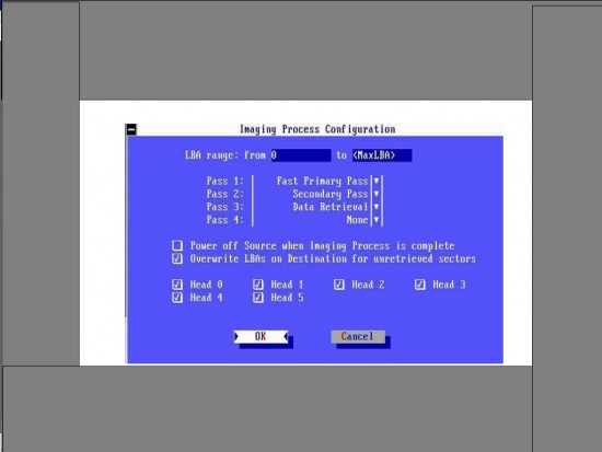

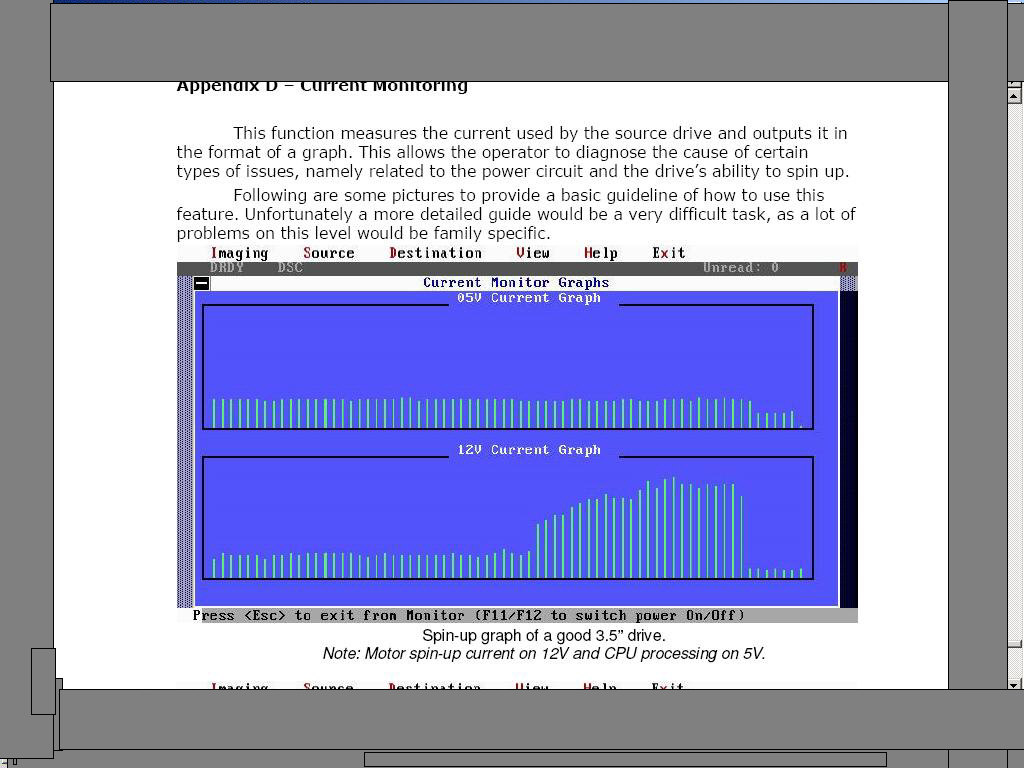

I Think these pictures will speak for themselves. Current monitoring is supported while you can certainly create Headmap & choose Heads .
It seems DRC & BlackST both doesnot own Deepspar. Any deepspar sales person these are 2 customers.

Did they actually show you that they disabled the head and did an image? Can you untick the heads in the options?

To be more specific: Yes, Deepspar can ignore specific heads while imaging. It does not do anything to the drive to accomplish this, just generates a map of which LBA correspond to which heads and allows you to skip specific heads (the LBAs associated with them). If bad or failing heads are preventing the drive from working normally, this functionality is not going to help you.
No, Deepspar does not manipulate any current, even if it does (can) measure it.
I never said Deepspar doesn't let you image by heads.
