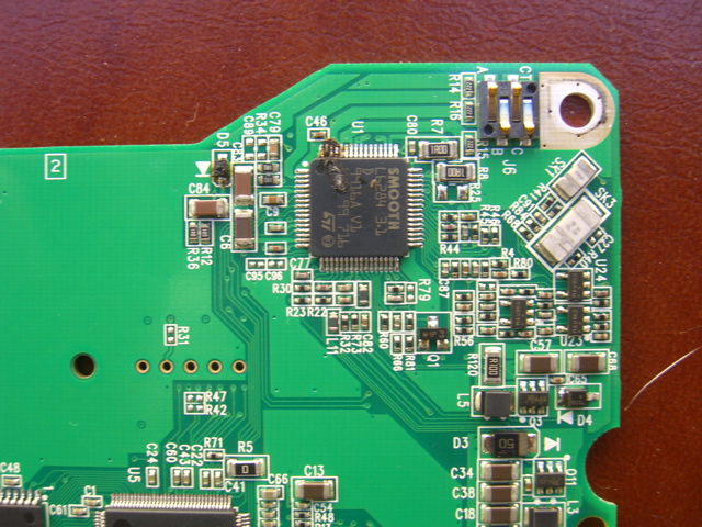

Hi, I have a similar situation. I have attempted a PCB swap to recover data from a WD7500AAKS. After the swap, the drive spins up but is incorrectly recognized as an un-initialized 2TB drive. In my case, the PCB is clearly physically damaged (see photo).
The original PCB is numbered 2061-701474-300 04P. The donor is numbered 2061-701474-300 AC.
DCM values on the two drives do not match exactly.
Is there a better PCB match out there that I should try? Other ideas?

 Post subject: Re: WD7500AAKS PCB Swap
PostPosted: October 23rd, 2010, 18:16
Posts: 17099
If this is your board ...
http://img.alibaba.com/photo/331078189/ ... ipping.jpg
... then the adaptive data are internal to the Marvell MCU. These data would need to be transferred to the donor.
There is a vacant location at U12 (below the MCU) which would normally be populated by an external serial EEPROM, but you are out of luck. :-(
you can try to repair it with good PCB. swap the chip which is burned on pics. second option is send entire drive to some one rebuild adapter and program into good PCB.
donor PCB match enough. no need to care about DCM or others think. you just need to transfer FW into good PCB. i can handle such case with reasonable price. please feel free to contact me by email or MSN. thanks.
Return original PCB to your disk, and send together to a professional DR firm. Without professional and seriously expensive tools you can not get this done yourself.
