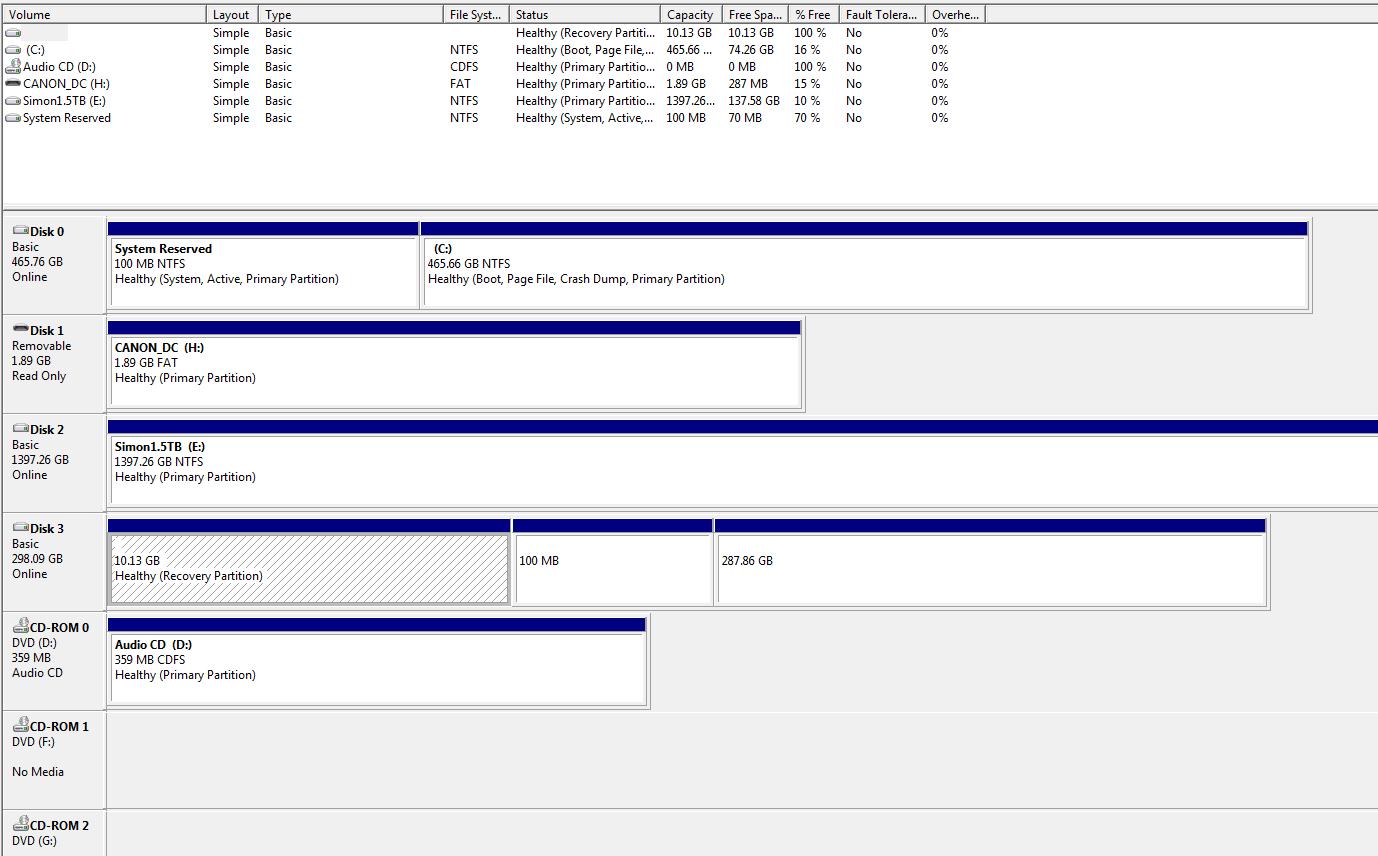

My girlfriend's laptop recently stopped working after being dropped from about 1.5 feet off the ground. It's been dropped numerous times before with no trouble, but this seems to have been the last straw. I quickly narrowed the problem down to the hard drive, but my limited knowledge of HD recovery has not helped me, so hopefully someone else can shed some light. I'll just detail everything I've done so far and the HD specs.

6. Attached USB enclosure to another computer running Windows 7. HD does not show up in Windows Explorer. In Disk Management, it does not show up as a lettered drive (in the top list of drives), but it does show up as a numbered drive (lower portion of screen - see attached screenshot, where suspect disk is Disk 3). In that lower portion of Disk Management, I see three partitions: a 10GB recovery partition (presumably Windows 7 as installed by Sony), a 100MB portion and a 287GB partition. Presumably the 100MB part is the normal system reserved part, and the 287 is the primary partition. However, these latter two do not show any details, and if I right click either and try Properties, I get a message "The operation failed to complete because the Disk Management console is not up to date." Refreshing freezes Disk Management.

File comment: Windows Disk Management utility. Problem disk is Disk 3.

Nope, it is not baloney, if you open the drive and atmospheric air enters drive internals, then platter will get contaminated and that is something you don't want to happen, assuming you care about the data.
So, don't do it.
After reading your very detailed description, i think your diagnosis of failed heads is 99% correct.
But one must accurately diagnose drive to tell for sure.
Having said that, i'm afraid there is nothing more you can do, but send drive to a pro, who will:
a) Diagnose the drive
b) Examine media for platter damage
c) Estimate recovery probability and cost
If i were you, i would stop all power supply to this drive and send it to a pro.
Forum member lcoughey is from your area and comes recommended.
Good luck.

I'm curious, does the fact that Windows' Disk Management can actually see the number and size of the partitions on the drive mean that the heads are still functioning at least somewhat? Or is that info not stored on the platters themselves, i.e. is it stored on a ROM or something like that?
Also, I've gotten estimates for professional data recovery ranging from $500-$1,500, and even the lower level there is way more than I'm willing to spend. If I was wanting to attempt a headstack swap from another drive, where is a good place to look for an identical drive from which to swap, and is it strictly necessary to have an identical drive?
The part number on this one is G8BC00055320, but when I search for that number I mostly find a lot of expired eBay auctions. Are there any other Western Digital drives that would have an identical headstack that could be swapped in, and if so, how do I find out which ones?
Also, I've seen some posts about connecting to drives via UART - do all drives have UART capability, and specifically does this one? How would I find out where to connect to it, and how much should I expect to be able to glean by doing this?

I don't mean to be rude, but it seems you have decided to take the DIY route. This means that the chances of you getting data off your drive are ... zero, no offense or anything.
Again, if you care about the data send it to a pro. If you can't afford the pro, store the drive somewhere safe until you can afford it. This is the only chance you have to get working data back.
Otherwise, I wish you good luck.
Your drive will have multiple heads. Just because one head is able to read sector zero, does mean that the heads and the surface are good.
No
If you are not willing to spend possibly less than $500 on a successful recovery, then why would you be willing to spend several hundred to not get your data back?
You need the exact model, DCM and date to be sure that you have a match. Of course, if your drive has only 3 of the 4 heads present, you may have to order multiple drives before you find one with a matching set of heads.
So, as has been said by others, send to a pro or trash the drive.
