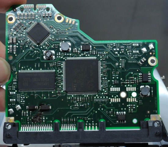

Anyone know if 7200.12 series has got flash rom on pcb?
the original pcb is burnt.

get ur self a donor pcb
2nd. as one of my close friends (seagate expert) told me once, Follow the White Rabbit..
you should find 2 identical chips in ur pcb, one of them is the ROM, need to find it ur self
and move it to donor PCB
good luck

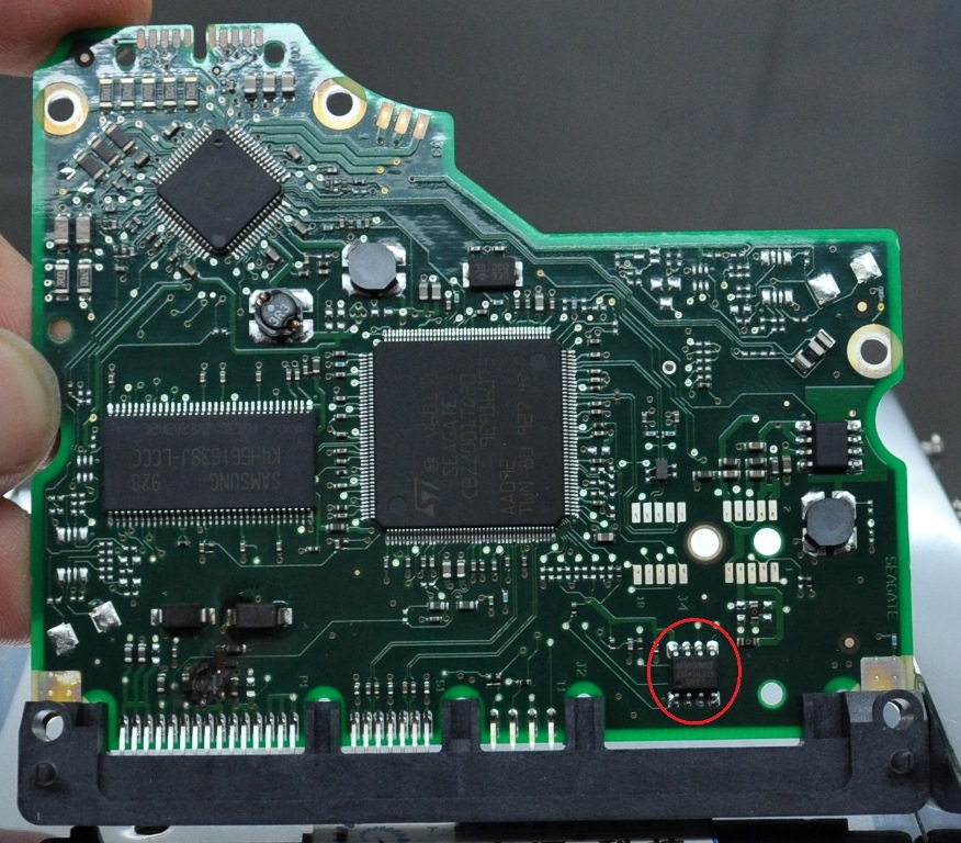

I would imagine that the chip I've circled is the one you need to swap. Perhaps someone else can confirm.

Yes that's the one....

just to confirm dont they normally start with 25?
Think I remember reading that here somewhere.
 Post subject: Re: flash rom to swap on 7200.12
PostPosted: June 1st, 2011, 9:47
Posts: 1038
Location: South Africa
Circled chip starts with 25, you can see if you zoom into the image.
