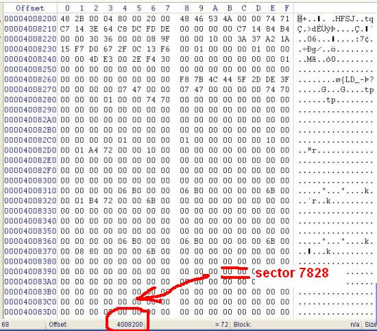

Hi Gurus,
I have 2 hdds here and I was told it was configured as RAID0 and used with Mac. Need to figure out the parameters, like disk order, block size, and offset. I am not familiar with the HFS header strcture. Any help would be highly appreciated. The following is the HFS header dump:
Thanks.

Looks like your stripe size is 1 sector and the drive with the HFS header is the first drive.
This printscreen sample not original :)
If this Raid from that Lacie Extreme (i think about) , so it's really has 1 sector block-size. :)

My calculator must be really broken then, i get sector 131137
