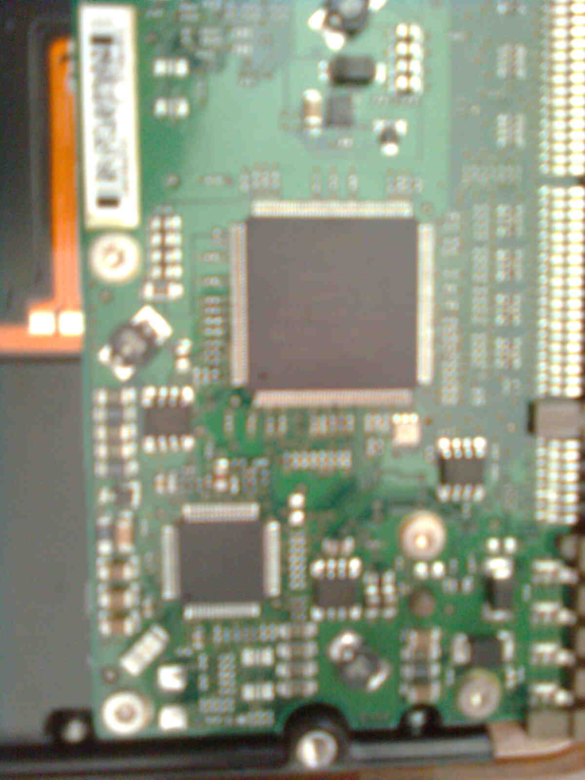

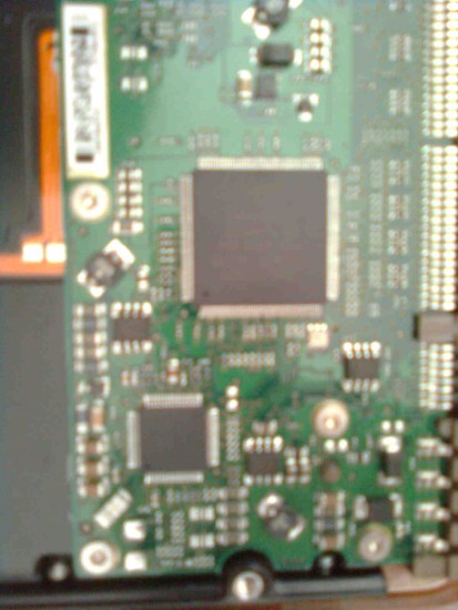

Hi
I accidentally plugged in the wrong power supply into my Maxtor 400gb External Hard drive - Stupid I know!!
Now there no power going to the enclosure or the drive - no green light or spin up
Try the hard drive in a new enclosure - still no joy
The Hard drive is a Seagate 400 gb Barracuda 7200.10
Model: ST3400620a
F/w: 3.AAE
I guessing that there is damage to the PCB but I personally cant see any damage
Any help greatly appreciated on identifying damaged parts - I havent yet removed the board just inspected the components on the board as it is.
I read somewhere that the TVS diode may have taken the hit but I dont know where it is or how to identify it damaged
thanks in advance
mg3np1
Sorry if this is posted in the wrong place

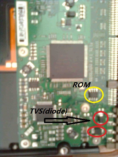

hi,
here you go the reference pic. help it can help you. if you can't repair it you can change PCB and replace ROM chip original PCB to good PCB. i have such PCB in stock. please feel free to contact me if need.

 Post subject: Re: Help! Plugged the wrong power supply into Maxtor Basics 400g
PostPosted: October 25th, 2010, 23:15
Posts: 17234
The most common result of an overvoltage with the wrong adapter is a shorted 12V TVS diode. That's the bigger of the two diodes. In most cases you can recover the drive by snipping this diode. Just be careful not to overvolt your drive a second time, as you will no longer have any protection. You can replace the diode with an SMBJ12A from Farnell, Mouser, Digikey.

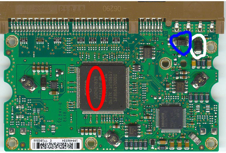

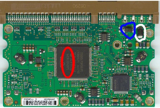

Hi Thanks for replies!
I have further question is the 12V TVS the black component (circled white) parallel to the screw hole in directly above the Power connector
and the 5V TVS is at right angles to it? (circled blue)
Sorry its difficult to read the ratings on my components
To test these diodes components - I remove the PCB flip it over and use the solder points for the TVSs as contacts for the multimeter probes
Is there any ribbon type connection I need to be aware whilst removing the board, or does it simply just unscrew - on that note what screwdriver do I need?
Sorry for the elementary question(s) I just trying to be clear :)
PostPosted: October 27th, 2010, 17:58
Posts: 17234
You have correctly identified both diodes. Farnell's SMBJ12A is the correct replacement for the 12V diode. However, the SMBJ5V0A is a slightly larger part than the original. This is because the SMBJ series is rated at 600W, whereas the SMAJ series is 400W. If the SMBJ fits, then use it.
You don't need to remove the board. Measure the resistances on the component side where the diodes are soldered to the PCB. In any case they are surface mounted components (smt or smd), not leaded, thru-hole parts.
PostPosted: December 27th, 2010, 18:43
Joined: October 25th, 2010, 11:24
Posts: 5
Thanks for all your help....HDD now fully operational it was a blown 12V TVS (open) diode as suggested ...
