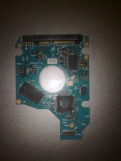

Hello :D i have a hard disk 2.5'' Toshiba MK22552GSX with lock password, is anything i can do except for replacing the pcb ???

 Post subject: Re: HDD Lock Firmware With Password
PostPosted: November 2nd, 2010, 18:37
Joined: July 12th, 2010, 4:38
Posts: 1455
The password is ON the ROM that is ON the PCB. If you change PCB, you need to change ROM to the donor PCB. If you swap the ROM the password goes with it.
Sorry, but this is not DIY, without the proper tools.
PostPosted: November 3rd, 2010, 3:14
Posts: 17322
I could be wrong, but the ROM appears to be the 8-pin chip at location IC602.
These URLs should help you identify the components:
http://hddscan.com/doc/HDD_from_inside.html
http://www.users.on.net/~fzabkar/HDD/HDD_ICs.txt
http://www.users.on.net/~fzabkar/HDD/TVS_diodes.txt
PostPosted: November 3rd, 2010, 3:27
Joined: August 31st, 2006, 17:53
Posts: 354
Location: Birmingham, Al
I think you missed the point on this one Frank.
He needs the password.
Changing pcb won't get him any closer than he is now.
PostPosted: November 3rd, 2010, 5:14
Posts: 17322
That's what I thought initially, until pclab suggested otherwise.
PostPosted: November 3rd, 2010, 18:25
Posts: 1721
BlackST wrote:
what matters is believe... :mrgreen:
What matters is that mistakes should not be allowed to stand uncorrected, which begs the question, why wasn't the mistake corrected earlier?
Because if you really did this work you would of understood the joke behind this one. How can you just send the PCB in and get the PW from it. Impossible. You can not swap ROM to new PCB PW follows. You need special tools with the drive + PCB also in order to unlock this drive and reset this PW on it. That is why it was not corrected earlier.
