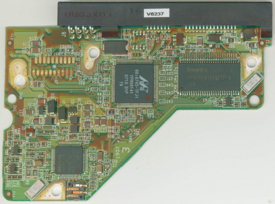

hello to all hdd kings
my problem is, the old pcb has a burned out unit in the upper right corner, when the pcb get power the chip really smoke and get very hot
i have a brandnew board (all absolute ident) but i need to know WICH CHIP contains the drive parameters??
hotairstation and so on isnt a problem
please help me
many thanks in adv.
michael
File comment: old board: burned unit UPPER RIGHT

The one with the M on this specific board I would think.

the biggest one :(
what do you think
is it better to change the "m" to the new board
or is it better to try to repair the "old" board - but what can happen that the upper right unit gets so hot??
i read a lot of "smooth" chips burned out !?

I'd shoot for repair of the original board first, search TVS Diode on this forum for more info
That's the 12V TVS diode. You can simply remove it. If there is no other damage, the drive will work perfectly well without it. Just be absolutely certain that your power supply is OK, as you will no longer have overvoltage protection on the +12V supply. For continued protection you can replace it with an SMBJ12A from Farnell, Mouser, Digikey.
It sounds like zero-ohm resistor R64 is OK, but measure its resistance to be certain. If it is open circuit, you can replace it with a wire link.

@fzabkar
YOU ARE MY HERO!!!!!
MANY THANKS!!!!
your trick works GREAT!!!!!!
all datas recovered (460 GB)
