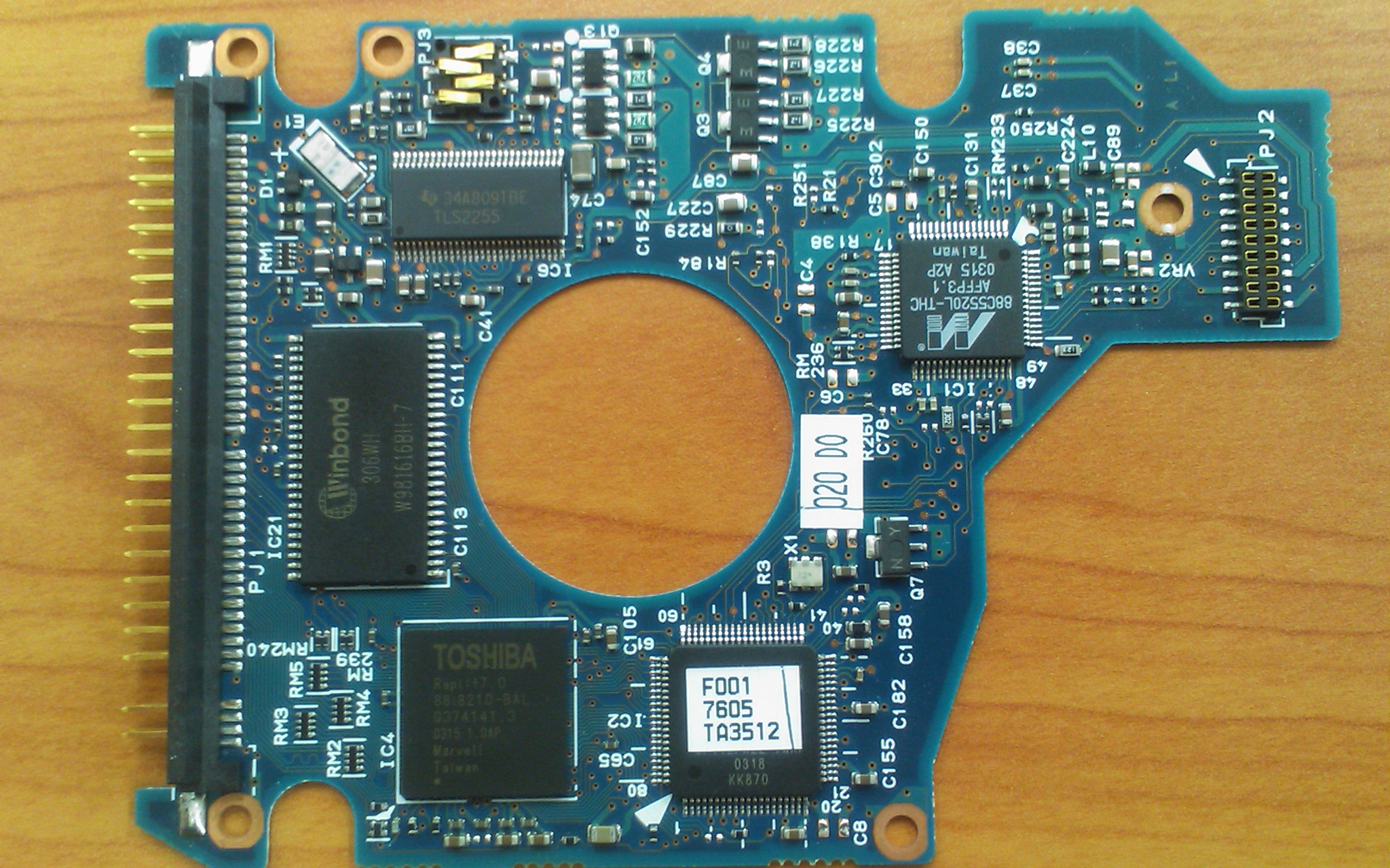

Hello.
MK4021GAS can't spin up.
when i try swap other hdd's PCB, it spin up.
so, i think PCB problem.
is it possible swap same model's PCB?
if not
i want to know what chip has firmware on PCB.
File comment: MK4021GAS PCB
thanks.

Hee wrote:
Hello.
Check both 0-resistors near D1

DR-Kiev wrote:
Hee wrote:
Hello.
i'm already check it, by multi tester's continuity test.
when i check it, sounds beep.
so i think 0-resistors fine.
is it wrong?
is it wrong?
That's fine. However, they're not resistors, but 2A fuses, assuming I'm looking at the same components.
Littelfuse Surface Mount Fuses (N = 2A, S = 4A):
http://www.farnell.com/datasheets/48294.pdf

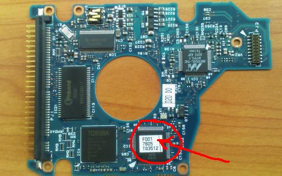

No.
This one:

DR-Kiev wrote:
No.
This one:
Thanks.
i'll try it.
