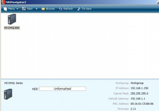

HD501LJ, DDI'd few bads (couple hundred)
Usually UFS Explorer sees the Partition with out a scan. R-stud is the same.
would just a few errors throw it out?
making another image just now
any ideas?

 Post subject: Re: Another Buffalo Linkstation 500GB
PostPosted: November 2nd, 2010, 10:41
Posts: 511
Location: Austin, TX
scan for lost partitions

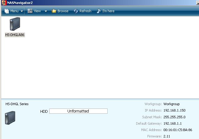

PostPosted: November 2nd, 2010, 11:15
Posts: 248
Tried that mate just lists RAW.
Tried clone in the original case but only cant see it either, I have a 1TB Samsung in the case is there a limit to the size that it can see?
PostPosted: November 2nd, 2010, 14:12
Joined: December 4th, 2008, 18:35
Posts: 8
Hook up the image to a linux system that supports xfs and run xfs_repair.
PostPosted: November 2nd, 2010, 15:29
Posts: 1493
why not try to read the 'few hundred bads' up the read retries, read without ecc. Might not have to repair partition then.
PostPosted: November 3rd, 2010, 6:53
Posts: 248
UFS Eventually did the trick
thanks all
