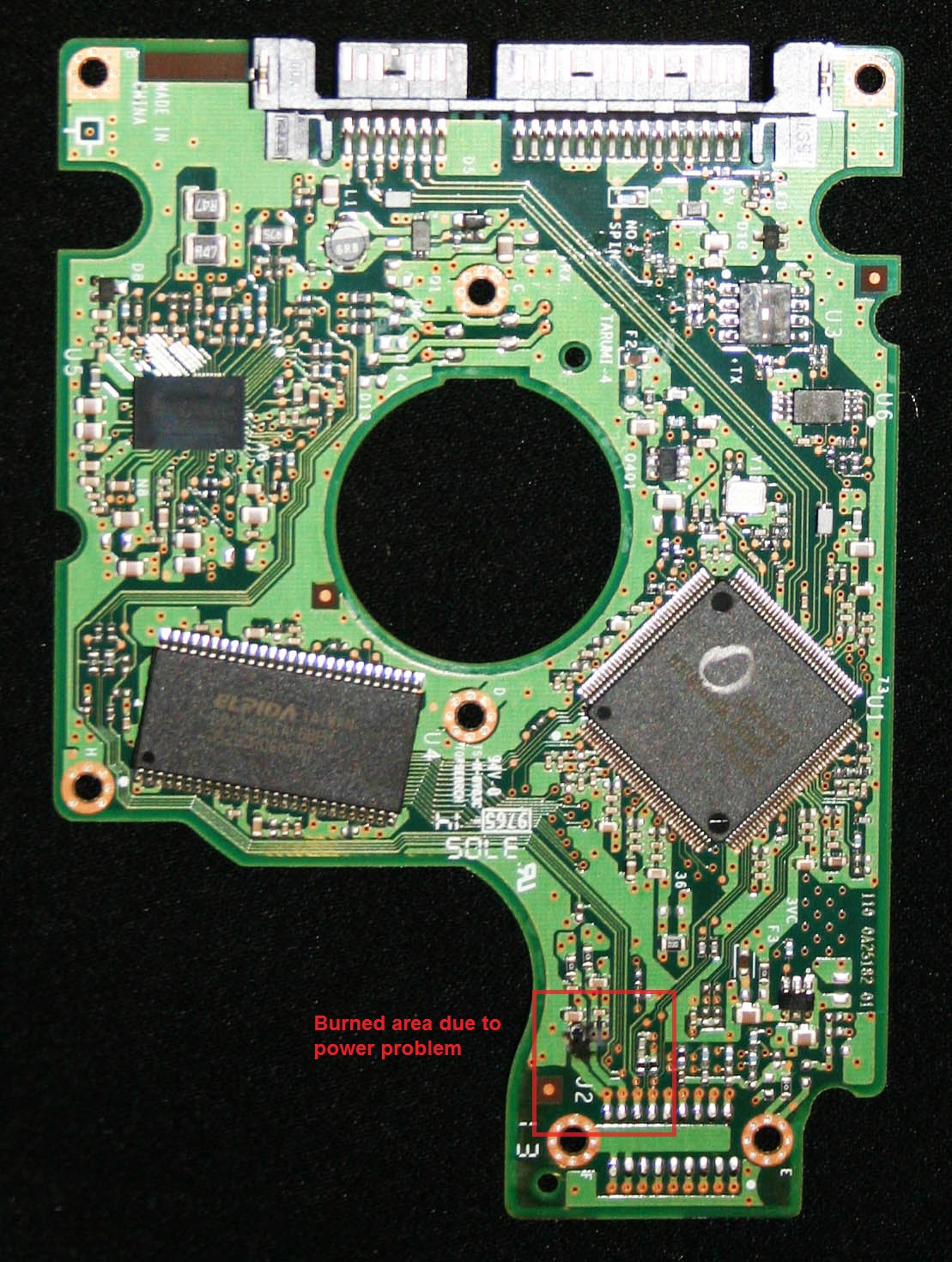

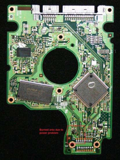

you helped me a lot, just to clear all doubts about which rom I should swap, am attaching a picture of the original PCB showing the burned area. It would be great if you could show me the exact part.
Best wishes
File comment: Picture of my original burned PCB
 Post subject: Re: PCB Swapping for Hitachi Travelstar 2.5 60GB SATA
PostPosted: July 8th, 2010, 7:16
The NVRAM chip is U6.
Transfer this over to the PCB and assuming it's "only" a PCB problem and the NVRAM is OK then it should work.
