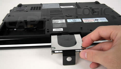

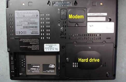

Yea if it clicking you might have a serious problem in trying to access the data.
THis are very similar deisigns to your l350 and taking the hdd out is simple 2 screws remove pull toward your self/ or pull upwards.
Turn on the notebook and put you ear near the place where the HDD should be- if the ticking is definitely coming form the HDD then its bad luck
other wise try this...
It seems like a SATA

Try and buy something like that.
If you connect the hdd to that and it clicking/ticking/knocking.. Bad luck mate. You will need to find a specialist.
