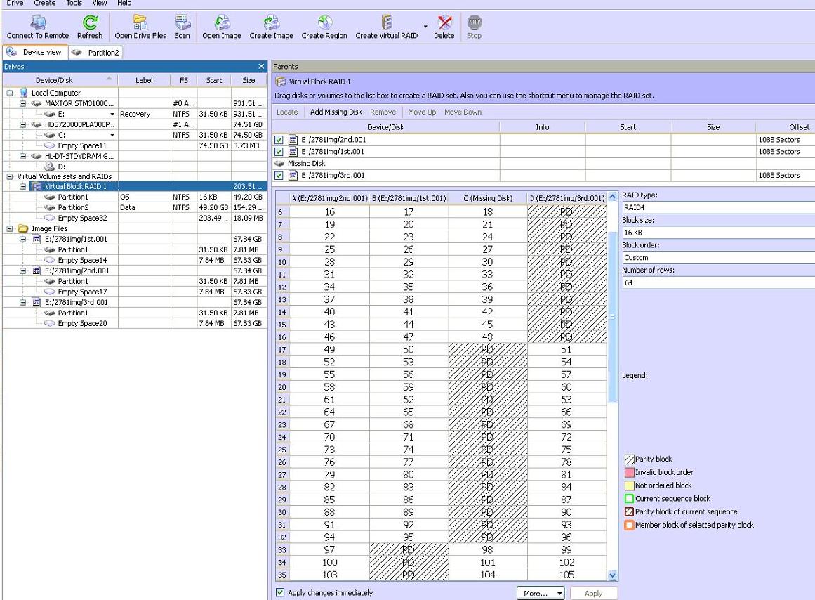

2 spatecc
Most of all HP raid system i saw, use parity delays.
In R-studio you could buit it only manual .
Somthing like this:
Angel Data Recovery

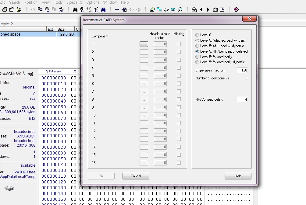

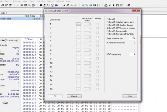

 Post subject: Re: Need help with RAID-5 SAS 3x146Gb
PostPosted: October 25th, 2010, 3:17
Joined: April 13th, 2010, 3:37
Posts: 32
Location: south korea
Use X-ways WinHex.
it support hp parity delay.

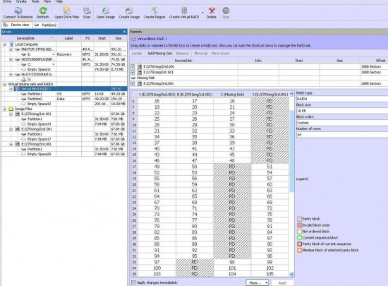

UPDATE
I am trying hard on this, barely sleeping to find the correct parameters.
I am working with this guide: http://www.r-tt.com/Articles/Finding_RA ... ndex.shtml
I think I made some progress here. In R-Studio I was able to mount a RAID configuration who allows me to mount the second partition (200 Gb): 2-1-0, 64k, left asyncronous (continuous). I am working right now finding the offset.
I think my problems here are narrowed to find the offset, to find if the RAID has some kind of delay and maybe if one combination of disks can work better than other.

Hi everyone. Sorry for the wait.
This case was succesfully recovered with the kind help of one member of this forum.
The data was recovered (at 75% roughly, mainly because the disks was modified by the user after the failure), using at first WinHex to examine the data structures in each disk, and then making a custom xml in RStudio.
