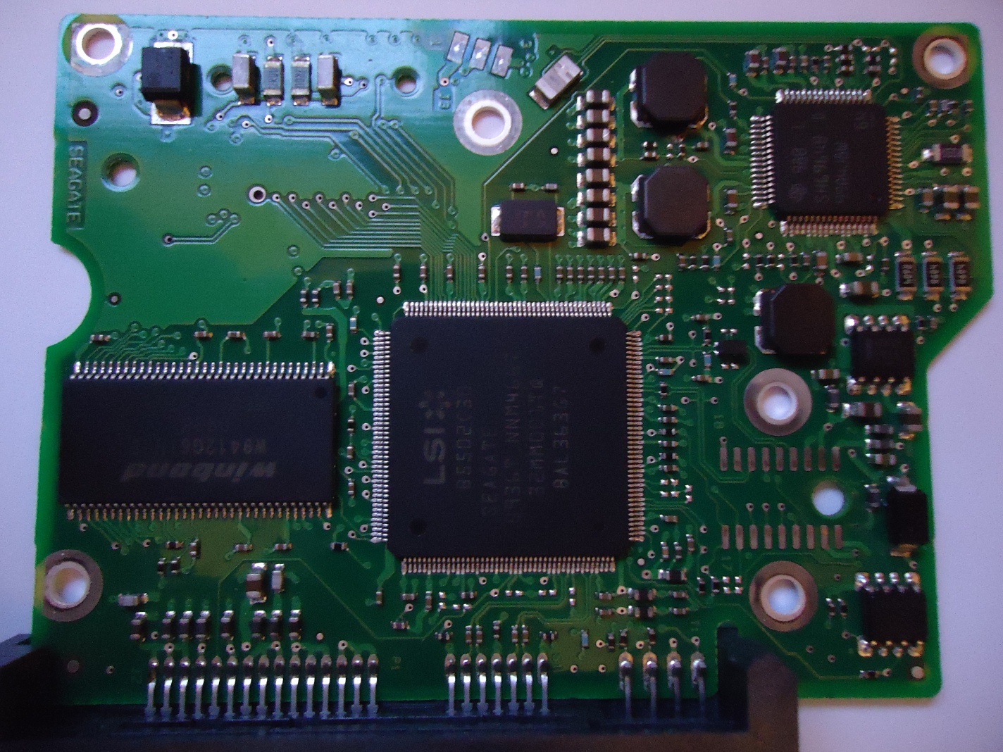

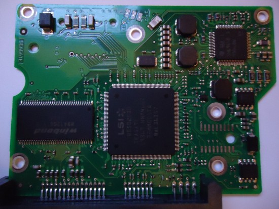

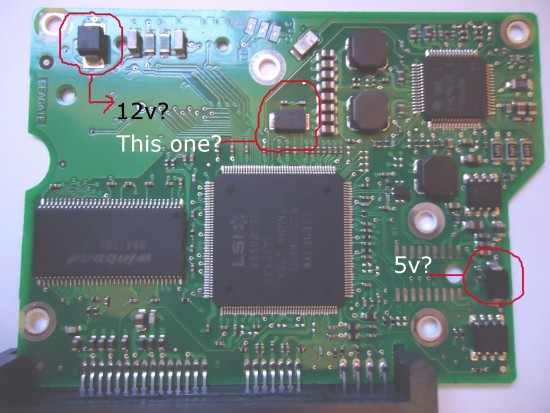

Ok, This is an image of my HD that dont spin after the power plug mistake:
File comment: Indicate me please where is the TVS diodes and the Famous Eprom
File comment: As you see no burnt component visible

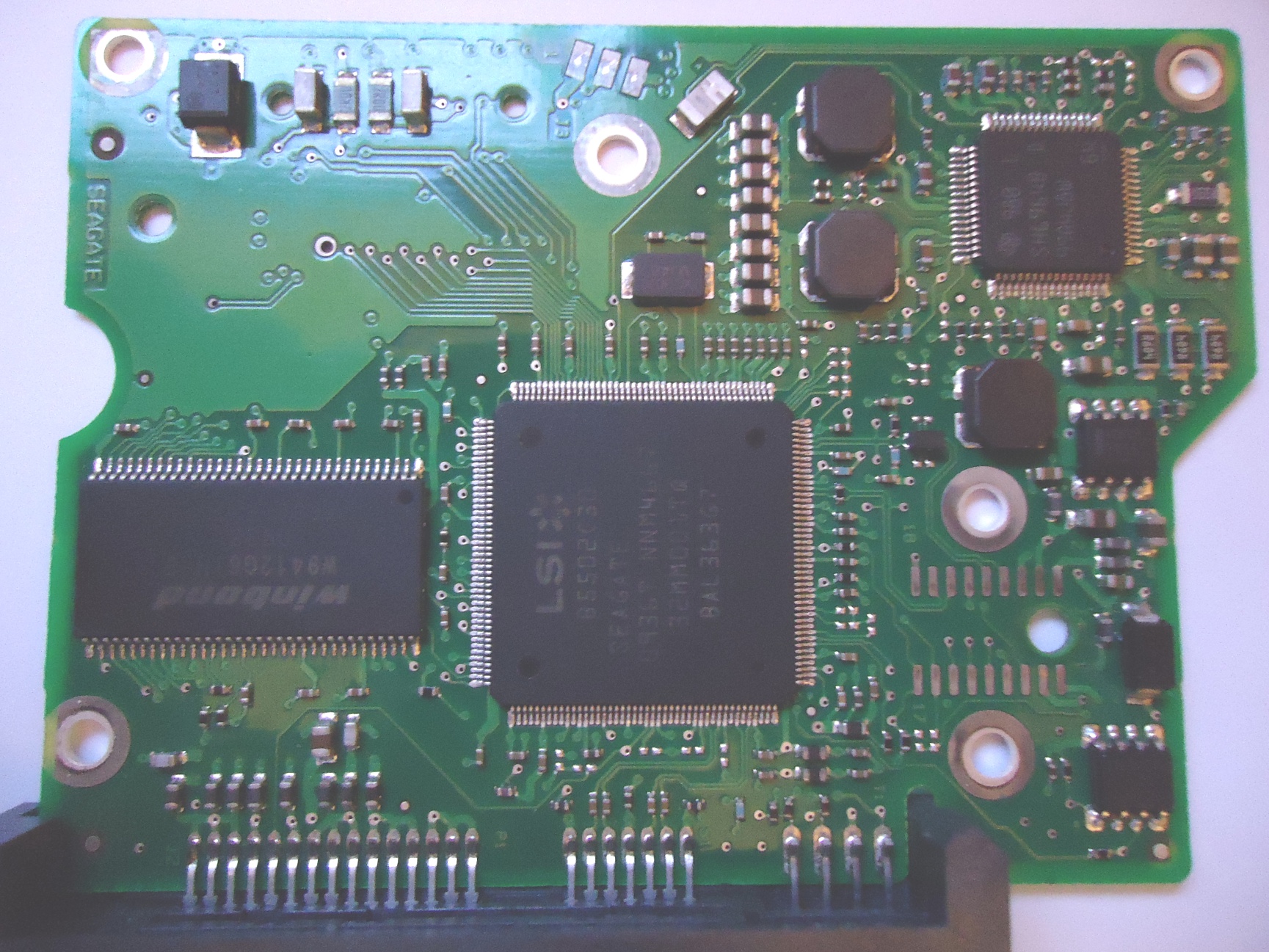

This one seems better

Maybe you have learned the lesson, DIY is not for you.... :)
It looks like this HDD have no TVS, you will need professional help for both of your drives if you want your data back.

F3 T>
 Post subject: Re: Maxtor (seagte) DiamondMax 23 Burnt?
PostPosted: November 11th, 2010, 16:48
Posts: 17333
These photo clips should help you identify the TVS diodes:
http://www.users.on.net/~fzabkar/HDD/Di ... 2V_TVS.jpg
http://www.users.on.net/~fzabkar/HDD/Di ... EEPROM.jpg
Please confirm the identities of the components by comparing the marking codes against my notes:
http://www.users.on.net/~fzabkar/HDD/HDD_ICs.txt
http://www.users.on.net/~fzabkar/HDD/TVS_diodes.txt
The components identified in the following clip are either inductors or capacitors (I can't tell them apart). One end of each capacitor would be connected to ground. Inductors should measure zero ohms.
http://www.users.on.net/~fzabkar/HDD/Di ... uctors.jpg
This article may be useful also:
http://hddscan.com/doc/HDD_from_inside.html

Thanks fzabkar, this is very usefull, now i now exactly whare is my TVS, :D
One more question please or two: :oops:
How to identify the defective ones? (I have a simple Multimeter tester)
I've read in other threads that this diodes act like a fuse how shortcut the supply in case of over voltage to the ground, so what i should get in resistor test mode? (1? or what)
After identifying the burnt ones Should i just unsolder them to get the HDD work again (Just the time to make Backup).
One more time thanks a lot :D

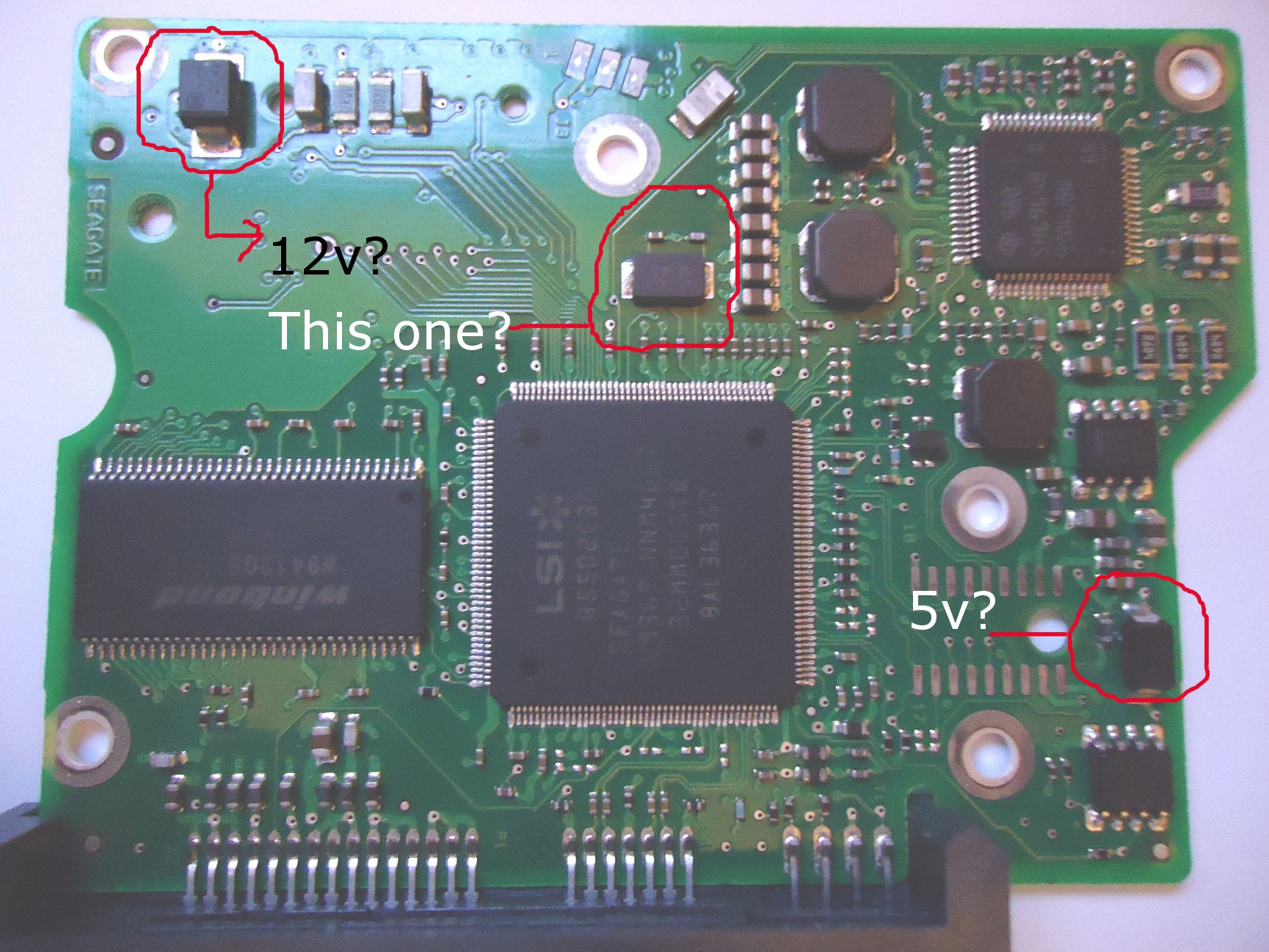

I ad this image, can anyone answer me?
PostPosted: November 11th, 2010, 19:20
Posts: 17333
TVS diodes protect your drive by going short circuit whereas fuses protect it by going open circuit. Therefore a diode acts like a crowbar across the supply, whereas a fuse is in series with the supply, ie they do not work the same way.
Anyway, when a TVS diode fails it will measure close to zero ohms on the 200 ohms range of your meter. You can remove a shorted diode by snipping its pins with flush cutters. Assuming there is no other damage, the drive will work perfectly well without the diode, but it will no longer have overvoltage protection on the affected supply. So be absolutely certain your power supply is good.
If, for continued protection, you wish to replace the diode, then a 5V TVS diode can be substituted with an SMAJ5.0A, and a 12V diode with an SMBJ12A. Both can be ordered from Farnell, Mouser, Digikey.
If you need to replace the PCB, then be aware that modern drives store unique, drive specific calibration data is a serial EEPROM chip. If the replacement board causes the drive to click on power-up, then you will need to transplant this chip, or its contents, from patient to donor. The EEPROM will usually have a "25" in its part number.
This vendor offers a board for US$40 plus $10 for a ROM transfer:
http://www.onepcbsolution.com
Here is another:
http://www.hdd-parts.com/

What is the third one (in the middle of the PCB, seems to be another TVS)
So to make my HD work again i should unsolder the TVS? (if the problem are just in it) otherwise i should find another PCB and transplant the EEPROM?
Now i'm feel really better (some hope come back).
Just the time to find Heated Air Station of my friend.
PostPosted: November 12th, 2010, 16:20
Posts: 17333
I can't see the markings, but the component in the middle appears to be the crystal for the MCU.
The TVS diodes, if shorted, will have been damaged when you misapplied the power. That will have nothing to do with your terminal output. The original fault does not appear to be a board issue.

The middle piece is marked:
TXC30.0
MJ48
With the tester:
In Ohm meter mode (200k) its indicates 50 k Ohm in the first direction and infinite (1) in the second.
In diode test mode (2000 -|<-) indicates 1 in the two direction
What it could be?
To remove the EEprom i Must use The Air Heating system?
How to test the Selfs? the spin motor controller?
Does it exist an Eeprom reader/copier for this kind of circuit?
The chip is it Rewritable? May be it can be flashed if i replace her on another PCB or is it safe ? (its marked: 25W406A 21 9VG1C).
I know i'm asking too much :oops: , Sorry and thanks a lot for your kindness :D
PostPosted: November 13th, 2010, 21:58
Posts: 17333
TXC30.0 is a 30MHz crystal. Leave it alone. :-)
http://www.txc.com.tw/en/c_products/01_1.asp
The 25W406A EEPROM is a serial flash memory. I can't locate a datasheet, but if it is an ST Microelectronics part, then its full part number would be M25W406A.
If you are new to soldering, then you should practice on a scrap board. If you damage the EEPROM, then you will be in expensive trouble. You can do the job with a temperature controlled soldering iron if you are careful. Alternatively, your local TV/AV repair shop may be able to help you.
I don't know of any easy way to test the major chips. In general terms, when troubleshooting a microprocessor based circuit, you first check the supply voltages, including the onboard DC-DC converters. Then you should verify that the crystal is oscillating, and that the MCU's reset pin is not active. Then look for stuck address and data lines.
You can read the EEPROM in-circuit using an IC clip and a device programmer:
read-write-serial-flash-wdc-logic-boards-t7192.html
The following datasheet should help you understand the function of a typical motor controller chip.
L7250, SMOOTH, spindle motor + VCM controller, ST Microelectronics:
http://www.datasheetcatalog.org/datashe ... Xyuswx.pdf

When tou talk about MCU's Reset pin, you talk about this 4 pins on the front, byside power and Data connectors used to set the mode 1.5-3 Go datarate transfers?
The only things i know about them is the transfer mode and the ASCII debug procedure, is there another usefull configutation on it? how to set The Reset option on seagate PCB of DiamondMax23? :please:

i've found about MCU's Reset pin on the chip itself, :roll:
Whats the reset do exactly? How i set this Reset? In this kind of Chip?
