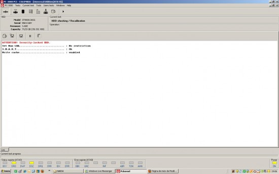

Seagate Momentus 5400.3 80 GB
MDL: ST980811AS
FIRMWARE: 3.CDD
I did head stack replacement, the hdd is ready but now the disc is recognized with another model, serial and firmware.
Please see image

Did someone 'touch' the pcb?

Plug your numbers into Seagate's warranty validator:
http://support.seagate.com/customer/war ... dation.jsp
Compare the date code on the label against the YWW (Year / Week) date codes on the chips.
Seagate date code calculator:
http://www.bugaco.com/calculators/seagate_date_code.php
I believe the date of manufacture may also be stored in the SA.

There are many things to "do" with a PCB / drive without touching a screw, the OP is a pro.
PM sent. ;)

the hdd is blocked...

I think the drive is password protected , remove password and see what happens.

The eventual lock is the lesser/last problem... Was the rest fixed?

The PCB is not original.
