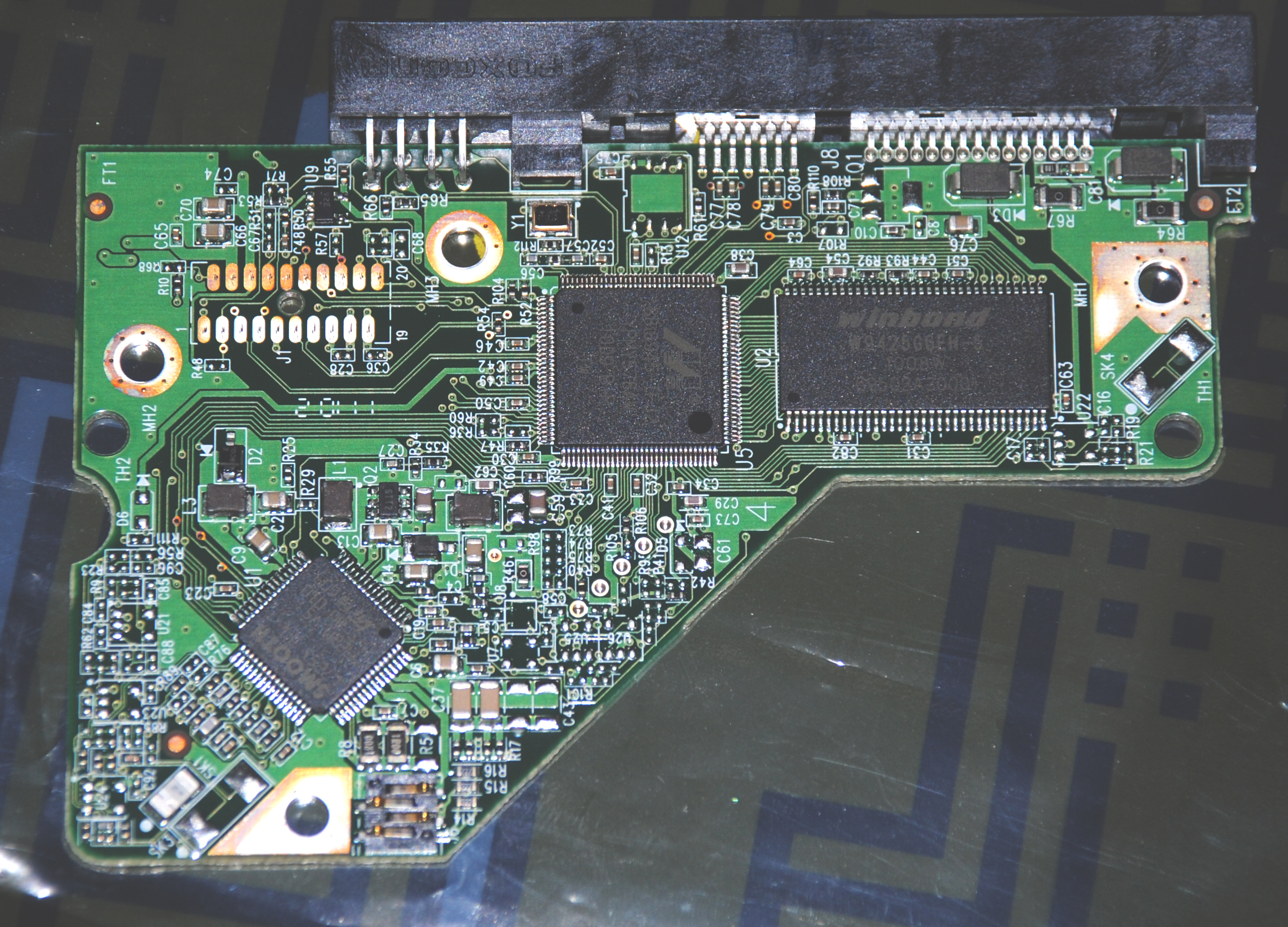

Hi all.
My Western Digital 500 gig SATA HD will not spin. I think the PCB board is fried. No signs of burns visible to my eye. The HD model number is WD5000AADS-00S9B0.
PCB serial number is: 2061-701640-300 ADD1 XC 9N30 50W8 L 0005380 0385.
Will a matching PBC fix this issue or is this a goner. Would really love to get back my data, but cost is areal factor. Thank much.
-IMToast/Ed

If your board looks like this ...
http://img543.imageshack.us/img543/9545/best13.jpg
... then check TVS diodes D3 and D4, and zero-ohm resistors R67 and R64 near the SATA power connector. Measure their resistances on the 200 ohms range of a digital multimeter.
If you decide to replace the board, then you will need to transfer the 8-pin serial EEPROM chip (U12), or its contents, from patient to donor. A ROM transfer should not cost you more than $20. Some vendors will do it for $10.

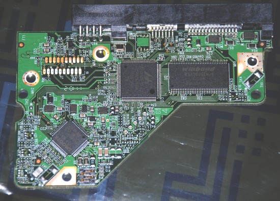

Hi fzabkar.
Thanks for the offer to help. No, my board does not look like that. Check out the photo. You can see that mine doesn't even have a chip at U12. Any thoughts on this? I really need to get some files off of this drive. Thanks again for the help.
-IMToast/Ed

 Post subject: Re: Western Digital WD500AADS HD will not spin. Think I need PCB
PostPosted: November 10th, 2010, 3:45
There is no external 8-pin ROM on this PCB, if there were it would be at U12 at the top of your pic.
The ROM is masked inside the MCU on this model, so requires specialist equipment (i.e. PC3000) to resolve the issue.
And no, there isn't a standalone program to do this.
You DO require pro assistance on this one, which shouldn't cost too much AT THIS STAGE if you don't tinker with it and it's "only" a PCB fault.
Did you measure the diodes and resistors? None look damaged, but if either resistor is open circuit, then that will prevent the board from powering up.
