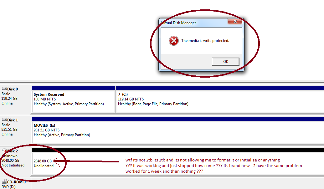

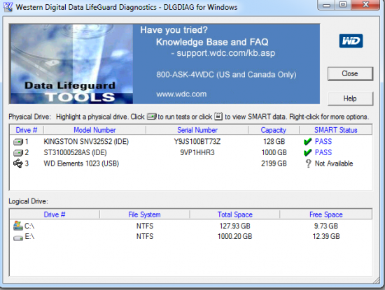

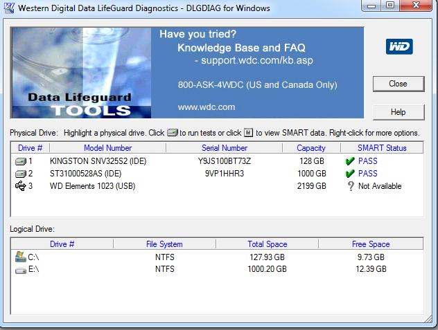

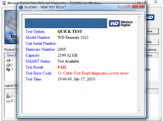

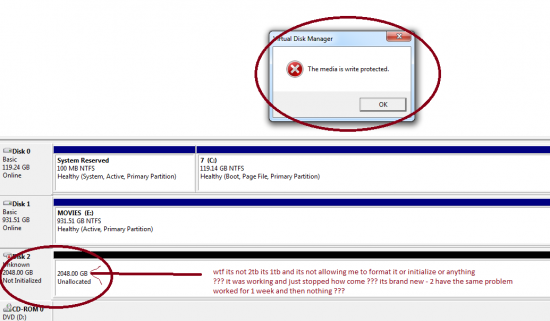

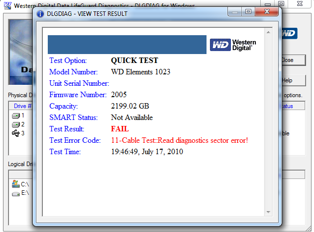

2 brand new hard drives 1Tb western digital 2.5 hdd usb's working perfect. put all my photos on it and everything
using it for a week and now i cant open it it doesnt even show up
only shows as unmounted or not itilized in disk manager all the recovery programs i have tried say
FAILED due to write protection
wtf... ???
example --> attached
File comment: example 3

Well thats usb drives for you. I bought samsung s2 drives used it once and it did what you have - repalced it like for like - the 2nd replacement did the same! 3rd one seems ok now.
It may seem stupid and trivial but have you tried a different usb cable - its highly unlikely - but the highly unlikey stuff seems to work sometimes.
You said you used it to store data - but is it important? to recover I mean- if not just swap them at the shop you got it.
Is your WD the very slim one with the USB port built onto the hdd pcb? you might not know unless you open it-but i dont think you want to void the warranty.
It gives an error on read and says its write protect - so unless you put some password on the drive i would say something went wrong with the pcb.

12 Pin Header With USb and INIC IC

yeah i dunno i contact western digital level 2 support and they cant even help its fucked.
mind my language
i dunno what else to do
i tried disk part
i tried removing the disk from the case and putting the same drive that works brand new chip
i tried different operating systems.
i tried registry removal key or write protection and policies
i tried different computers, different cables...
running out of ideas
