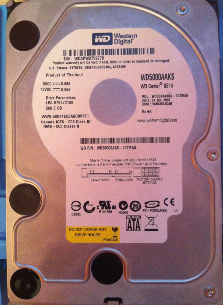

So I've had my book II for about 3 years.
It contains 2 WD5000AAKS 00TMA0 drives in RAID 0 (never again)
It started having problems a while ago and all of a sudden now it just doesn't show up on any computer. After doing some research I've concluded that PCB on drive A was fried.
The beauty of having 2 drives in RAID 0 is that i swapped boards between them to test it out. After the swap the drive that did not mount finally mounted and the one that worked started doing the same thing as the other one before.
As good as this would be on individual drives I need 2 of them working together at the same time :(
The drive with the bad board would kind of restart itself a couple of times and thats it.
I'm desperatelly looking for a PCB board replacement or if anyone has any other ideas of what I can do to fix this crap???
here are the numbers:
S/N WCAPW3759778
WD5000AAKS
CAVIAR SE 16
MDL : WD5000AAKS-00TMA0
DATE : 21 JUL 2007
DCM : HANCNVJCAB
NUMBERS ON THE BOARD :
2061-701477-900 05P XC4V06 0G09 H 0002020 8022
I greatly appreciate your help!

There is a chance that adaptive info in ROM is close enough for both drives. Here is what i suggest u do. Take the board from a good drive and put it on a bad drive. If the drive IDs properly and all is well - clone it to a 3rd drive. Use bit by bit cloner like HDclone, Copy-R etc. Then the clone is done , u take the good PCB from a bad drive and put it back onto ur good drive. Then put it in enclosure with the clone that u made. Cross the fingers. Done.
OR Contact a data recovery shop in ur area to see how much they would charge u.
PS Ur 2 drive in the enclosure might die soon as well. Tornado +)
