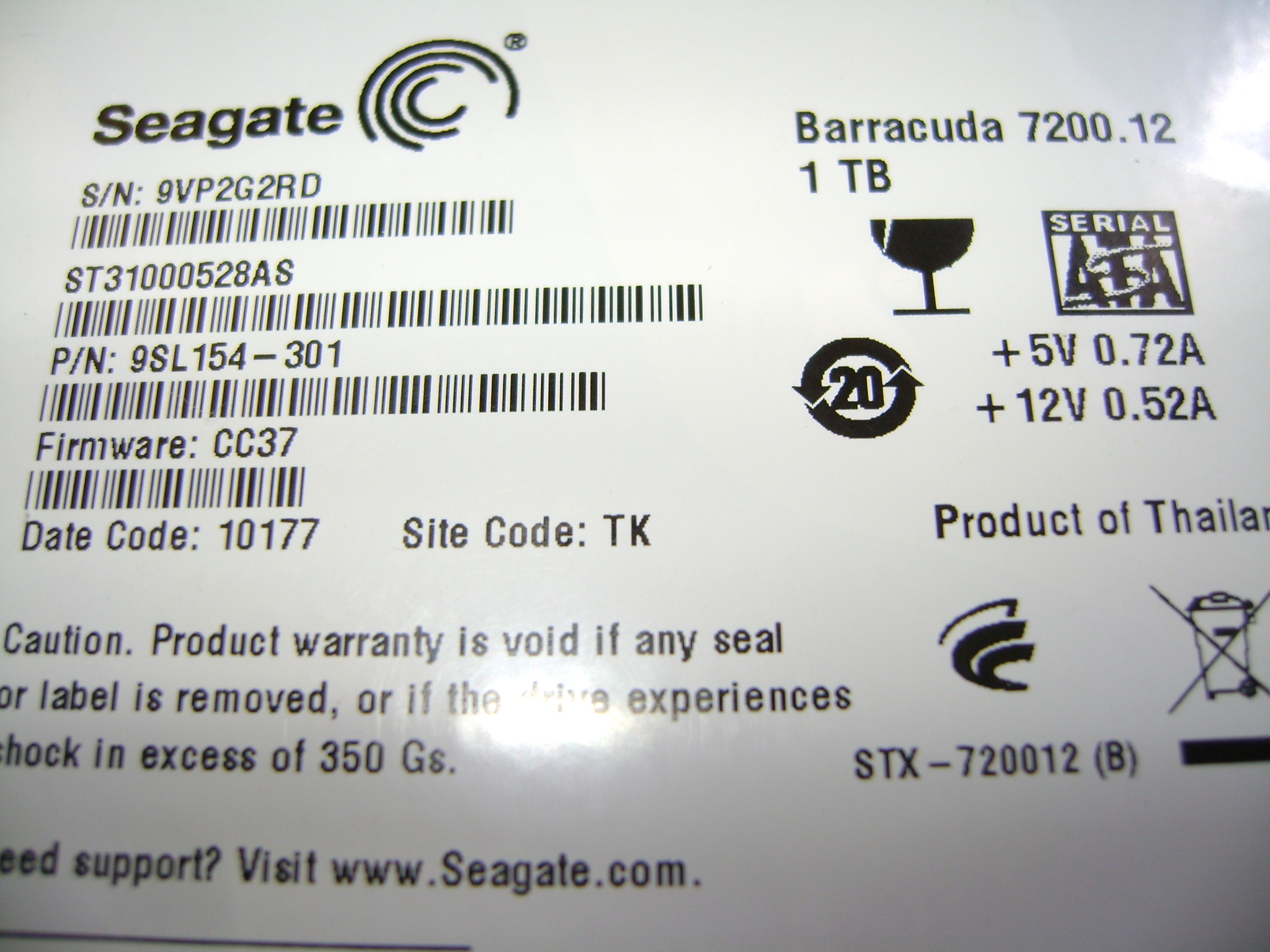

I made the exchange of the reading head, and in pc3k it continues beating and I do not obtain access to the data in terminal hyper is giving to this log of Failed error you load to over Lay 00000004 LED00000CC FAddr: 00289581, hd seagate barracuda 7,200-12 1 TB I do not obtain access the data therefore same head changing continues with same error, somebody knows to help in this case me

I changed to the head of reading of hd seagate 7200-12 and I do not obtain access to the data, somebody has the solution for this case

are you sure can disable heads in pc3000UDMA?
are you sure pcb is original?what's that problem?

Is there any scratch on platter ?
What was the original problem ?
Why did you change heads ?

Rameez is right, you should indicate properly the original problem and your steps for the recovery attempt, or else it will be hard to draw a picture of what happened.

i think this is not bad head !!!
to carry and to save firmware seagate
