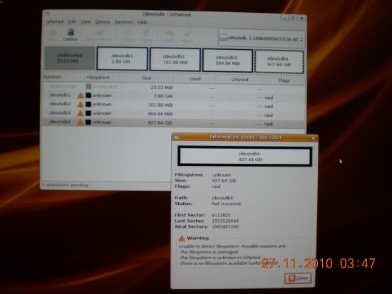

I got one of my clients Raid0 Linux Partitions
(this is NAS WD Model wd20000d033 2TB 1tbx2 hdd)
i tried the Linux Ext2/Ext3 partitions lookup, and found 3 but none of them contains folders/files
it has only files with the name: inode
i tried Raid Reconstructor, but again nothing
RS found those files but as RAW only, jpg and each ext. alone
is there anything else i can do here guys?
thnx

here is screen shot also
is there any other way to get the files/folders on their org. names
thnx

 Post subject: Re: Any Experience with Raid0 Linux
PostPosted: November 27th, 2010, 9:11
Posts: 1336
Since its an NAS appliance most likely the header offset is different. try changing the header offset and then mount it again in Linux or UFS, what ever is your preference.
PostPosted: November 27th, 2010, 9:45
Posts: 2858
Diskinternals - Raid Recovery was the one.
thnx guys
