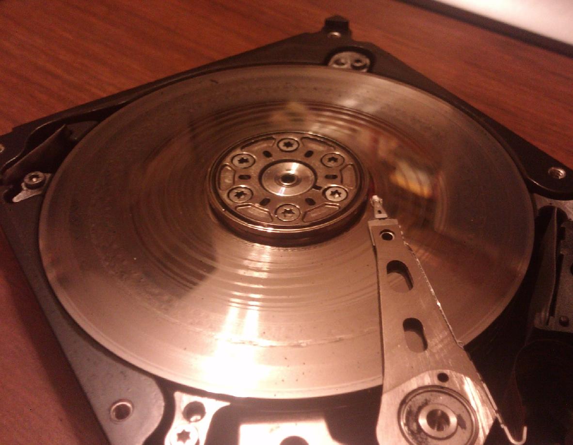

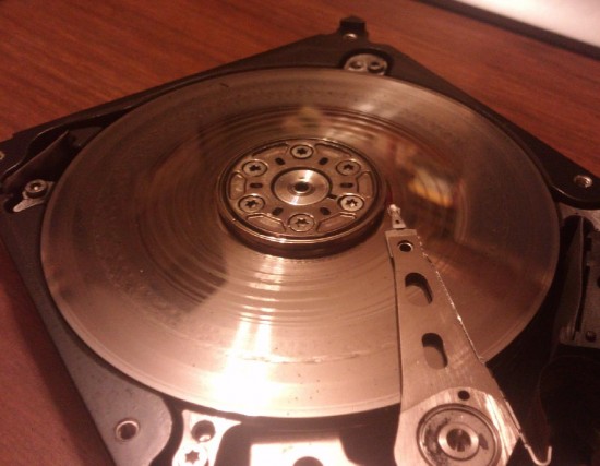

I just opened it, and It's a complete wreck. The platter is entirely scratched, and it's all dusty (the dehydrant bag is supposed to be white and it's completely black from the dirt)
I cant' imagine how happened, as the NAS were this drive was enclosed was bought just a few months ago...
The only way I figure I could make use of this drive would ve to get an RMA, but as this is an OEM HDD I think it won't be possible
Here are some pictures of the mess, in case you're curious.
