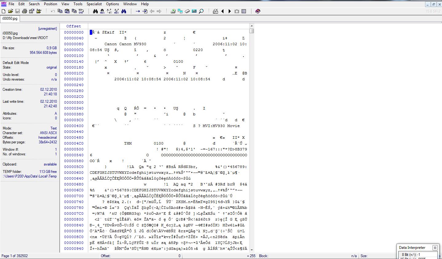

This is how the file looks in hex

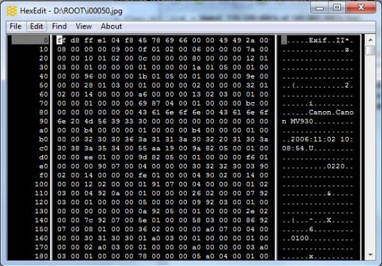

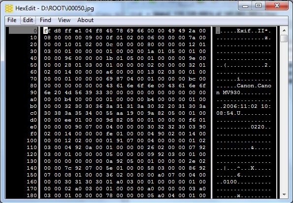

If the header is still intact, then for an avi file you could search for the text string 'RIFF' or search for the same in hex '52 49 46 46'
If the format is not avi but another then you would search for the header used by that format.
If the header is damaged or missing there may be other ways of searching for the file. eg. by file name or by date.
You can also use Dmde free edition for this work which also allows you to recover single files without size limit.
Do a google search using the terms 'file header hex edit' and you will find loads of clear explanations. Also info on how to repair a broken/corrupted file header.

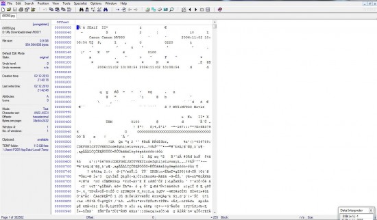

Ty very much, I've spent my day googleing. Unfortunatly, I wasn't able to find any tips about replacing the header. Is header shown in first line only? I didn't find anybody who had similar problem.. movie file under jpg extension.. God, I feel soo
stupid..
I tried DMDE but not sure how to start.. DMDE doesn't allow me to open single file, however WinHex does.. Most of google articles are about fixing corrupted header, fixing avi etc..
File directly opened in WinHex shows that there is movie file inside (MV930 Movie)..
Any tips how to locate beggining and the end of my avi file hidden in the jpg? Thank you

Here is a freeware hex editor and disc editor:
http://mh-nexus.de/en/hxd/
This article may help you understand the EXIF header:
http://en.wikipedia.org/wiki/Exchangeab ... ile_format
I'd use Google to research "EXIF II" and "MVI".
But the very first thing I would do is to use your camera to record a short movie, say 10 seconds, and a still photo. Then analyse these known good files to get a feeling for their structures, especially the headers. I'd also get a feeling for the bit rate of the movie file, ie how many kilobytes per second. That should tell you what file sizes you should expect.
