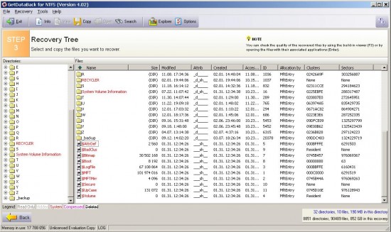

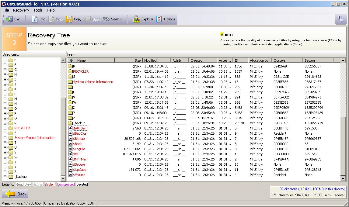

edit:
I have answered both replies, but the message said it has to be controlled by the moderator?! :x
if tomorrow cant be read, i will repeat it.
Btw.: getdataback window attached of the file tree

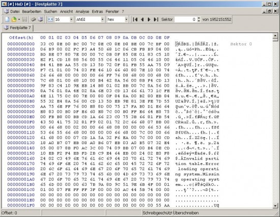

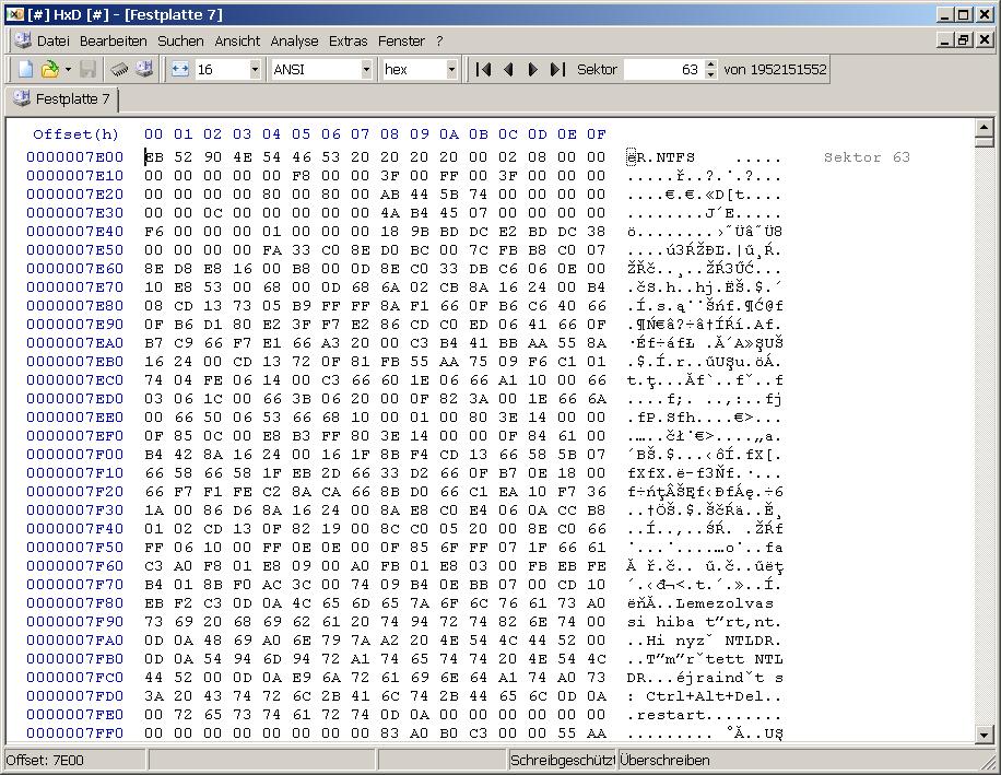

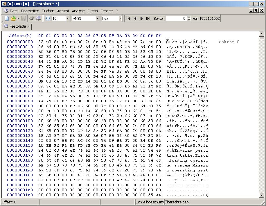

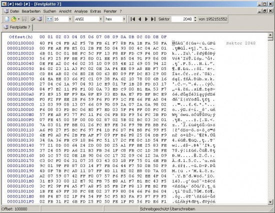

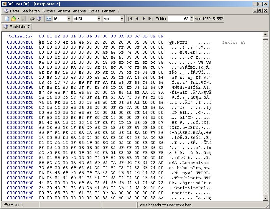

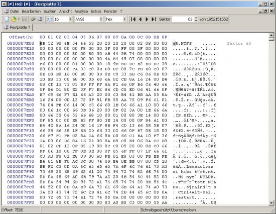

 Post subject: Re: after partition recovery windows shows raw file system?!
PostPosted: December 12th, 2010, 21:25
Joined: December 10th, 2010, 3:25
Posts: 27
sectors:
PostPosted: December 13th, 2010, 3:29
Posts: 17249
AFAICS, your drive has been partitioned using the MBR partitioning system rather than the default of GUID for current Windows versions.
The partition table at sector 0 is indicating that there is a single NTFS partition (type 07), with a size of 0x745B44AC sectors, starting at LBA 63.
The 16 bytes corresponding to this partition are located at offsets 0x1BE - 0x1CD.
80 01 01 00 07 fe ff ff 3f 00 00 00 ac 44 5b 74
Sector 63 appears to be a valid NTFS boot sector. It is reporting a size of 0x745B44AB sectors, ie 1 less than in the partition table. This is correct.
In short, both the boot sector and MBR appear to be intact. Therefore the problem is in some other area of the file system, perhaps a corrupted MFT.

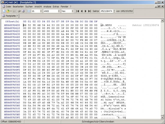

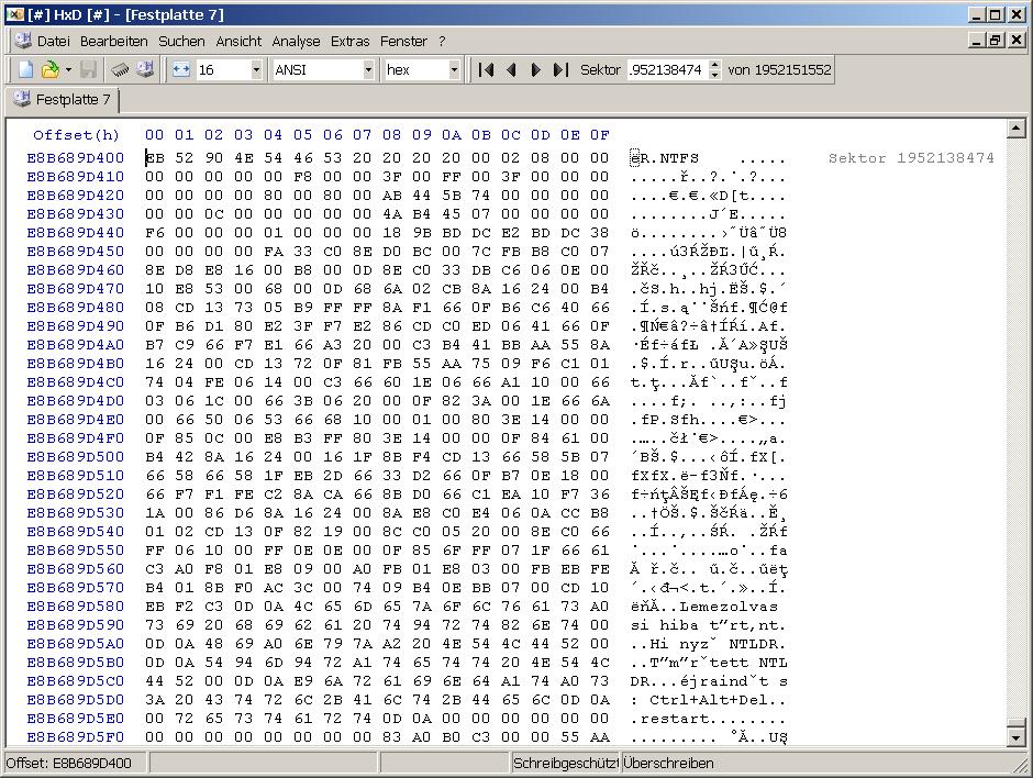

One other sector you could check is the backup boot sector at LBA 0x745B44EA (= 1952138474 in decimal). The contents of this sector should match sector 63.
I will, but I can do it only later, I will post it. Thanks again.
PostPosted: December 13th, 2010, 16:10
Posts: 27
