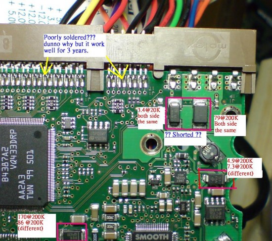

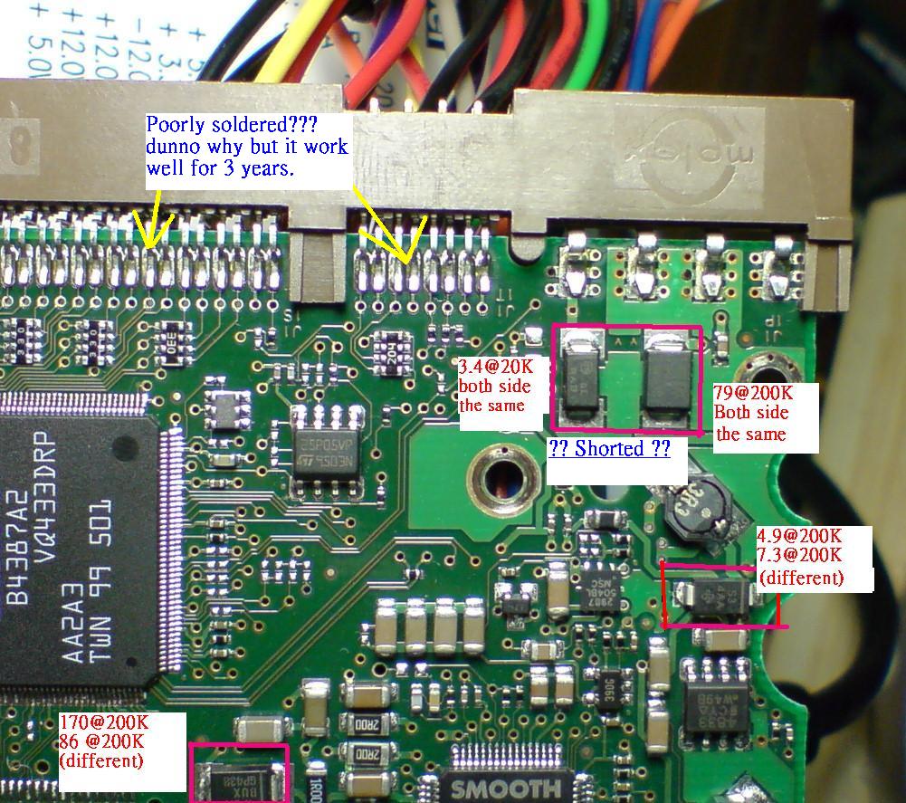

Dear Almighty!! Your sheep encountered a weird situation.
(First time trying to get data back, completely noob about HDD organism, no mention to terminal operations)
My St3250823A's down, and not responding to hyperterminal connection.
I bought a multimeter and found 3~4 TVS-diodes reads weird.
"Each of them, the ohm reading is the same no matter the diode is Red-Black or Black-Red."
The manual came with multimeter says a diode is good when R-B posts high ohms, and B-R posts small.
Why's that? The PCB's shorted or something??
We live, and we pray...., if kind you had a mind, plz take a look to this poor hardrive.
The conditions:
(a) 10 days ago, the drive suddentlly hanged up during normal operation.
Then 1 of 3 driver letter is gone.(C,D,E,, and E is gone).
Reboot checking failed due to missing part of windows data.
BIOS detected correctly, terminal successfully connected, I tried to backup data.
(b)Within 24 hours, file backup stopped because of growing bad sectors.
(Bad sector-> kept reading nothing -> heard click click sound->lost harddisk connection-> have to reboot)
BIOS detected correctly, terminal successfully connected, Tried seatools repairing.(yeah, now i know it's stupid to do any write-in,don't blame me)
(c)"Whole lot bad sectors found after windows checkdisk and seatools". Also tried restoring partition table and other hdd utilities, all useless(even firmware-brick steps were applied).
BIOS start to lose st3250823a(not found or 0 LBA), terminal successfully connected.
(d)Now the BIOS is thoroughly dumping the HD, and RS232 is not responding anymore.
(st3250823a is 7200.8, I tried the 7200.11 brick steps but in vain)
The last terminal from mars' bit like following:
F>Buzz...Head mask FFFF.....
No Cert Code.....
Invalid cert code....firmware resident requied:3.02
Error write System sec.
AutoRd err at 000002....

Not a TVS or PCB problem
Also please stop running terminal commands now before you really mess something up

If your data is valuable, I would recommend stop messing around and take it to a pro, before heads will ruin for good and damage the platters.
