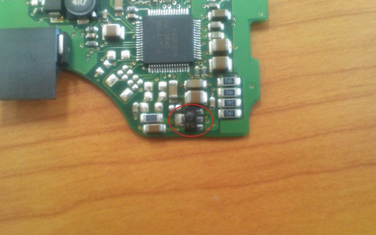

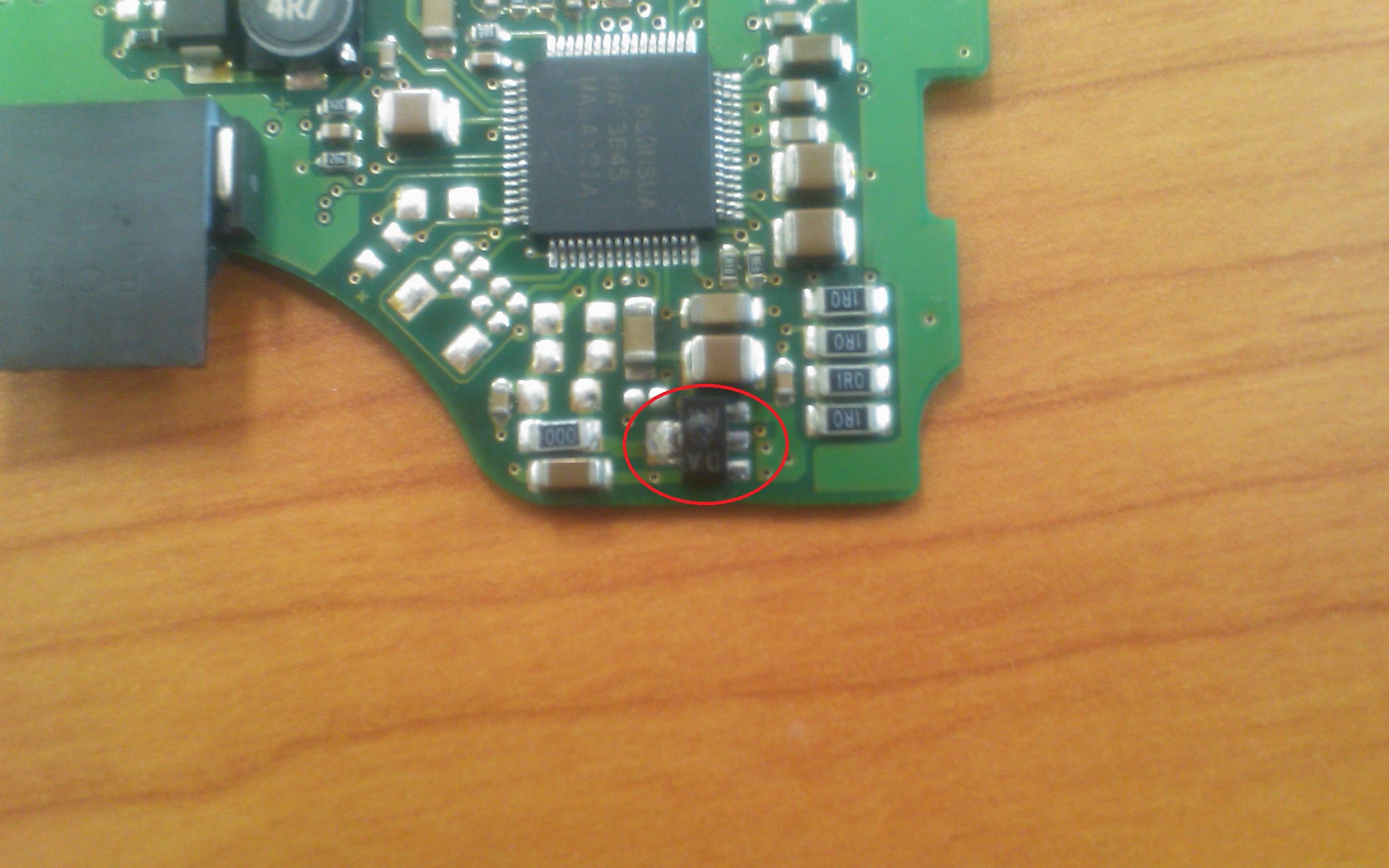

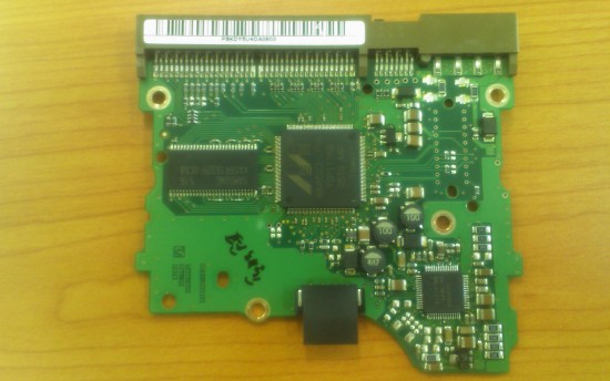

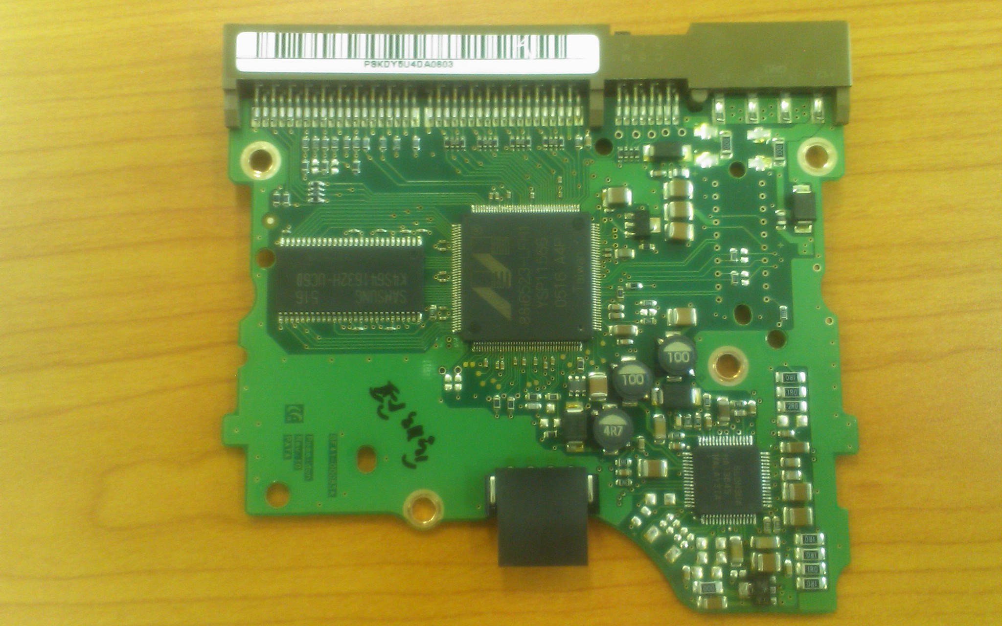

Hi
Samsung SP2014N hdd PCB burned.
Red circle in attached image is burned part.
so i try replace it.
but, when i power on it is burn again.
what can i do for this symptom?
i don't have same HDD.
i need a way fix PCB.
thanks.

I've just been through a reverse engineering process on a similar Samsung PCB with another forum member. If you have a multimeter and some time, then I can try to help you make sense of that area of the circuit. At face value, it doesn't seem very complicated.
Before you installed the replacement component, did you determine if it was a transistor, and whether it was NPN or PNP? If you have another spare, then measure the resistances between each pair of pins using the diode range of your meter.
I would remove the faulty transistor (?) and power up the board on its own. Then measure the voltages at each diode and coil, at the supply pins (1 & 27) of the SDRAM (datasheet below), and at the other transistor. Also measure the voltages at the unoccupied pads of the faulty transistor.
I suspect that the 4R7 coil is part of the Vcore regulator (+2.1V ?). The rightmost 100R coil is probably the -5V supply for the preamp.
The 5V and 12V TVS diodes have small filter inductors on their load sides. Confirm that the voltages on either side of each inductor are as expected.

BlackST wrote:
It's better to check motor, preamplifier and vcm then use a new pcb and 'make it work'... The circuit at this stage is rather complicated.
Bullshit.
The circuit around the faulty component has nothing to do with the preamp. The preamp stuff (+/-5V supply and communications with MCU) is elsewhere. As for the other two, at least one of them is probably bullshit, too.

Either you're ignorant, or you're deliberately obfuscating this thread. Once again, the faulty component has no bearing on the preamp. That's just bullshit.
As for a physical PCB, that would be preferable, but we can't always have what we want. Remote reverse engineering, across two hemispheres, is far from ideal, especially when the user is a complete novice, but it's possible. Furthermore, even in the absence of a resolution, the principles involved in the process may be instructive on their own.

I feel certain that the part is an NPN transistor. I'm convinced that it has nothing to do with any component inside the HDA. Instead it is most probably configured as a linear regulator, possibly to provide the +3.3V supply for the SDRAM (or maybe that's the function of the other transistor), or a second Vio rail for the MCU. The only other remote possibility I can think of is some obscure emergency retract function.
As for the HDA components, the VCM is driven from two pairs of MOSFETs in an H-bridge configuration. The spindle motor would be driven from 3 pairs of MOSFETs, one pair for each of the 3 phases. Each of these MOSFET drivers is internal to the combo chip. The preamp gets its +5V supply directly from the SATA connector via a filter inductor, and its -5V supply from a DC-DC converter elsewhere on the board. It communicates directly with the read channel in the MCU. I'm convinced that there is absolutely nothing in any of these circuits that ties them to the failed transistor.

Speaking of which, "kope", from a previous thread, has kindly taken some additional measurements for us. He has a Samsung SP2514N which has a similar PCB. He confirms that the tab and centre pin of the NPN transistor near the motor controller both connect to +5V (1.6 ohms), and that the emitter (third pin from left, tab facing upwards) connects to Vdd (pin 1) of the SDRAM (1.6 ohms). Since the SDRAM is specified for 3.3V operation, it is evident that the transistor is configured as a 3.3V linear regulator, as I surmised.
Therefore, your assertion that any of three components inside the HDA could be responsible for this malfunction, or be damaged as a consequence of it, is stronzata galattica. That you would continue to assert this despite my corrections damns you as a black stain on this forum and on the data recovery community in general.

The OP's drive appears to have a short on the 3.3V supply. This would suggest that either the SDRAM or MCU, or both, are damaged. It could also be that the motor controller is driving the regulator transistor full on. However, there is no relationship between any component on the +3.3V supply rail and any component within the HDA. If the OP had performed the measurements I requested in my first post, then your nonsense would have been exposed at the outset.
