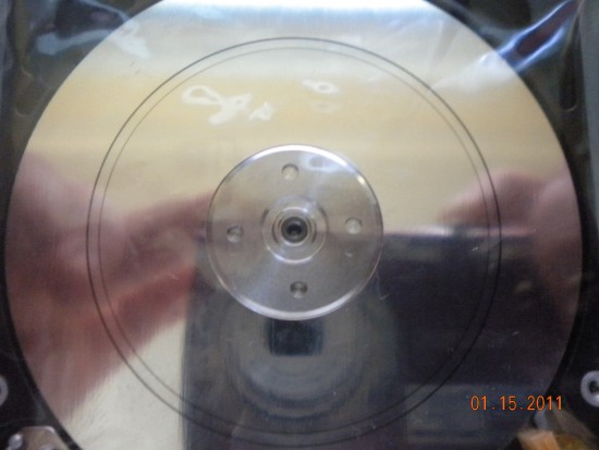

Hello. I have platters from a WD1200ve which have important data . I need to get the info off of them. Seems that the market has many more WD1200beve. Does anyone know how i can make sure I can install WD1200ve platters into a WD1200beve. Is there a website that I can go to which can verify if I can use the 1200beve for the 1200ve platters. when I do a search for the drive online i often see that the drive is sometimes labeled as a " WD1200ve / beve " ...... as if they are the same drive....... but if they are the same then why are they named differently. I hope to just find a new drive and swap in these platters I have. Thank you all so much.

Thanks for the info. But I really want to try this for myself. I did open the hard drive. So if a dust particle touches the platter .... ??? its ruined ??? or if there is a finger smudge ??? Some one told me to remove dust : use a can of air and to clean finger smudges use microfiber cloth. I know you all hate novices like me asking the wretched " does anybody know " questions , but Im interested in this field....and I want to learn about this stuff instead of just sending it off and paying someone. I love technology and how else am I supposed to learn. So back to my question >>>> I have two platters from a WD1200ve. Yes they have been exposed. Yes they are back inside the drive temporarily. I did see a dust particle or two on each and a very small finger smudge. besides that they are perfect. I am not new to working on electronics so i am eager to give this a shot. I am not naive about how delicate this surgery is. I know the read write heads are very touchy and everything must be done exact. I like the challenge. Like I said I have two platters.... I really would appreciate if someone could tell me if I should try this swap or not. Are platters totally shot cause of a couple of dust particles and a smudge. Thank you all for any help.

Have you removed the platters and then put them back in?

yes. i did.
 Post subject: Re: WD 1200ve / WD 1200beve
PostPosted: January 15th, 2011, 17:42
Sorry, then nobody can help you anymore. And not because of dust.
PostPosted: January 15th, 2011, 17:52
Posts: 505
Location: Bulgaria, Sofia
I will try to be as much polite as I can :D
First of all if you want to learn something do not do it using drive with important data. Buy thousand drives which are all one and same model and try to move platters. Then tell us or at least note how many of them you will be able to give you ID after you moved platters.We all begin from some point, do not think you will learn from a movie on youtube or vbox7 how to move heads or platters for half a day, or asking here. It's all about the practice. I have not hear an university or some other place to "produce" DR engineers, but here are lots of members which are really good in DR because they learn from their mistakes, but yes help is always appreciated when you got stuck. The fact you are not newbie in electronics does not mean nothing. For moving heads/platters you will have to "develop" your own tools or will have to buy already developed, and even you got tools "ready to use" you will need to know how to use them. Which return you to my first sentence.
So back to your questions. If drive has been "exposed" to dust and fingerprints. Everything should be cleared before you power up the drive, otherwise you or are at risk to make scratches, kill heads.... In a few words to make data unrecoverable.
If your platters are back to the original HDA temporary, which mean to me that they have been off already. Then you should start to think to use the platters as a mirror and HDA as ashtray.

The platters contain address marks that are syncronized
to each other. On MOST drives, these marks/signals are
recorded after the platters are secured in the drive housing.
Once you removed the platters, you misaligned these sync
marks. The marks are so small that re-aligning them is virtually
impossible.

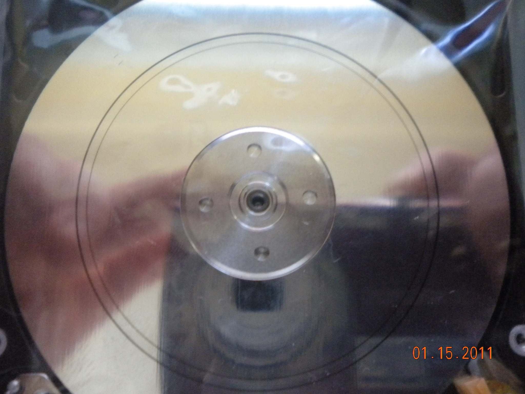

Man I love learning this stuff. I think Im getting addicted. All of you have been so cool. Some forum guys are such pricks. Regardless I do believe what you all say is true I have succesfully ruined these platters by removing them and putting them back. But none of this matters because the top platter has two perfect circles on it that initially I thought it was manufactured that way. But now after days of research I know that they are DEEP scratches........ never figured it to be scratches cause these circles look so precise and perfect. and when held up at an angle you could not see any sign of the scratch on the surface ( meaning no groove or damage could be seen on surface ) ..... only see it when you look down on it. I thought they were like segments or partitions at first. Im sure i have all you veterans scoffing and mocking my ignorance now. LOL !!!

You can still make a clock. No , 2 clocks.
