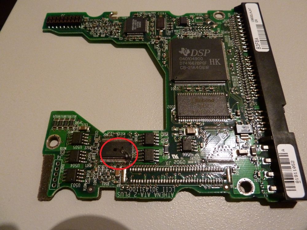

Hello everyone!

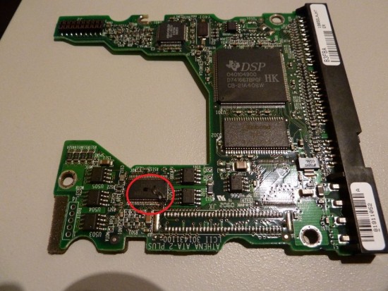

I have a problem with a HDD from the title (full info at the bottom of the post). During a power supply failure a PCB got burned (as seen on the picture). I managed to find a donor drive which is very similar, although not completely. The problem is that the donor drive is not working, too. When connected and powered on, it produces a beeping sound (alarm-like), which repeats in 10-20 seconds. I realized that the donor's PCB is missing a pin on IDE connector (pin 11, if I'm not mistaken). When I put the donor's PCB on the burned HDD, it has the same symptoms (alarm-like beeping). So, my questions are:
1. Why do these drives beep, because of the missing pin, or the PCB is faulty?
2. Are the two PCBs even compatible and swappable?
Info on the drive with a burned PCB:
Maxtor 541DX 20GB (K, M, B, A) 2B020H1110511
Model 2B020H1
HDA 11A
PCBA 05A
UNIQUE 11C
CODE WAH21PB0
PCB "code" B3FBA
Info on a donor drive:
Model 2B020H1
HDA 11A
PCBA 05A
UNIQUE 11A (the sticker is damaged so I can only read A, but I presume it's 11A)
CODE WAH21PB0
PCB "code" A5FBA
Thanks in advance. :)
File comment: Burned PCB

Replacement PCB is good, but it seems like your Preamp is gone also.

90 percent apparent fried preamp. 10 percent other problem . Should see the drive to sort out exactly .

Before condemning the preamp, I suggest you confirm that it isn't just a power supply problem. If your donor drive has a bad preamp, and if this has taken out its power supplies, then transferring the donor to the patient would be inconclusive. That is, a bad power supply on the donor may make the patient's preamp look bad, or worse still, it could damage it.
I can't see any switchmode DC-DC converters, but there is a Fairchild transistor (D205) near the bottom right corner of the SDRAM. I suspect that this is the pass transistor for a linear regulator.
There is also an 8-pin device (VR700?) above the TI DSP that appears to be a Voltage Regulator. Can you tell us its markings?
I would measure the resistances between each pin of the 18-pin preamp connector (J2) and each of +5V, +12V, ground, VR200, transistor D205, and the corner pins of the SDRAM. This should locate the supplies for the preamp.
After you have identified the preamp supplies, power up the donor board on its own, and measure the supply voltages at the preamp connector.

Here are two board layouts:
uploaded_images/6472_ATHENA_POKER_1.jpg
uploaded_images/6472_ATHENA_ATA2PLUS_1.jpg
Neither is an exact match for yours (where is the ROM?).
However, VR700/VR200 (?) appears to be an 8V linear regulator. Pin 8 is the input (+12V ?), pin 1 is the output.

As far as the board layout is concerned, there is a slight difference. The patient is manufactured in late 2002, and the donors in 2001/early 2002. The patient's PCB has a marking Athena ATA-2 Plus LCII 301431100, and the donors are Athena ATA-2 Plus FBII 301430100.
Here are the higher resolution pictures of the patient's and donor's PCBs, just for future reference.
Patient's PCB:
Donor's PCB:
Thanks again, if I manage to find another, I'll post the results.

The 78L08A regulator (VR200) provides the +8V supply for the preamp.
Confirm that pin 1 measures +8V, when loaded and unloaded.
