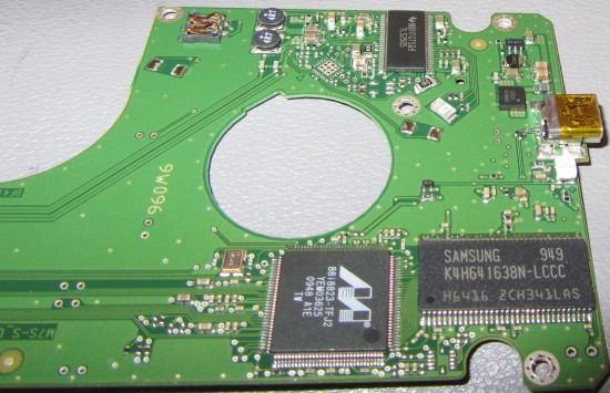

Upload a detailed photo of the PCB. If it's possible, I'll help you. It may even be as simple as a fuse.

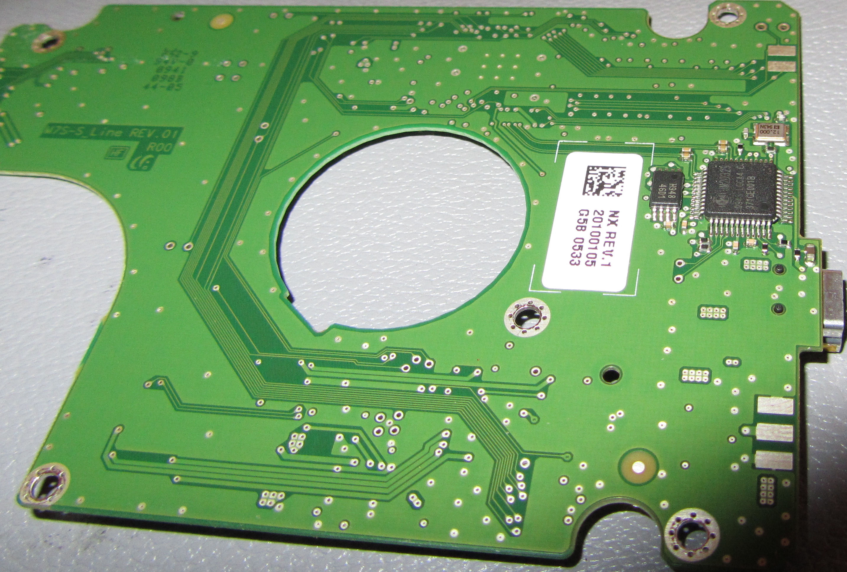

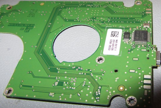

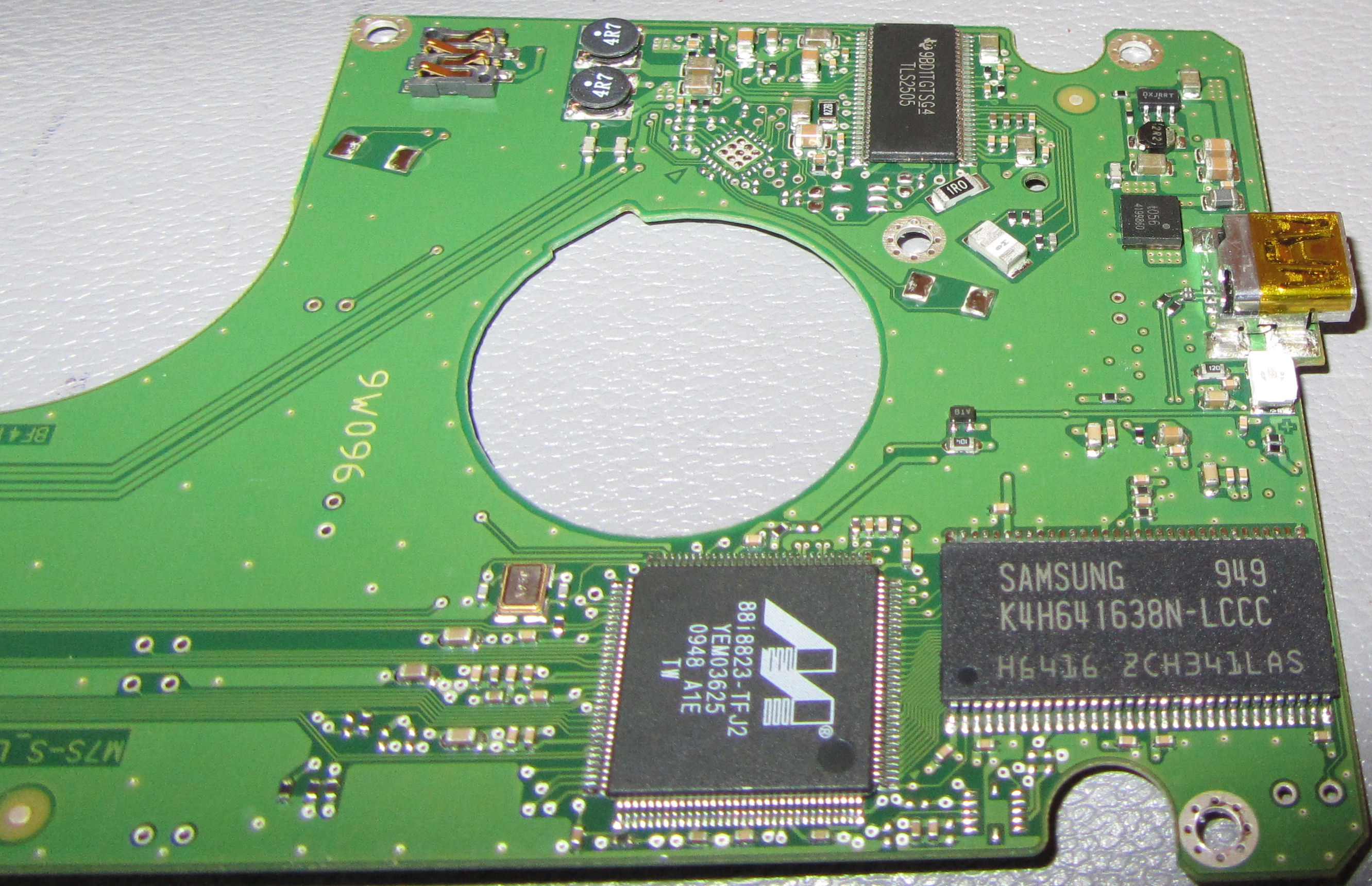

Hope these are clear enough - wasn't sure what size to upload!!
Don.
 Post subject: Re: Samsung 2.5 in 500gb Freecom XXS failed
PostPosted: January 18th, 2011, 21:27
Posts: 17232
Unfortunately the flash memory is internal to the Marvell 88i8823-TFJ2 MCU. This means that you will need professional data recovery services to transfer these data to the donor PCB. Alternatively you could try to narrow down the fault on your board.
The first thing to check is cable continuity at the USB socket. To this end I would plug in your USB cable and use a multimeter to test for continuity between the larger 4-pin host end of the cable, and the drive's 5-pin connection points on the PCB. A cheap multimeter should cost US$10.
Here are the USB pinouts:
http://pinouts.ru/Slots/USB_pinout.shtml
If the socket verifies OK, then power up the board on its own and measure the voltages at the "4" ends of each of the two 4R7 coils near the spindle motor connector. I expect that you should find +2.5V (Vio) and +1.2V (Vcore). There is also a 2R2 coil near the USB socket. Measure the voltage at its inboard (left) end.
There is a white device below the USB socket. Unfortunately I don't recognise it. :-(

Wow, thanks for taking the time to give so much assistance. I belled out the usb cable to 5 pins - no probs. Having bought a new drive the same was handy as I could make direct comparisons. Both boards have 5v arriving at the 5 pins. The white unidentified bit is a blue led that lights up for a few seconds when power is put on and then flashes with data transfer or error codes. It was on for the new board but not the old.
I followed the 5v and the new board had it at the left pin of the device above the 2R2 in the upper picture whereas the old board did not. I tried belling out all the nearby devices on both cards and testing where continuity was up to on the 5v. I kept measuring back at the left pin and the readings changed. I powered up the old board to measure the voltage again and the blue light came on! Worked again second time, so I mounted the board back on the drive. Up and running and frantically backing up!

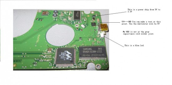

PostPosted: October 26th, 2011, 3:19
Joined: October 26th, 2011, 3:01
Location: China

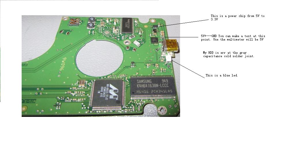

Hello Brother:
My freecom hard disk is the same with you.
One day it does not wrok. No reaction after plug into the PC.
So i search in the Internet. Then find your web.
But The mini USB pins are all right.So i had to find another way to repaire my baby Hard disk.
It cost me 100 doller.
But at last I repaired it by myself.
PostPosted: October 26th, 2011, 4:00
Posts: 17232
Nice work, floss.

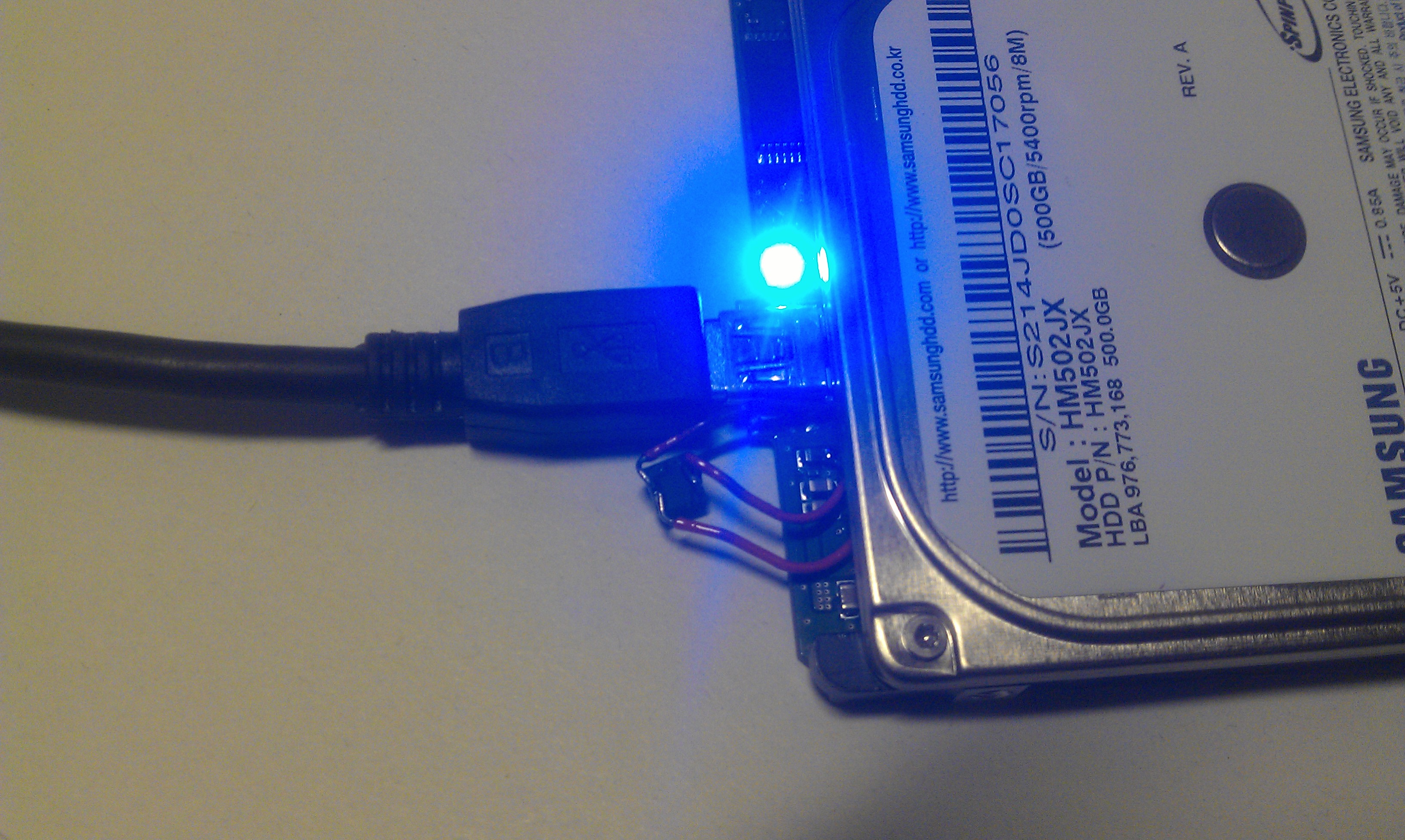

PostPosted: January 24th, 2014, 20:18
Joined: January 24th, 2014, 20:05
Location: nederland

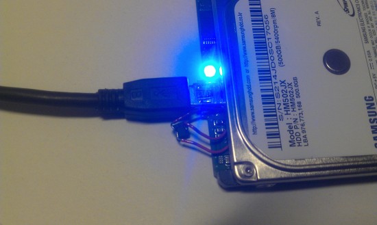

The usb-connector is tided fitting, so you need a bit force to connect.
in my case the voltage regulator was not right connected(soldered) on the pcb, so it came lose.
I re-solderer it, so I was able to take the data that was on it.
