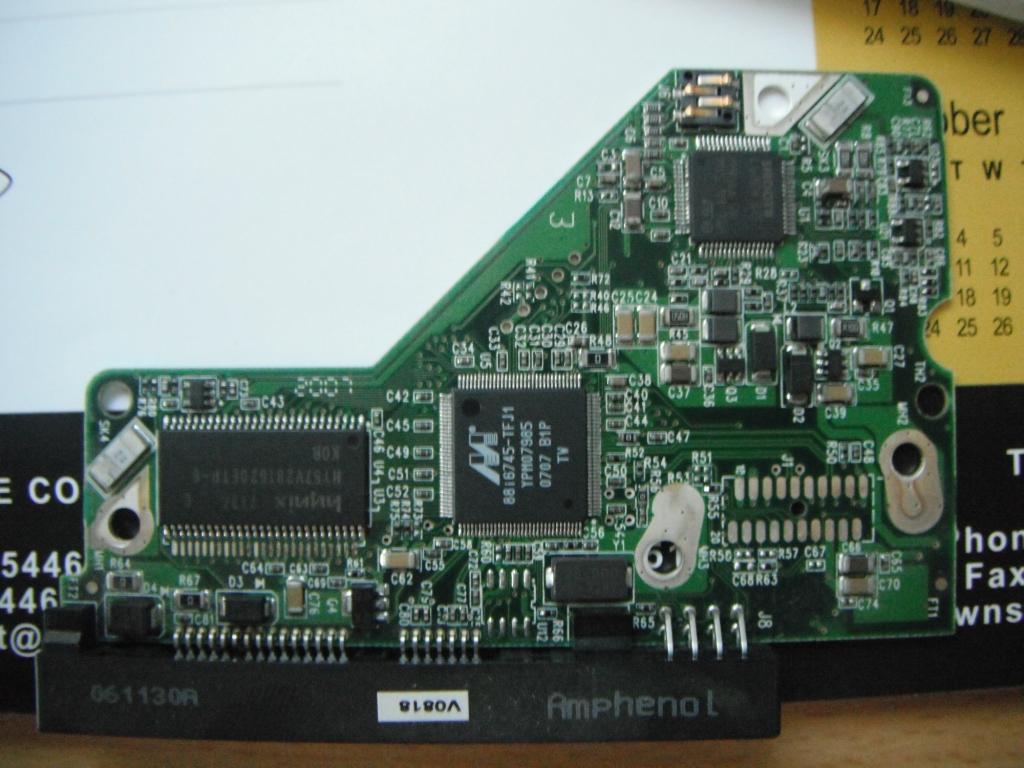

got me a screwdriver to check it out; as far as I can tell the only hint of damage past the power connector is very very slight tarnishing on the contacts around the chip on the bottom left of first photo.

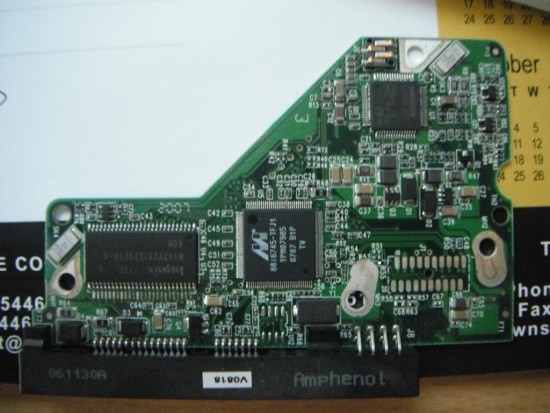

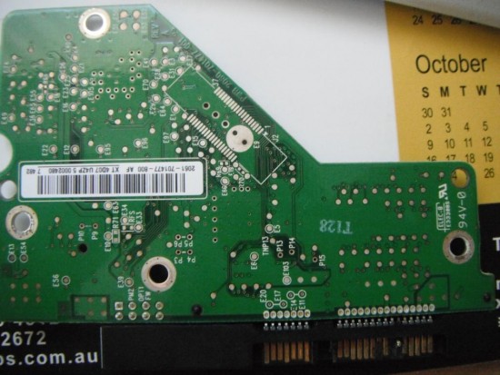

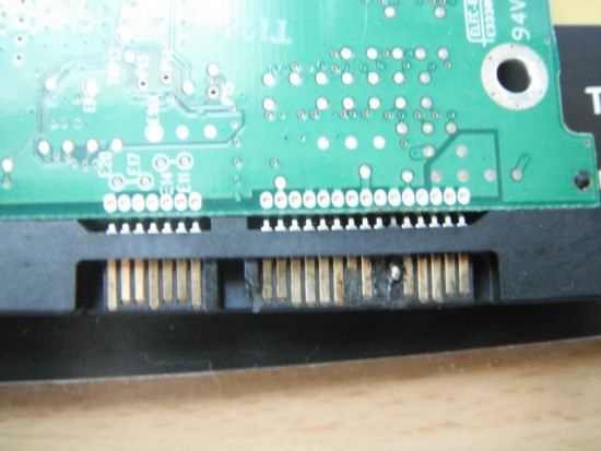

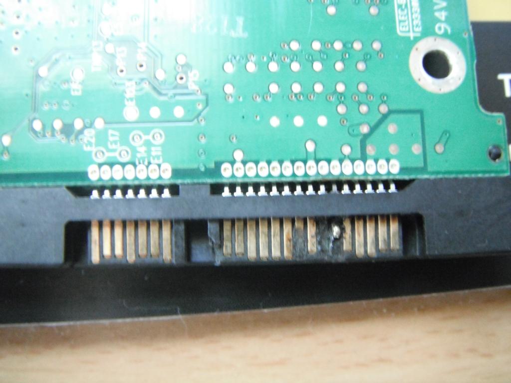

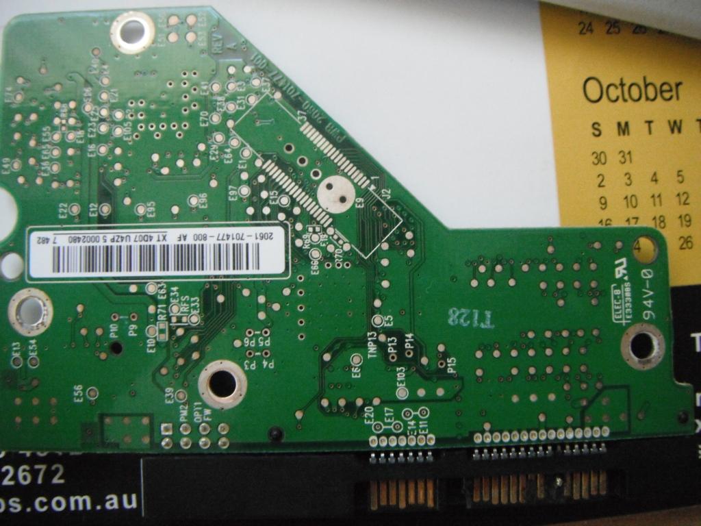

The 2nd and 3rd show the coupling
sorry just got cam, tried my hardest for a clear set of photos, seems to show enough detail though.

The damage has affected the +5V pins and and a adjacent ground pin. Most likely the drive sustained an overvoltage on the +5V supply, in which case I would expect that the 5V TVS diode (D3) would be shorted, and resistor R67 open.
Set your multimeter ($10 at Dick Smith Electronics or Jaycar) on the 200 ohms range and measure the resistances of both components.

I have a slightly different hypothesis from fzabkar so feel free to consider both, either one of them, or neither of them - your choice. He might be correct to suspect TVS, or I might be correct, or neither of us...
There's not enough detail of those pins in the photo for me to be sure - IMHO it would need some magnification and removal of shake :) However I am concerned that connector pin 10 is shorted to pin 9. There is certainly something very suspicious in that area of the photo IMHO, which looks like a whisker of metal.
My theory, based on what you said happened and the photos, is that you twisted the power cable while it was still attached to the drive, such that the pins 10 & 9 on the drive were shorted together (i.e. +5V to ground) by a pin on the power cable (probably pin 10), as the power cable was twisted. The plastic of the power connector itself appears damaged near pin 1, which is consistent with the possibility of lateral displacement / twisting of the power cable. I have experienced similar issues on other equipment with edge connectors, where the connector was not mated perpendicularly to the board :(
Therefore I'm not expecting TVS damage (no overvoltage) - but do carry out the measurements that fzabkar suggested; I could be wrong and he could be right. However if my theory is correct and there is a short on the SATA power connector itself, then the TVS may appear to be shorted when, in fact, it isn't.
Whatever the state of the TVS, that SATA power connector needs attention, or removal / replacement / bypassing, before you next apply power to that drive. There are several options for what to do at that point, depending on what exactly is wrong on closer examination, and on your soldering skills / tools availability / component availability / time availability / risk assesment :)
I also suggest you look at the power cable which was connected to that drive, when you knocked the cable - do you see any damage to the contacts inside the cable connector which was attached to the drive? You may need a torch & loupe etc. In any case, based on the damage to the drive's power connector, IMHO you must not use that power cable again, as it cannot be trusted.
