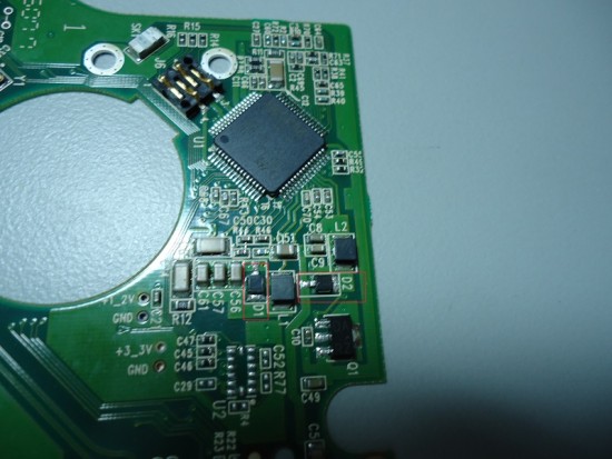

Hello everyone, I have a scorpio drive that I am trying to figure out. The drive will not spin up
at all. A few things that I have checked are...
Checked for power at what looks to be test points on the bottom side of the board
they are labeled as 1.2, 3.3 and 2 grounds. They all appear to be ok. I also checked for power at
the spindle motor connections...No power there.

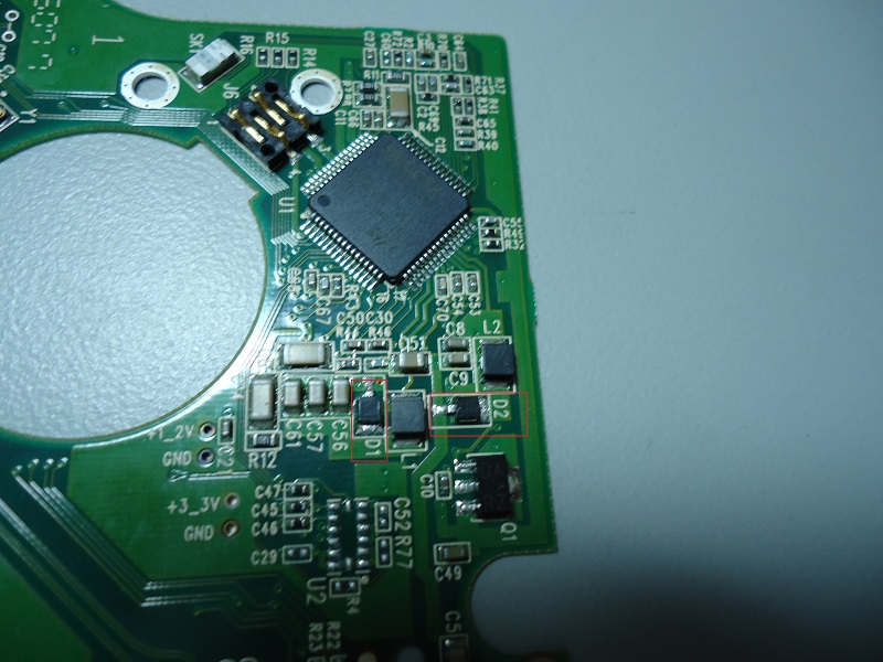

Just reading through the forums I tried to see if maybe I am having a diode issue of some sort.
D1 and D2 came up with different results.
D1 resistance is 75ohms and 116ohms reversed
diode test with dmm is .062 with continuity one way .106 no continuity the other way
D2 resistance is 1.6K ohms one way and 7.4K reversed.
diode test with dmm is 1.96 one way and .171 the other no continuity either way
I attached an image of the board I am looking at. Any suggestions would be greatly appreciated.

The +1.2V and +3.3V supplies are probably the Vcore and Vio supplies for the MCU and SDRAM. These are controlled by the motor controller combo IC at U1. L2/D2 and L1/D1 appear to be the inductors and Schottky flywheel diodes (not TVS diodes) for two switchmode DC-DC converters. One supply should be the Vcore, the other will be the Vio. To determine which is which, test for continuity between the inductors and the test points. Obviously both diodes are OK.
I'd also measure the voltages on each of the pins of transistor Q1, and I'd also probe the voltages at the preamp connector. The pins with the heavier traces should be the preamp supply pins, and the two ends of the voice coil.
Is the drive identified by your BIOS? If so, then it could be that your drive is configured to Power Up In Standby (PUIS). PUIS can be enabled either via an ATA command, or via a PM2 jumper.

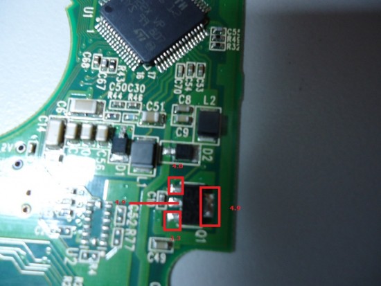

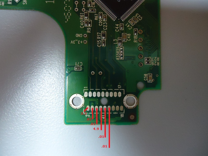

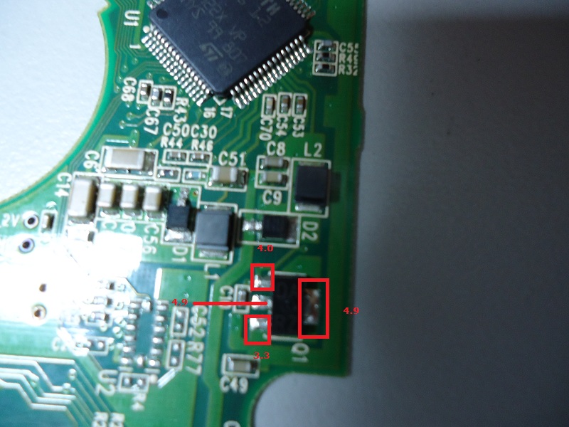

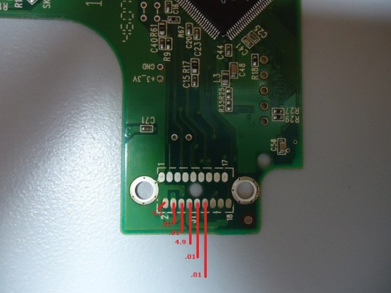

I measured Q1 and what I thought were the right pins for the preamp.

Q1 appears to be the pass transistor for a +3.3V linear regulator. The SDRAM is a 3.3V device, as is the vacant flash memory location at U12.
One of the two switchmode regulators, either L1/D1 or L2/D2 (probably L1/D1), supplies the +1.2V for the MCU's Vcore. A resistance check from a 1.2V test point to L1 and L2 should identify the relevant regulator.
I suspect that the remaining switchmode supply would be the negative rail for the preamp. However, your preamp voltage measurements don't show any negative supply, so maybe I'm wrong, or maybe there is a genuine fault.
With power removed, I'd test for continuity between the +3.3V test point and each of the preamp pins. I'd also test for continuity between the preamp pads and each of L2 and D2, or L1 and D1.
You could also compare the voltages against your replacement board.
