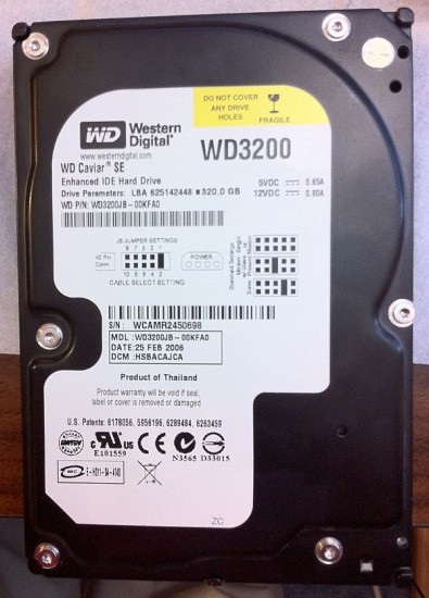

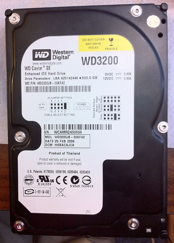

My drive has the number 2061-701314-A00 on a sticker on the IDE header. Is this number the one I should use to find a donor board?

This supplier offers a PCB, including firmware transfer, for US$70:
http://www.hdd-parts.com/10021173.html
