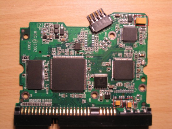

Here is a picture of my PCB, I don't see any damage. If my HDD still has no power (disc doesn't spin), is the PCB still the culprit?
Thank you.

 Post subject: Re: WD800BB No power - New PCB? :(
PostPosted: January 18th, 2011, 22:17
Posts: 17335
The motor connector has a blister which suggests overheating. Examine the underside of the board for any scorch marks in that area. Other than that, there appears to be no visible damage.

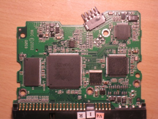

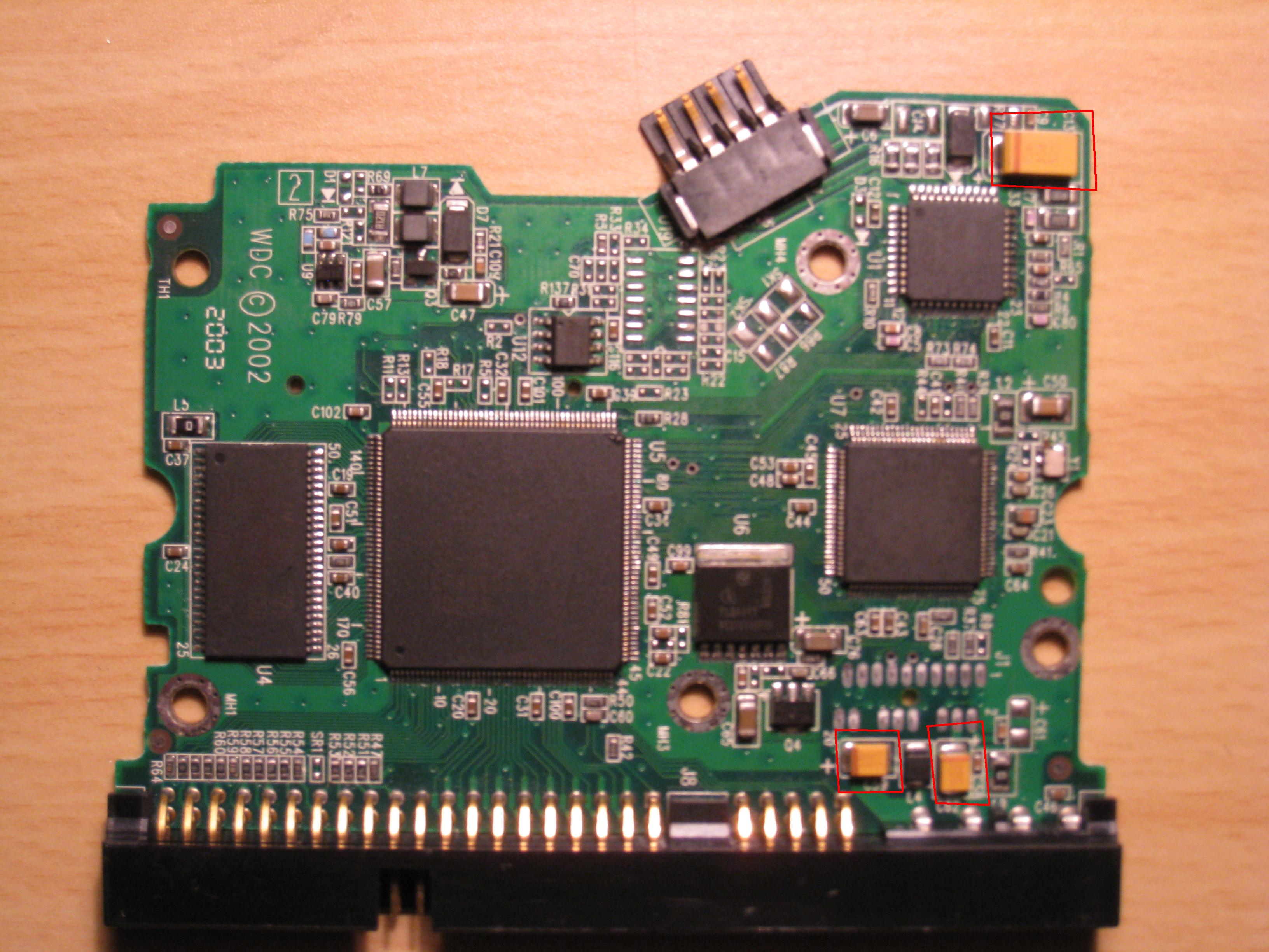

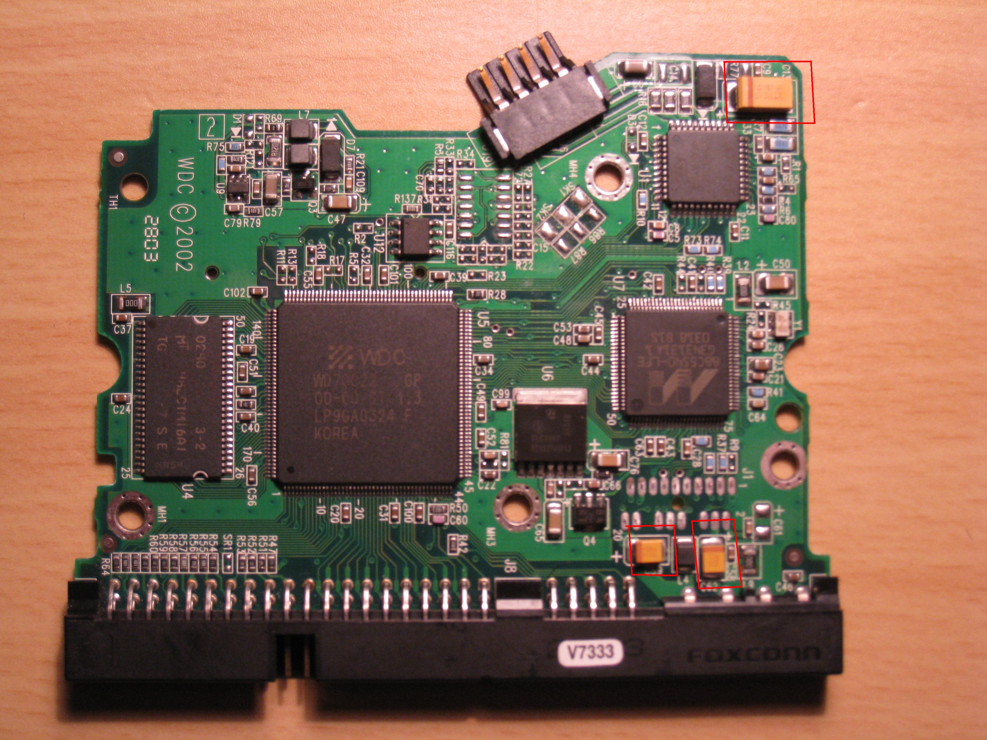

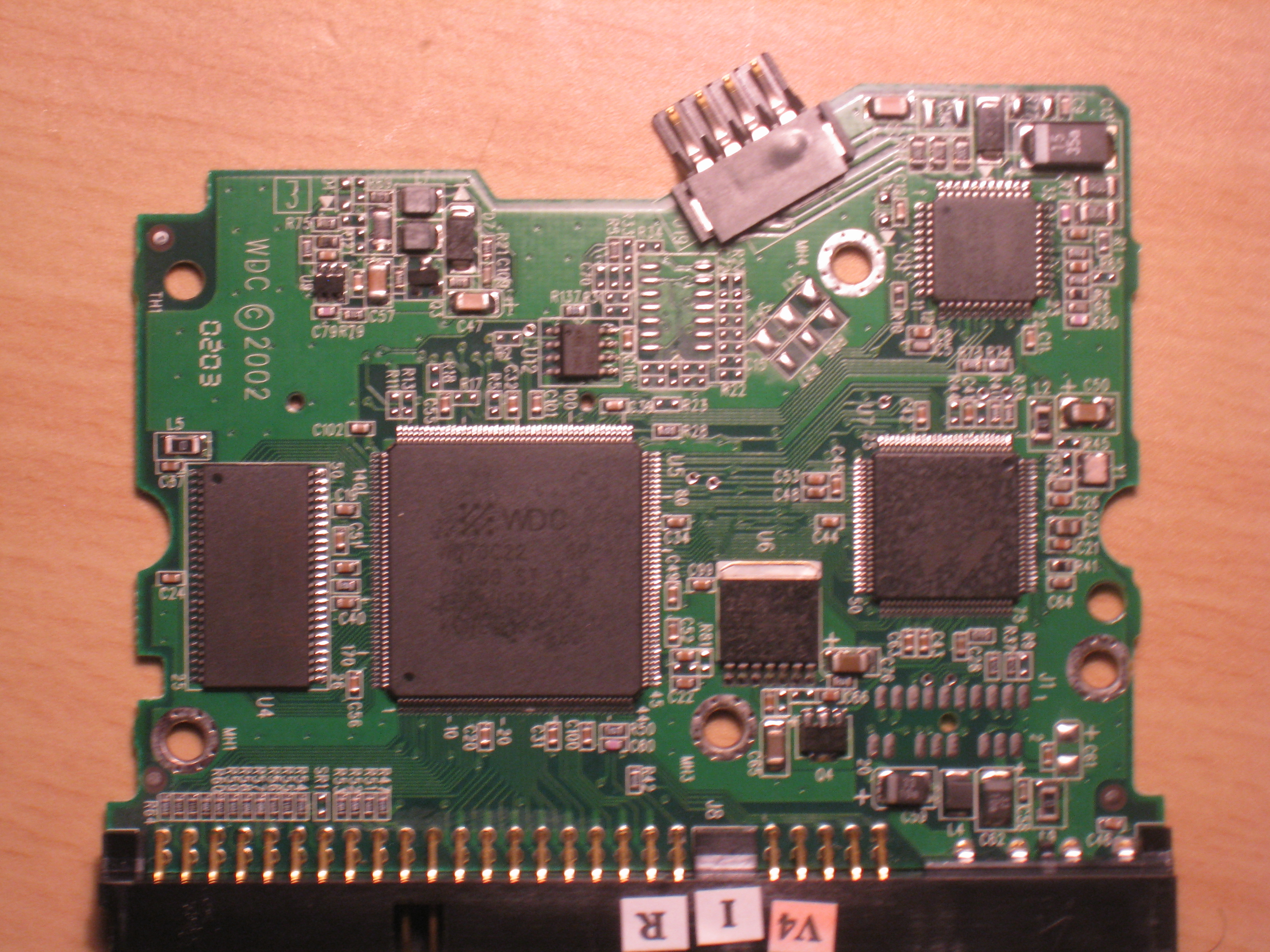

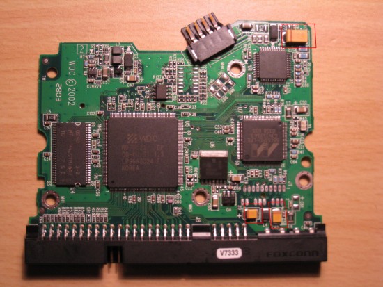

I have received both PCB's. The HDD now has power, but makes a clicking noise and freezes on the bios screen stating "Detecting IDE Drives". I've tried both PCB's that I have received and both have the same result - clicking noise. I believe I need to transfer the U12 ROM chip, but which PCB should I transfer it to?
I will list the details of all PCB's below - Main Controller Chip:
*If you look at the pictures of the two new PCB's below, you'll notice that they have slight physical differences when compared to the old PCB(pictured above). Is this a concern? I have circled the differences for your convenience.
Old PCB:
WD 70C22 GP
00-00 ST 1.3
LP9AU0304 F
New PCB #1:
WD 70C22 GP
00-00 ST 1.3
LP9GA0324 F
New PCB #2:
WD 70C22 GP
00-00 ST 1.3
LP9DV0313 F
Thank you for the help! :)
