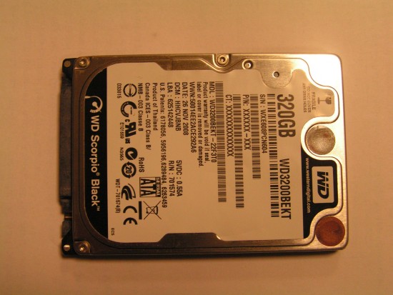

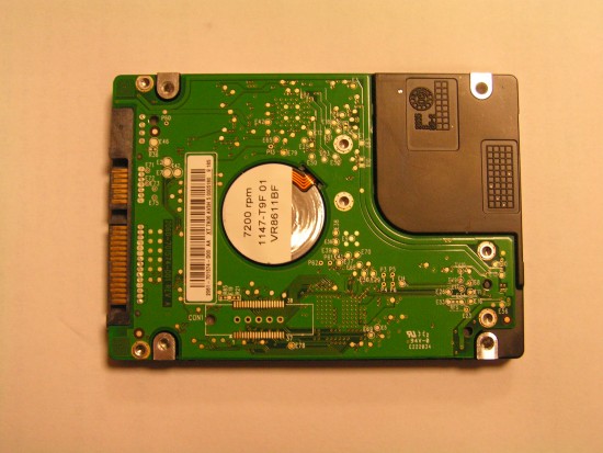

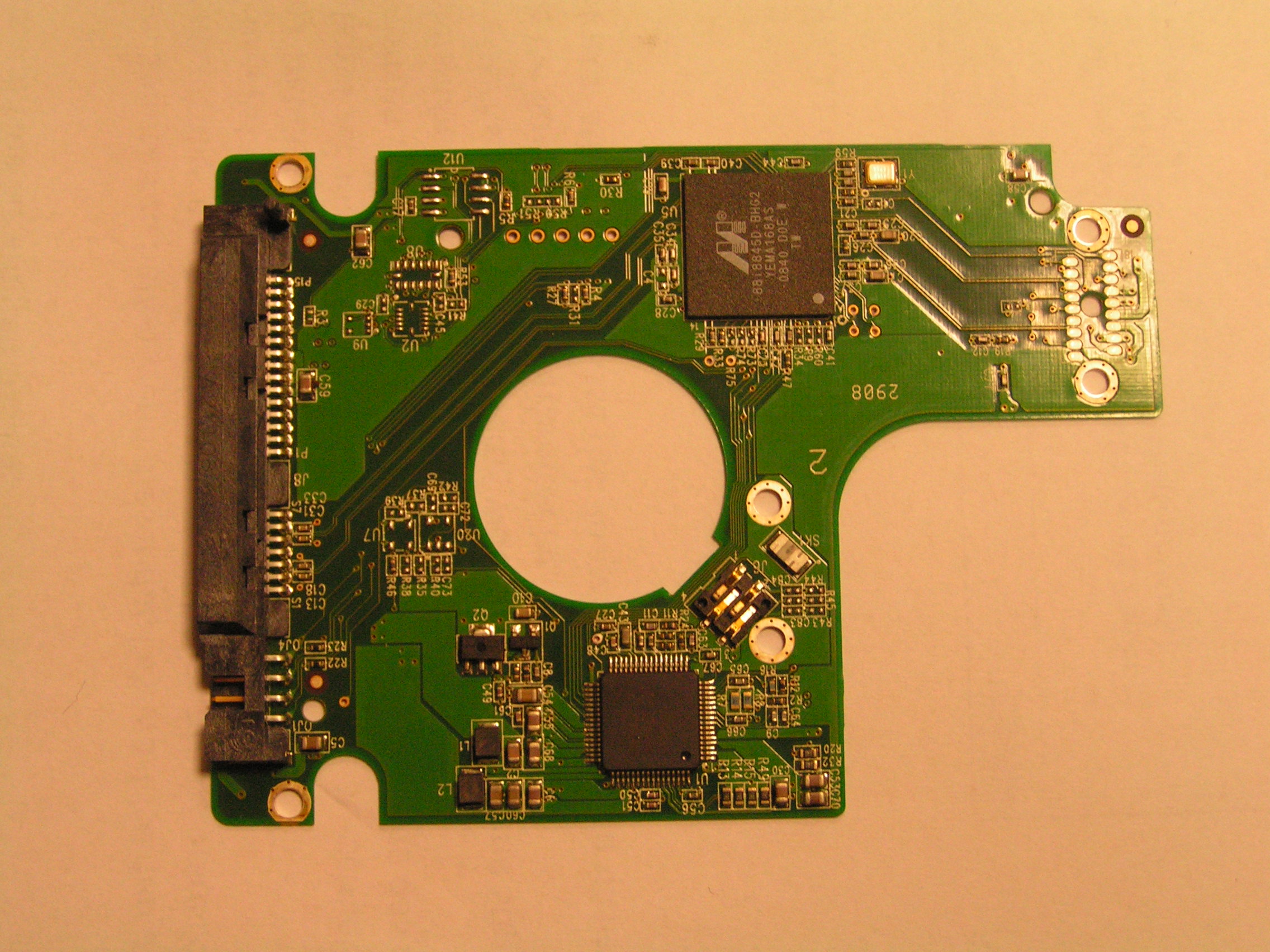

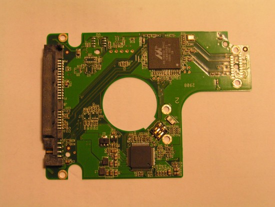

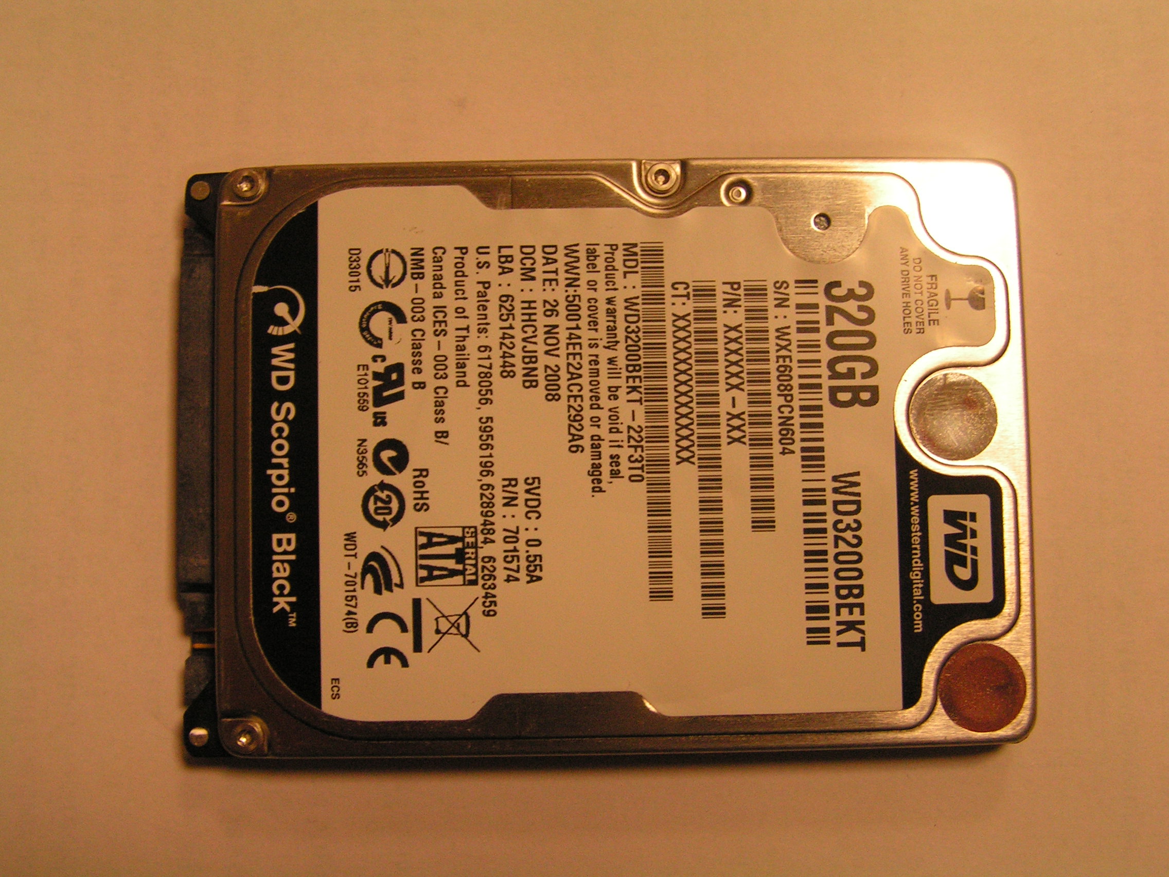

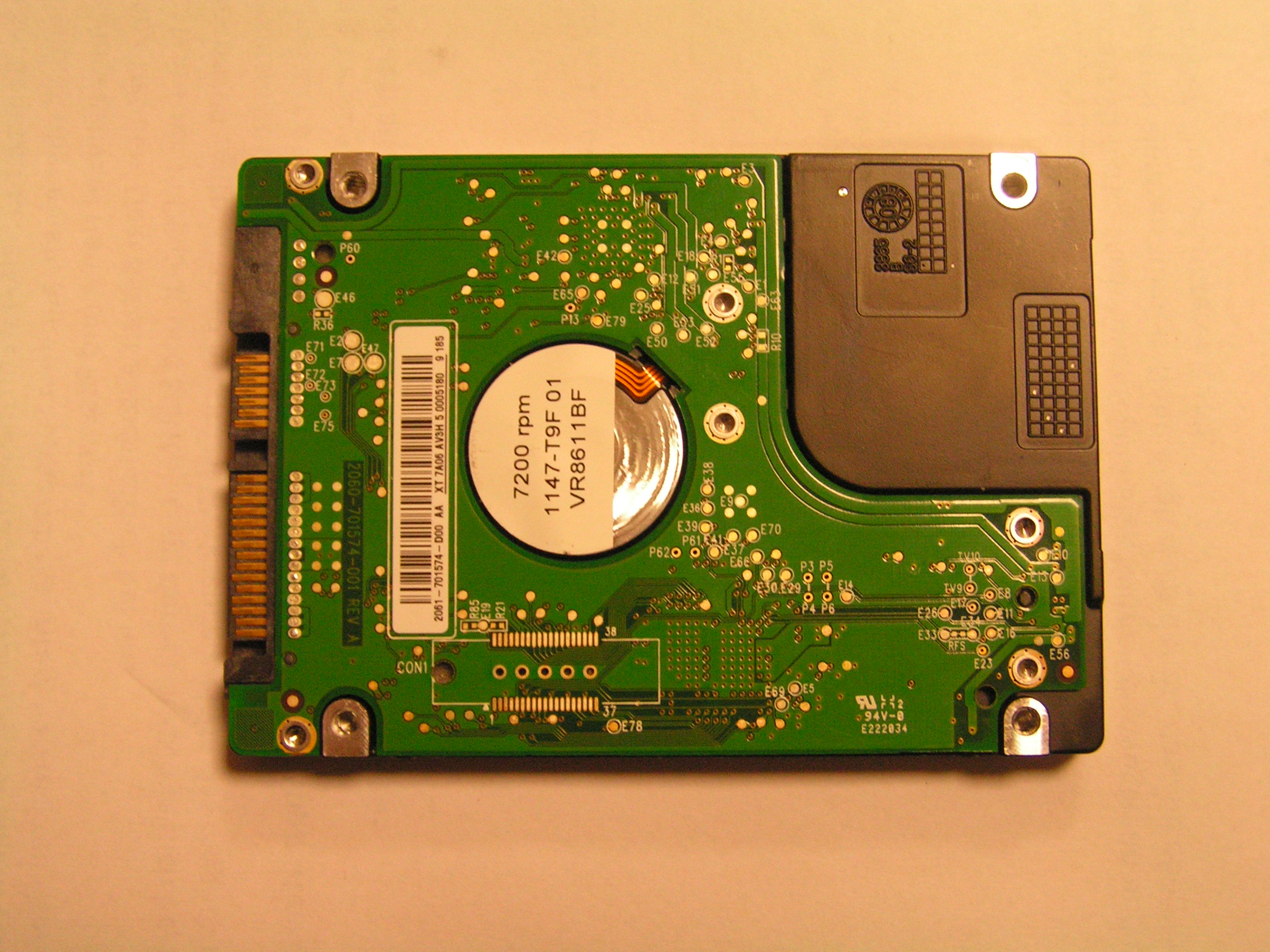

Hello everybody,
after connecting the HDD to an external adapter for the purpose of taking an image it failed to start up. I believe it might have suffered an overvoltage. On connecting the power adapter the Marvell MCU and the TI spindle motor controller get very hot, the motor doesn't spin at all.
Does anybody have experience with this disk model? Unfortunately I can't identify anything that acts as a fuse on the circuit (no TVS diodes) :(. Any hints as what to measure with a multimeter or oscilloscope, maybe in comparison to an identical model?
MDL: WD3200BEKT - 22F3T0
Date: 26th Nov. 2008
DCM: HHCVJBNB
PCB: 2060-701574-001 REV A
Thanks for any help and guidance in advance!

The Marvell MCU stores unique, drive specific data in its internal flash memory (the vacant location at U12 is reserved for an external serial flash). This means that a board swap is not a DIY option.
The first thing to check is whether the USB adapter is delivering +5V to pins 7,8,9 of the SATA power plug in your cable.
If the +12V supply was applied to the +5V pins, then the motor controller is most liekly dead, in which case the MCU has most probably been overvolted by faulty DC-DC converters internal to the motor controller.
With power removed from the board, set you meter to the 200 oms range and measure the resistance between SATA power ground and each of L1 and L2. I expect that these inductors will be part of the Vcore and Vio supplies for the MCU, or maybe the supply for the preamp.
Also measure the resistance between ground and each of the pins of transistor Q2. I suspect this may be a linear regulator.
BTW, the fact that both chips are getting hot suggests that the board has no protection devices.
Gnd to L1: 10.8 Ohm
Gnd to L2: 44.6 Ohm
Yes, the SOT223 casing suggests it might be one? BTW the imprint on it is AEQH. The measurements from top view of the SMD:
Top: 643 Ohm
Bottom (from left to right): 1017, 643, 10.8 Ohm

AIUI, swapping PCBs is safe for WD drives, but Hitachi drives, for example, may overwrite their NVRAM. If your drive spins up with a replacement board, this will at least give you some confidence in the motor and HDA, but the most likely outcome will be that it will click and not give you access to your data.
Q2 appears to be the pass transistor in a linear regulator. Hard drives often use linear regulators for low current supplies, and switchmode converters for the higher current ones such as Vcore.
The load resistances on L1, L2, and Q2 appear low to me, but at least they're not dead shorts. I don't know if 10.8 ohms is normal, though. Perhaps you could compare that with a replacement board. A replacement board would also allow you to measure the actual working voltages at those components.
The vacant location at U12 is wired for a serial flash memory. You could measure the resistance between pins 4 and 8 (lower left and upper right). This will tell you whether its supply rail is shorted. You could also test for continuity between pin 8 and each of L1, L2, and Q2. This will identify its power source.
