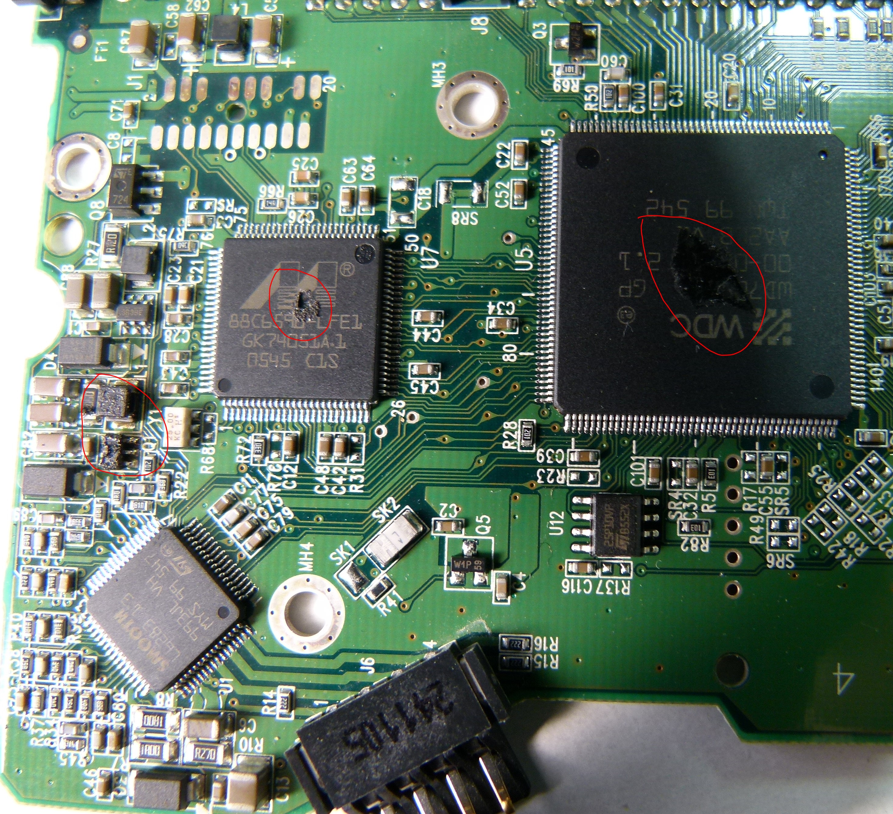

I try to use this disk with ATA-to-USB cable and power adapter. When turn on the power disk initially runs but then the adapter blow out and the disk too. The disk smells suspicious and when I remove PCB, there are some burned parts (U5, U7, Q1 and L1) as cen be seen on attached picture.
My HDD MDL is WD1600JB-00GVC0
DCM: HSBANT2CA
PCB label is 2061-701265-200AL.
I bought donor PCB (not HDD) with the same first part of the label, but the secont part differs after XC 1X68.
I have replaced PCBs and turn on the disk, but the heads just clicks and nothing hapened. May be I have to replace U12? Or pre-amp inside HDD is damaged too? If yes, what DCM donor HDD I have to look for?
 Post subject: Re: WD1600JB - needs PCB replace
PostPosted: December 12th, 2010, 5:21
Move U12.
If it still clicks then you have bad preamp (which is quite likely by the extent of the burning)

Wow! Thanks to God, all data was restored and moved to a new disk! The drive revived after replacing U12. Now I can try to revive my other two died disks... :D
