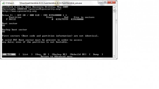

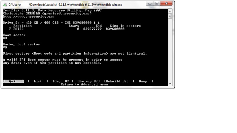

I have a problem which appears to be a little bit beyond me. And I thought I'd buzz you guys for some help.
Here's what the issue is -
I have a 500 GB Seagate Freeagent disk, which I encrypted on Windows XP using TrueCrypt 6.0. A hidden volume (400 GB) was created underneath the outer volume. The filesystem was FAT32.
All of a sudden, for no obvious reason, the hidden volume is not accessible. TrueCrypt (7.0a) does mount it but there's a message which says that Windows XP does not recognize the filesystem. Data in the outer volume is still accessible. The hard disk also appears to be working within normal heating / sound limits.
I then tried to fix this using Testdisk 6.11. I followed instructions and rebuilt the boot sector. However that has not fixed the problem :shock: . Now the message that I get on mounting this volume is somewhat different. It says that the filesystem is corrupted and cannot be read. When I run Testdisk, it says that the boot sector is ok but that the first sectors are not identical :?: . A screenshot is attached.
Testdisk's log file shows pretty much all the top-level directories which were present in the volume before. So I'm keeping my fingers crossed and hope the data can be set right.
So how can I fix this thing? I'd really appreciate it if someone could please help. You'd have a fan for life.

This is still open. If any one knows what this Testdisk screen shot implies and how the issue can be fixed, please do let me know. Thanks!

Have you tried selecting "Intel/PC Partition" rather than "Auto", after editing the CHS values?

I don't understand why TestDisk's log is showing that the partition type is automatically detected as None, whereas TestDisk complains that the information in the boot sector and partition table are different.
"First sectors (Boot code and partition information) are not identical."
Perhaps you could contact the author. Apparently he is very interested in feedback.
I would examine the file system a little more before doing anything. Try comparing sectors 49 and 51293. They should be identical. Then compare the appearance of these known good FAT sectors with the problematic ones. This may tell you which FAT is the likely culprit.
If you do decide to patch the FAT sectors, I suggest you leave the partition table empty.
Have you tried any other data recovery software?
One more thing. TestDisk's log states that ...
"A valid FAT Boot sector must be present in order to access
any data; even if the partition is not bootable."
I can't see anything that is invalid about the boot sector. TestDisk also appears happy with it.
Boot sector
OK
Backup boot sector
OK
The only thing that is different is that the volume name is encrypted, and the first two bytes (EB 32C) don't make sense. Normally these two bytes constitute a JMP instruction which jumps around the data in the Boot Parameter Block and ends up in the code area. However TrueCrypt's JMP instruction points to offset 0x3E which is in the BPB. While this is odd, it has no bearing on your problem (since the volume is not bootable).
