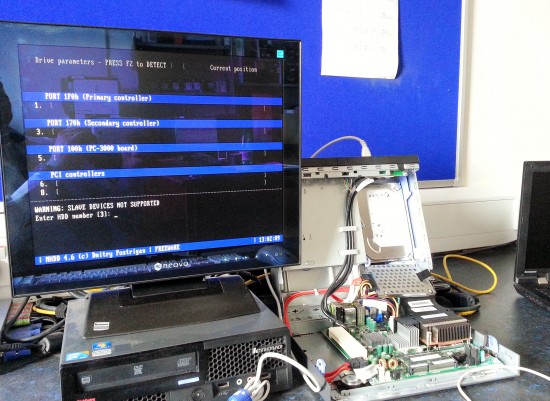

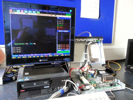

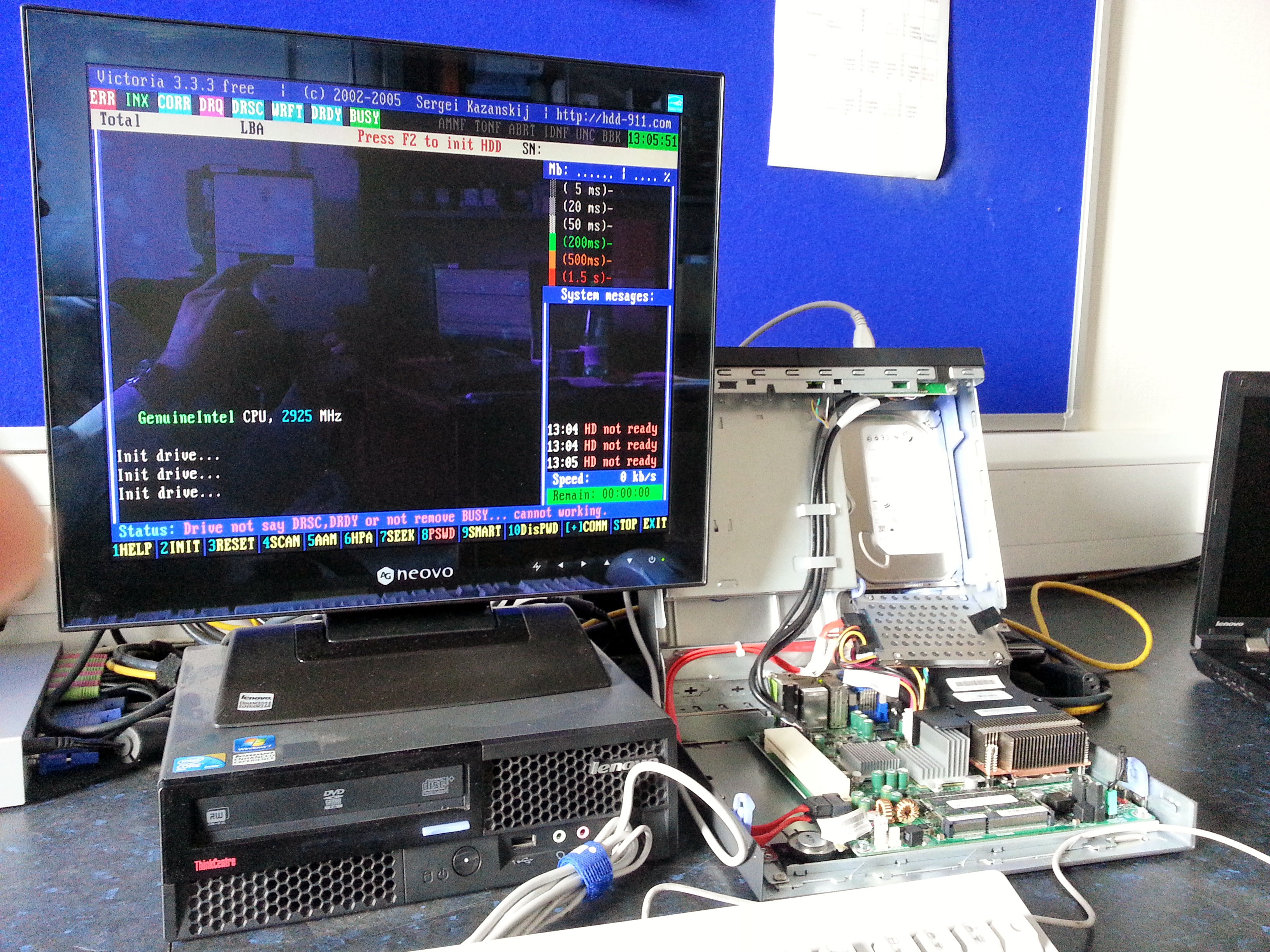

Hi
I hope someone can help me with removing unknown ATA password from a Seagate ST9320423AS. I don't need any data on the HDD, just want to be able to re-use it. I work in a school and somehow a student managed to set a password for the HDD. The laptop is a Lenovo Thinkpad L412. On this laptop you cannot even get to bios settings or boot without entering the HDD password. I tried booting HIRENS with the HDD disconnected and then to plug it in after boot, but MHDD doesn't detect the HDD. Also tried the HDD on another PC as a secondary HDD. I am still prompted for the password, but I can skip it. It then says the HDD is locked. MHDD or Victoria doesn't detect the HDD. Any hope, or can I just throw the HDD to the bin ?
I already threw 3 other HDD's with the same problem in the past, but is getting silly now. That is another story thou...

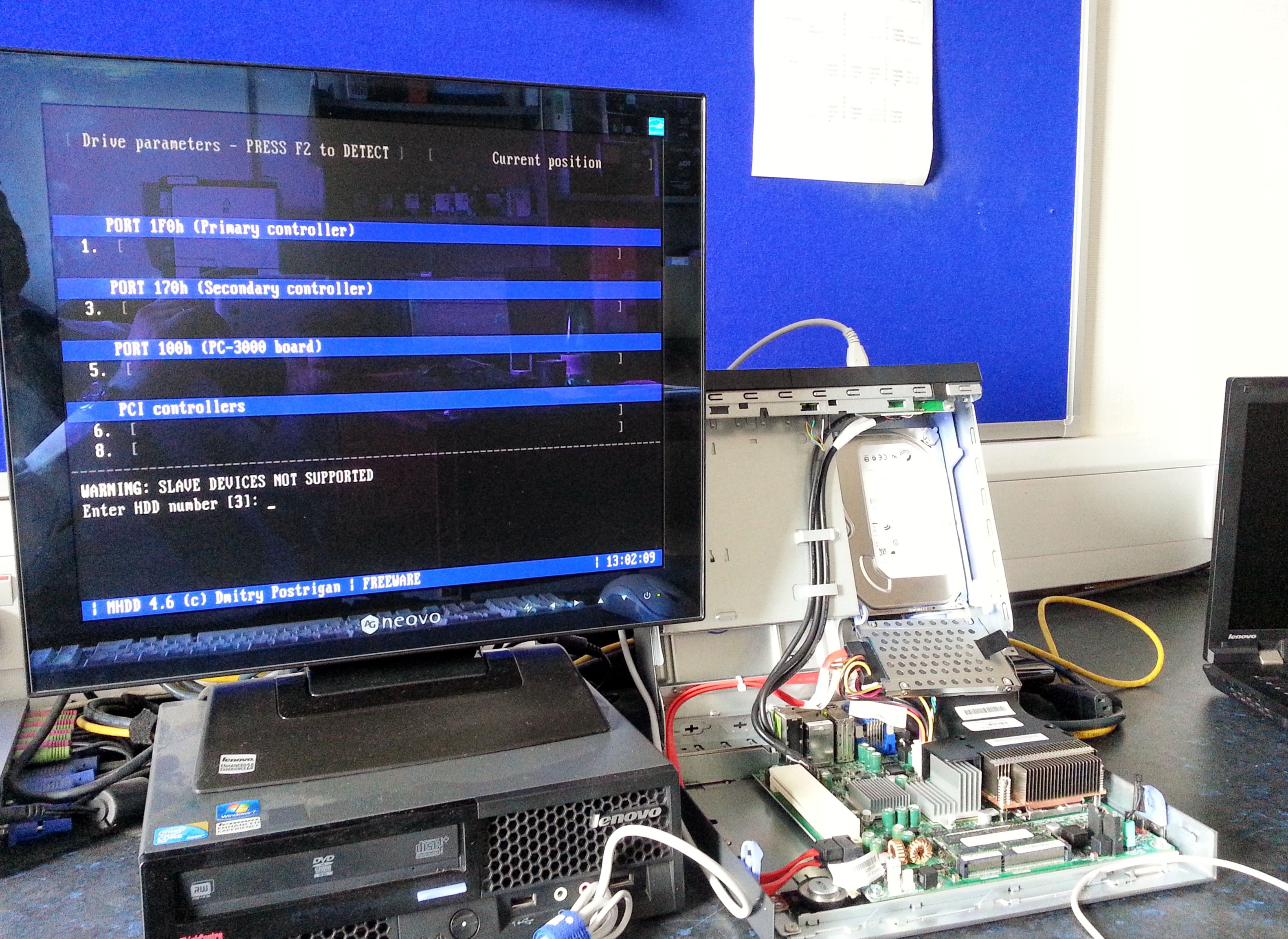

Made a little bit of progress. Disabled AHCI in BIOS and I can now see the HDD in Mhdd
EID command returns something like this:
ST9320423AS LBA:625,142,448 BIOS: 81H
SN: 5VH54960 FW: 0003LVM1 CACHE: 16384Kb
SUPPORTS: LBA48 HPA DLMC LBA MS16 DMA (UDMA5, MWDMA2)
SMART: ENABLED SELFTEST: SUPPORTED ERRORLOG: SUPPORTED
SECURITY: MAX, ON SIZE = 305245MB
WARNING: THIS DRIVE IS LOCKED BY ATA PASSWORD
Still need some guidance from here.
