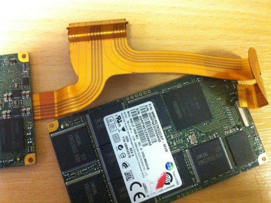

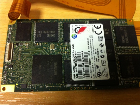

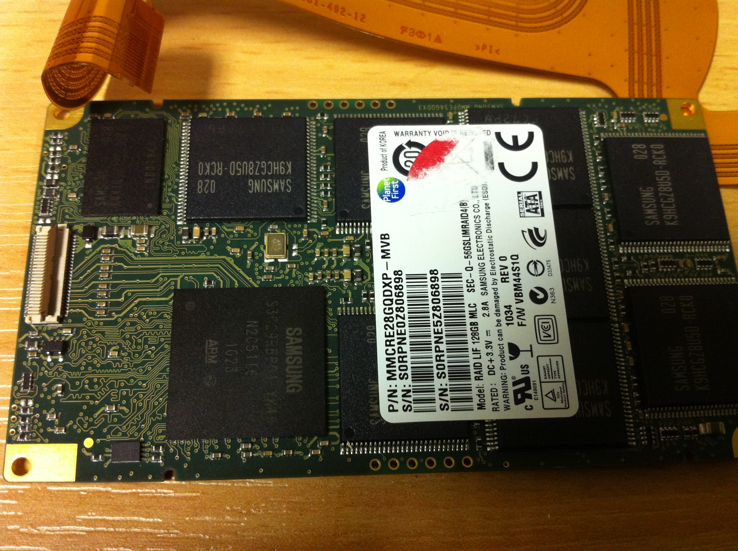

Does anyone know how to connect this customised made LIF interface to a normal SATA/IDE/USB?
This LIF interface is slightly wider than the LIF used in the SSD of MAC book Air.
Model: RAID LIF 128GB MLC
It is from a Sony laptop.
File comment: Samsung SSD

The answer is in your ribbon cable

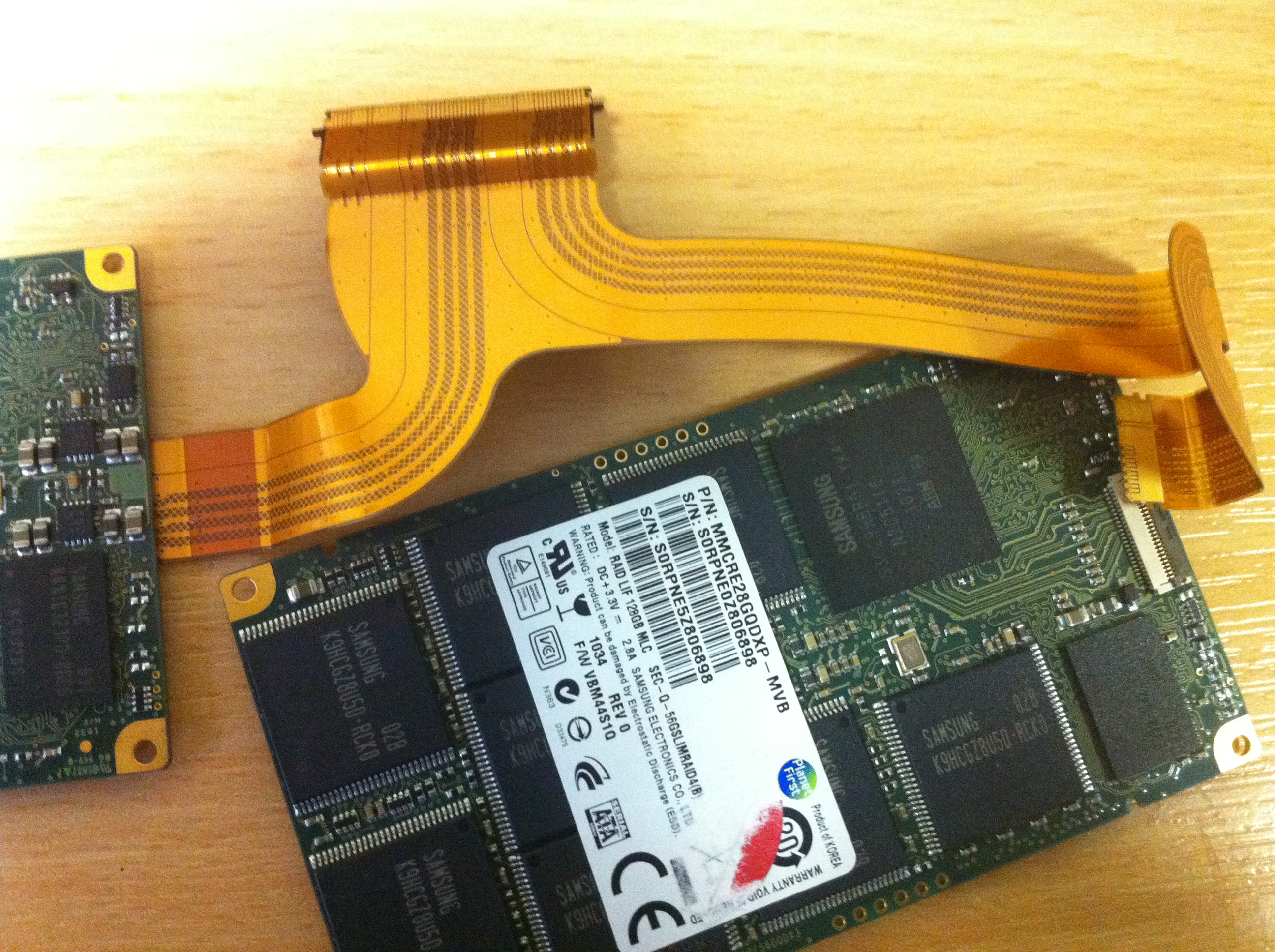

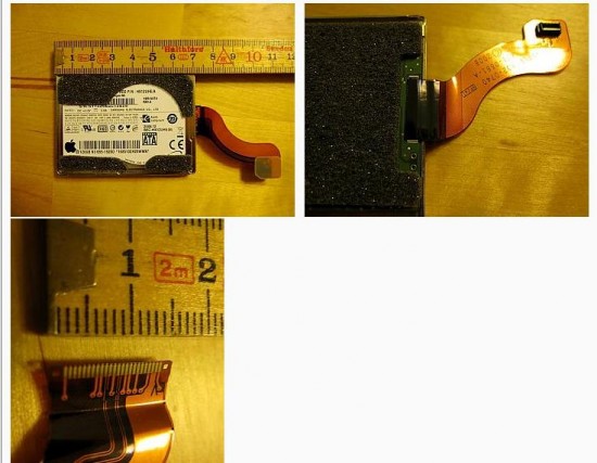

The ribbon cable is used to connect to two SSD drives and the motherboard of the laptop. They are not in a standard LIF size. It is impossible to use this cable for DR purpose.

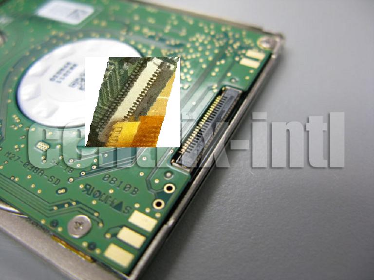

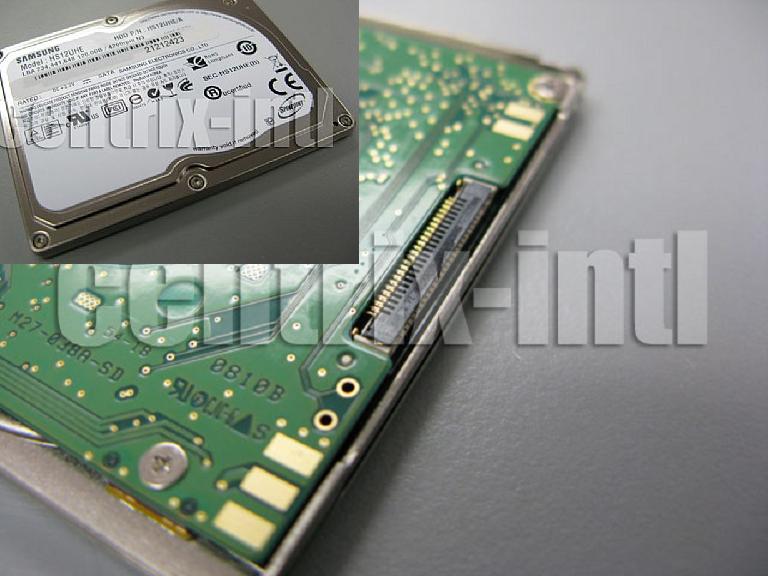

tckin wrote:

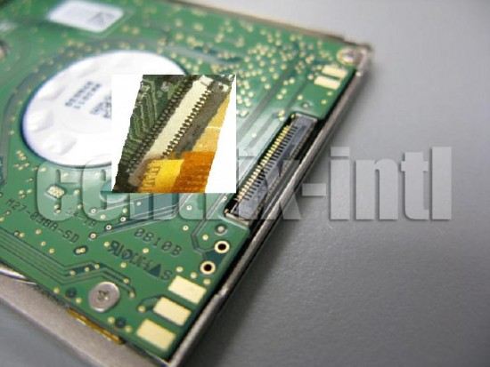

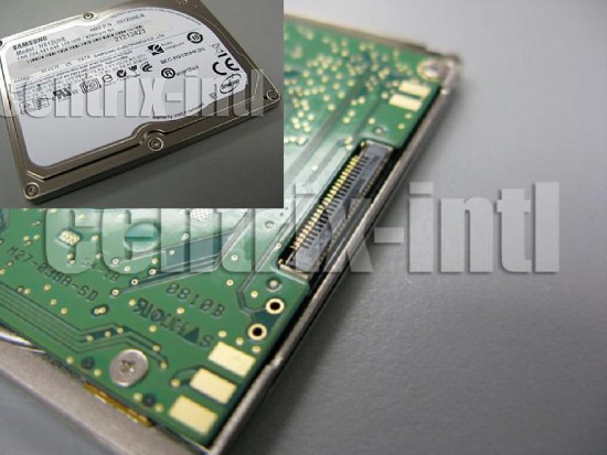

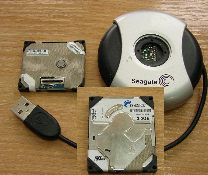

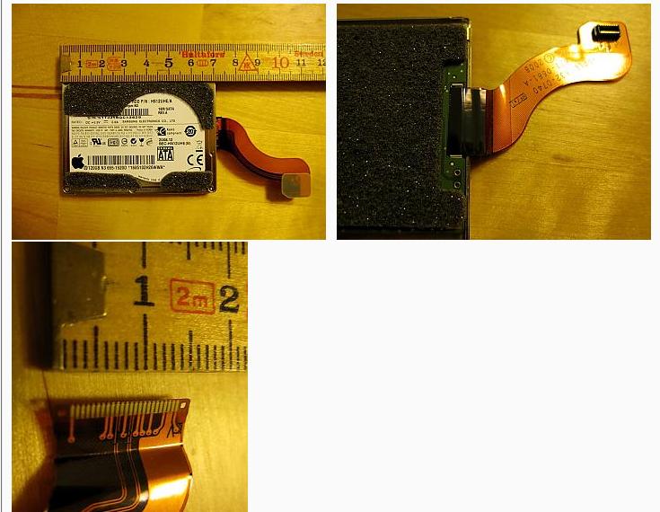

As for me, usual Lif interface . Has it 24 pins like samsung HS12UHE?
Or 20 pins like 1" seagates?
Angel Data Recovery

Joined: February 4th, 2010, 12:39
Posts: 13

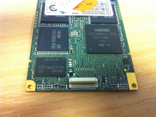

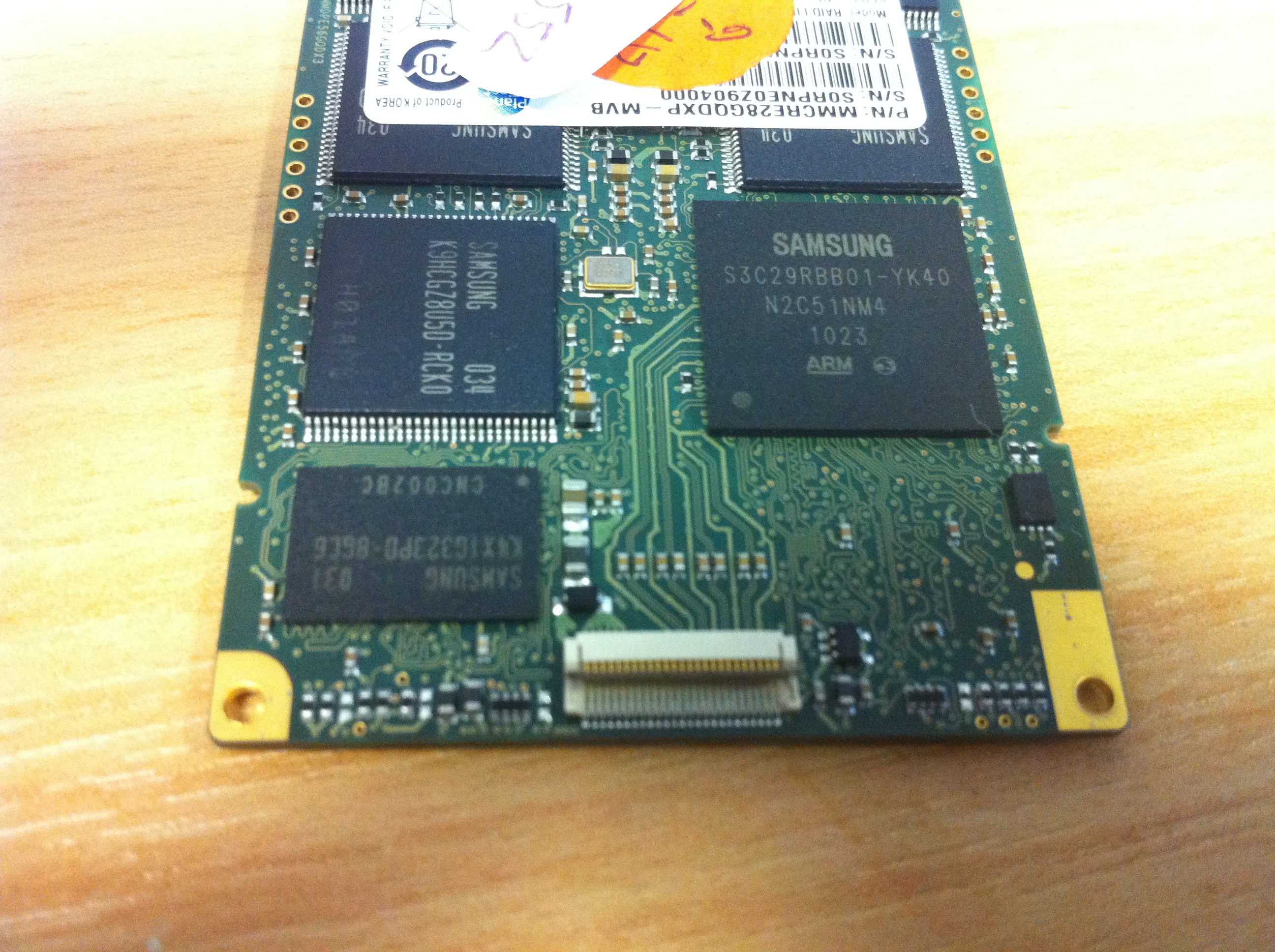

It is a 25pins (width=1.1cm) interface on the SSD drive.
It has double layer. On the other side of it, there is another controller and 8 memory chips.
They share one output interface, as shown.

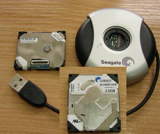

It seems to me this was wrote before:
Check pinouts:
There are 24 pins on the 1.8 sata-LIF connector.
Pin 2,3 : 3.3V
Pin 8: DAS (Device Active Signal)
Pin 11,12: A+ /A- Differential Signal Pair A
Pin 14,15: B- /B+ Differential Signal Pair B
Pin 1,4,7,9,10,13,16,17,24 : GND

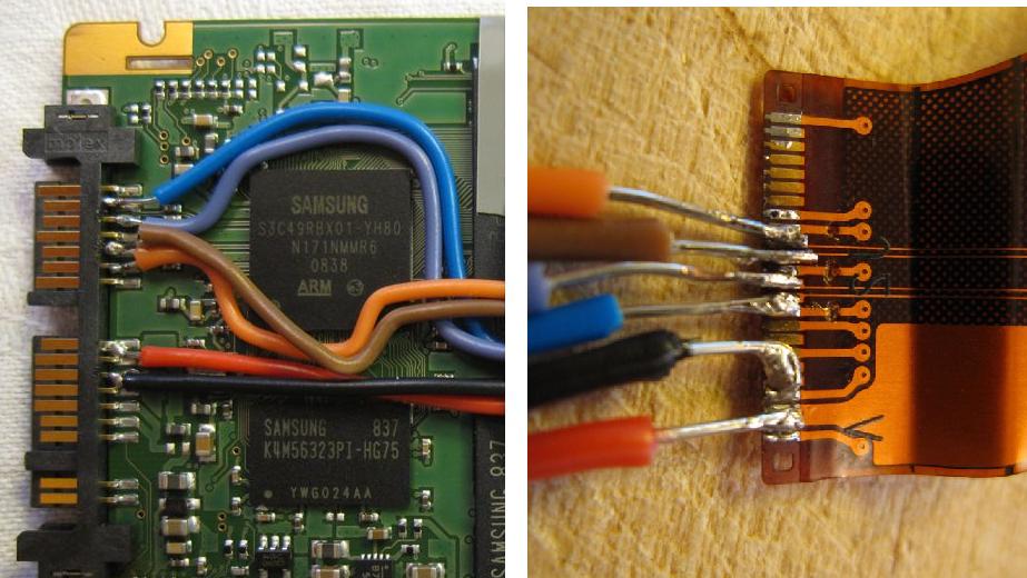

Yes, I think I will try to sort something out by bridging the connector. I saw the pictures before.
The difficulty of this kind of SSD drive is, a single PCB single output interface shares with two SSDs. If you turn over the PCB in the picture, there is another set of controller and memory.
I notice there are 4 pairs of differential signal instead of 2 pairs on all the connector you suggested. I think I need to figure out which 2 pairs belong to one SSD firstly.
DR Research Engineer
 Post subject: Re: Samsung RAID LIF 128GB SSD, any adaptor for it?????
PostPosted: February 3rd, 2011, 2:41
Posts: 17223
ISTM that the layout of each SATA Tx/Rx pair is obvious in this photo:
download/file.php?id=3123&mode=view
The middle two pairs go to the controller in the photo, whereas the end pairs appear to connect to the bottom controller via the plated through holes near the top left corner of the top controller. The group of 6 pins at the end of the connector are either grounds or a +3.3V supply, and probably vice versa for the adjacent 5 pins.
There needs to be a +1.8V supply for the SDRAM, but I can't identify it from the photos.

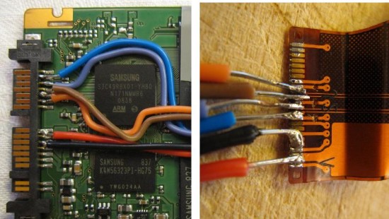

It is Slim USATA not LIF
pin 1 17 20 23 26 should be G
Pin 3-13 is 3.3V (try to use the 1117 to regenerate the 3.3V instead of 5V
the 18-19 21-22 is the Front Side SATA Signal
and the 24-25 27-28 is the Back Side Sata Signal.
If you connect the capacitor of the Back side , remember to reverse like the picture attached.

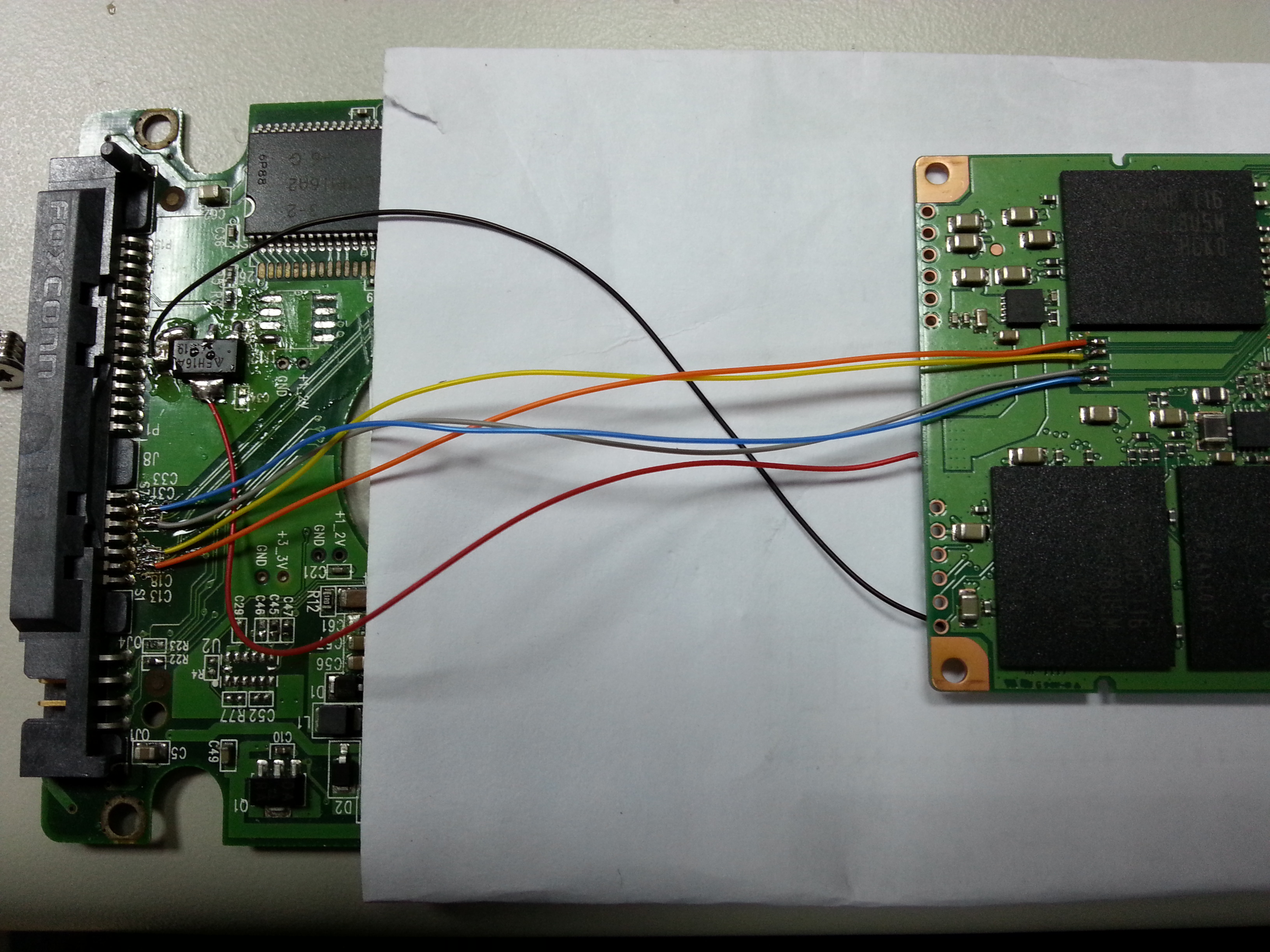

I got some PM. So I decide to put the picture.
This is for this PCB we disscussed. And the previous picture I attached is another layout.
Be sure to USE 3.3V

Forgot to update. Was able to recover the data two days ago.
Case closed.
I appreciate the individual who sent the one PM.
