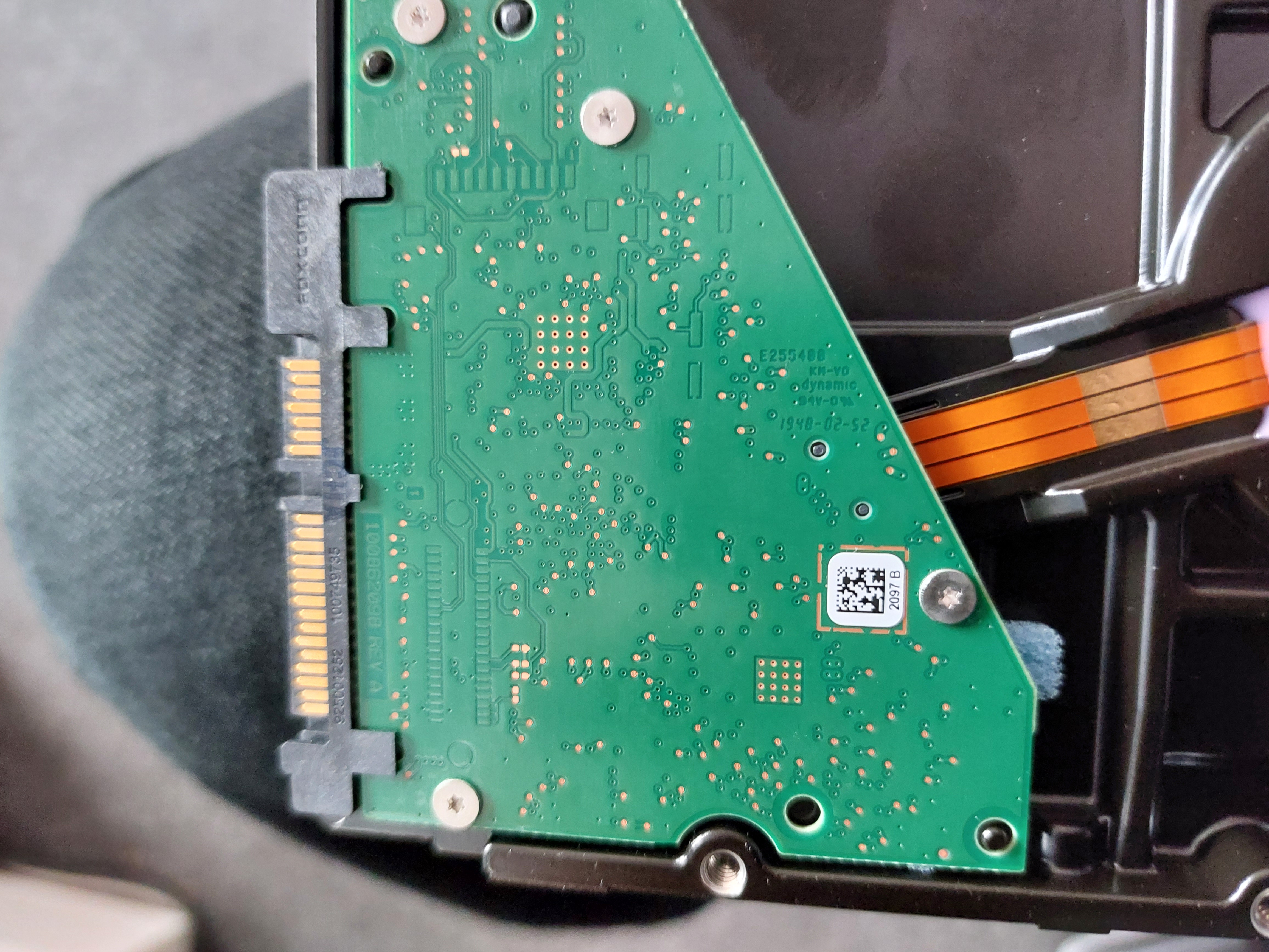

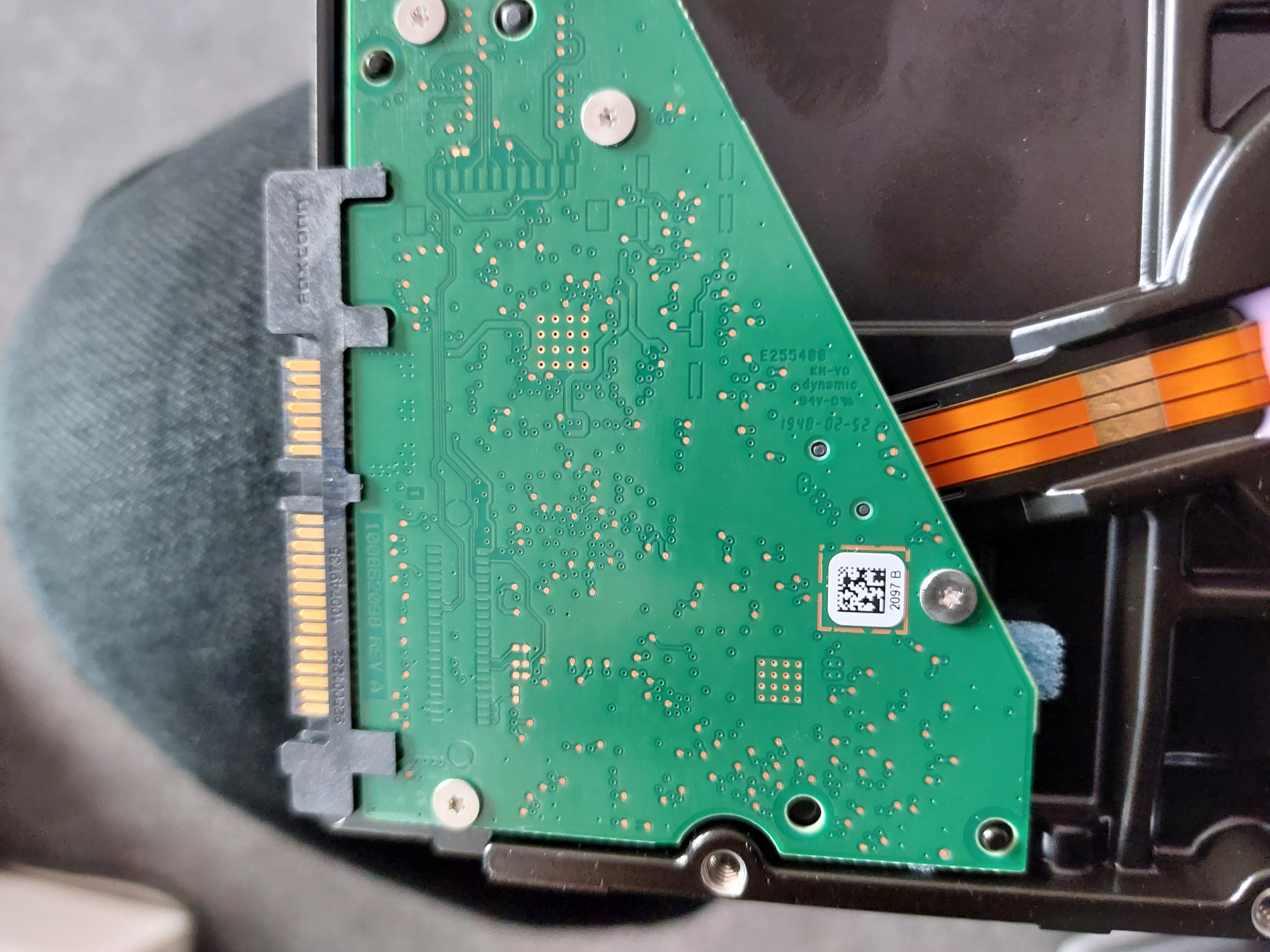

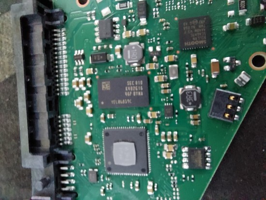

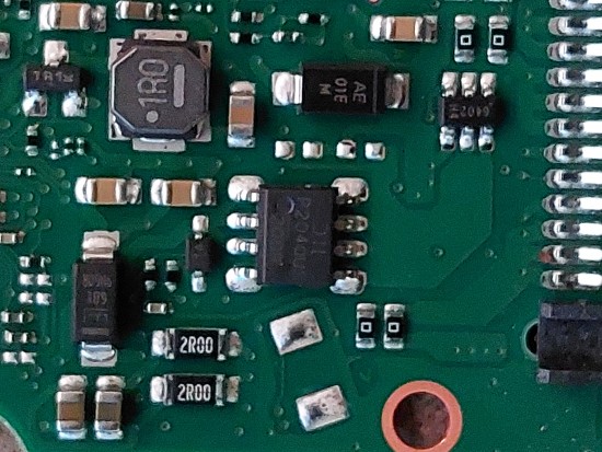

I upgraded the desktop and the motherboard said no bootable drives so I tested drives on another computer and all dead not spinning tried SATA lead and USB to SATA but drives were not detected.
dead drives were
SATA Blu-ray/DVD
SATA 2.5 inch SSD
Seagate 4TB SATA HDD 5400
WD 12TB SATA 5400
I suspected PSU this has been replaced but the drives not working
I have replaced Blueray and SSD
but 2 HDDs,s are tricky I can get a replacement PCB for WD 12TB. from HDDZONE it has 2 bios
But Seagate nobody has a PCB in stock
so I figured I could try to repair its PCB either diode or fuse not sure which
on both HDD's there was no smells or smoke and no burn damage just silent and not detected
SEAGATE 4TB
ST4000DM004
100862098 REV A
SN WFN4B38Q
PN 2CV104-300
FW 0001
WWN 5000C500D3ED24AF
PSID H00H53WL8YV0249GHX8YFS2SGA8QWPT7

Can't see very well from the pictures and I've not had enough coffee to start googling PCB number.
Start with the 0 Ohm resistors by the sata power connector get a meter and check them for continuity.
edit : Before you do anything check the PSU and more importantly PSU cables are the correct ones for the PSU, if you hadn't already guessed that was probably the source of the problem.

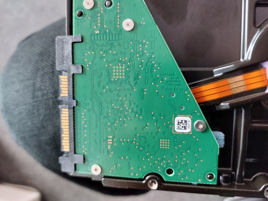

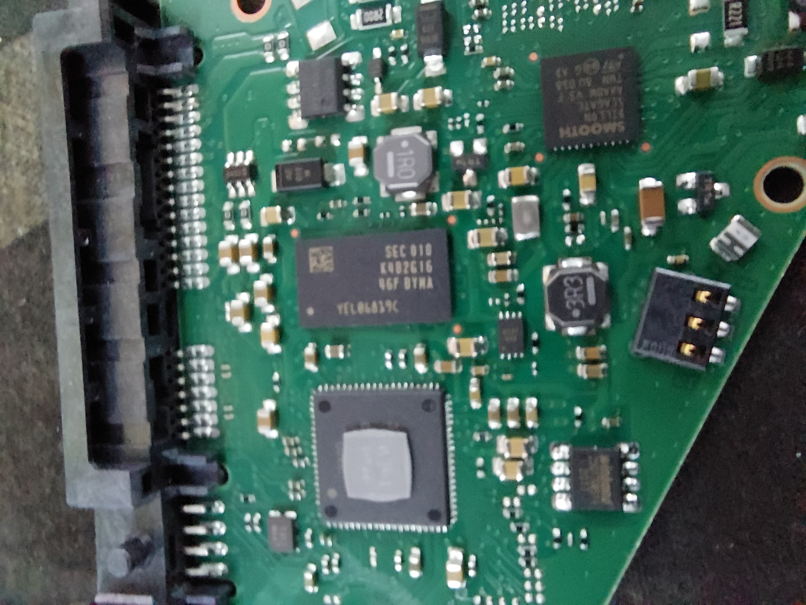

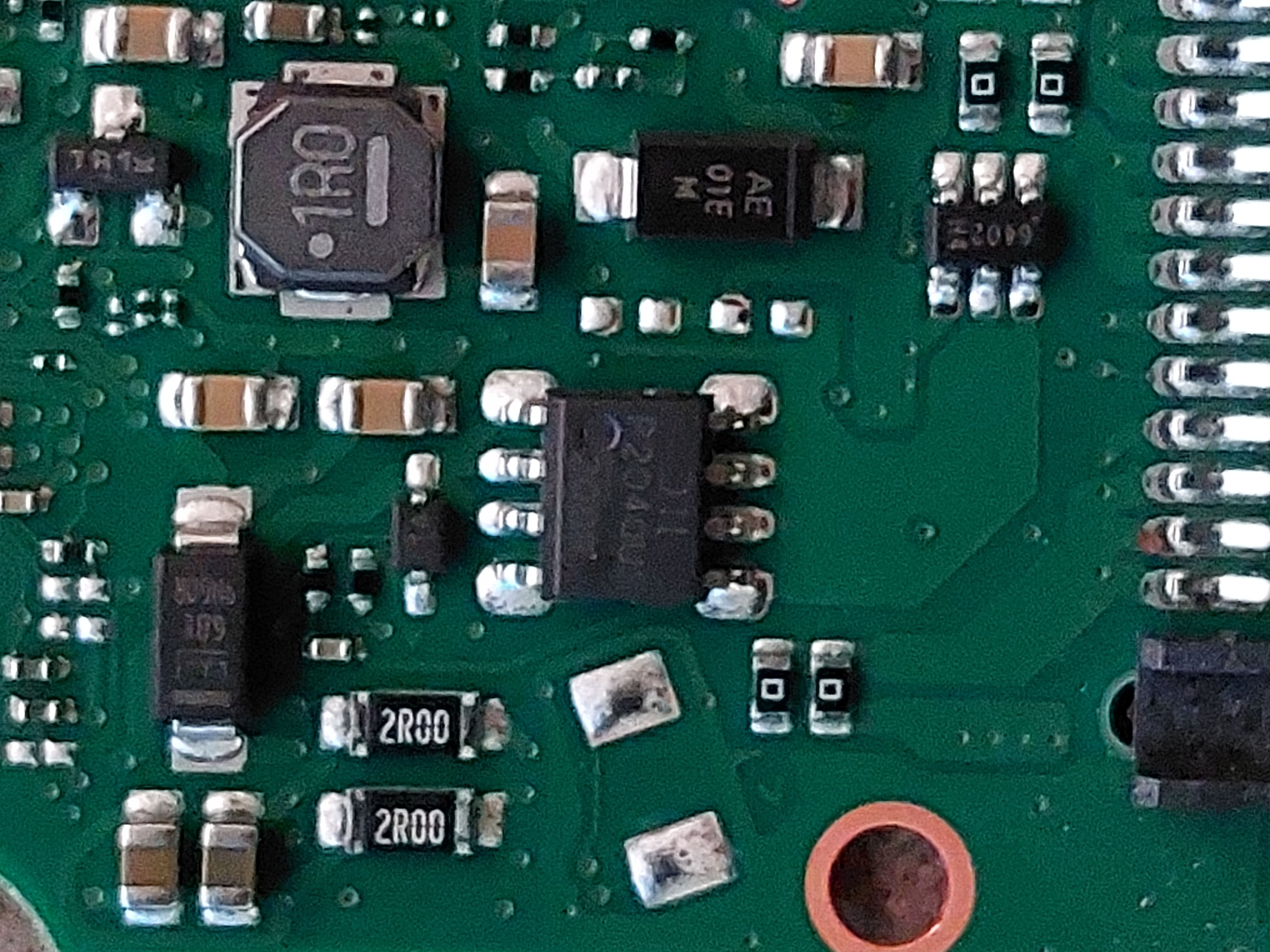

PCB number was in the original post but here it is again
100862098 REV A
sorry about pictures using mobile and macro so not that great

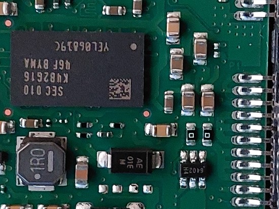

Are you posting pictures of multiple PCBs? Check the 12v rail, the 0ohm resistor below u2 and diode d4 on that one.

The first board is your 100862098 but the second set of pictures posted this morning look to have come from WD 2060-800001. The power protection is completely different between the two boards.

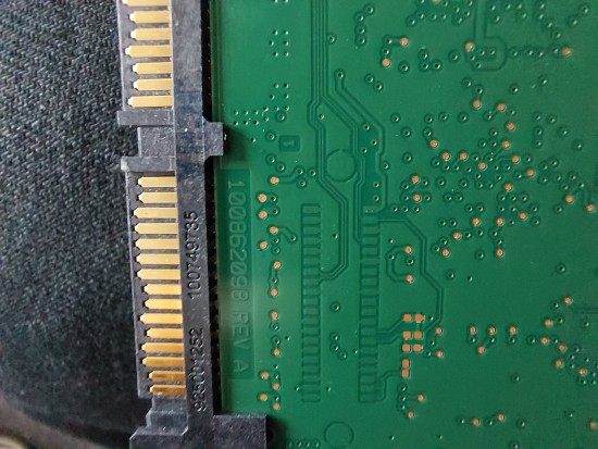

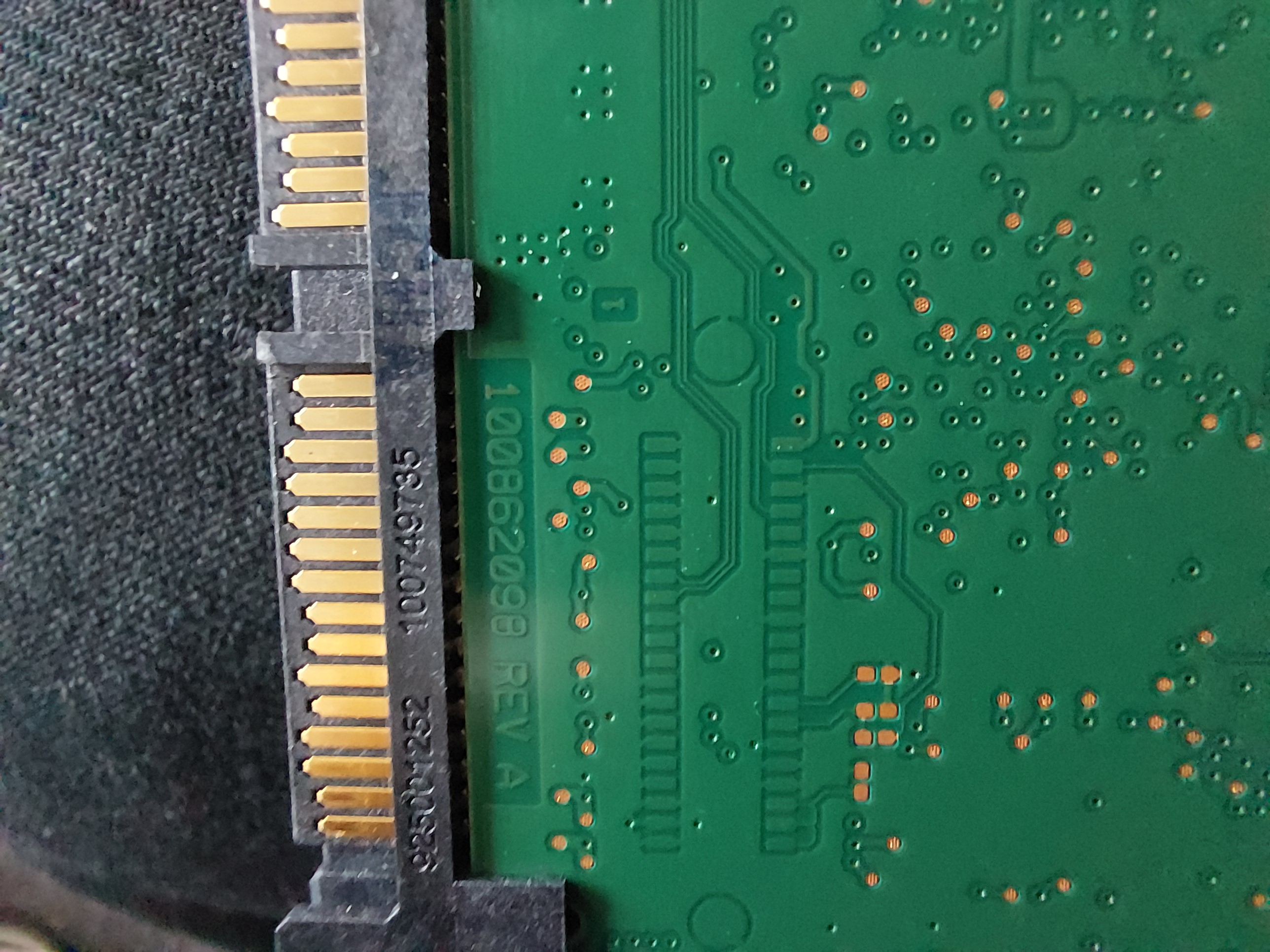

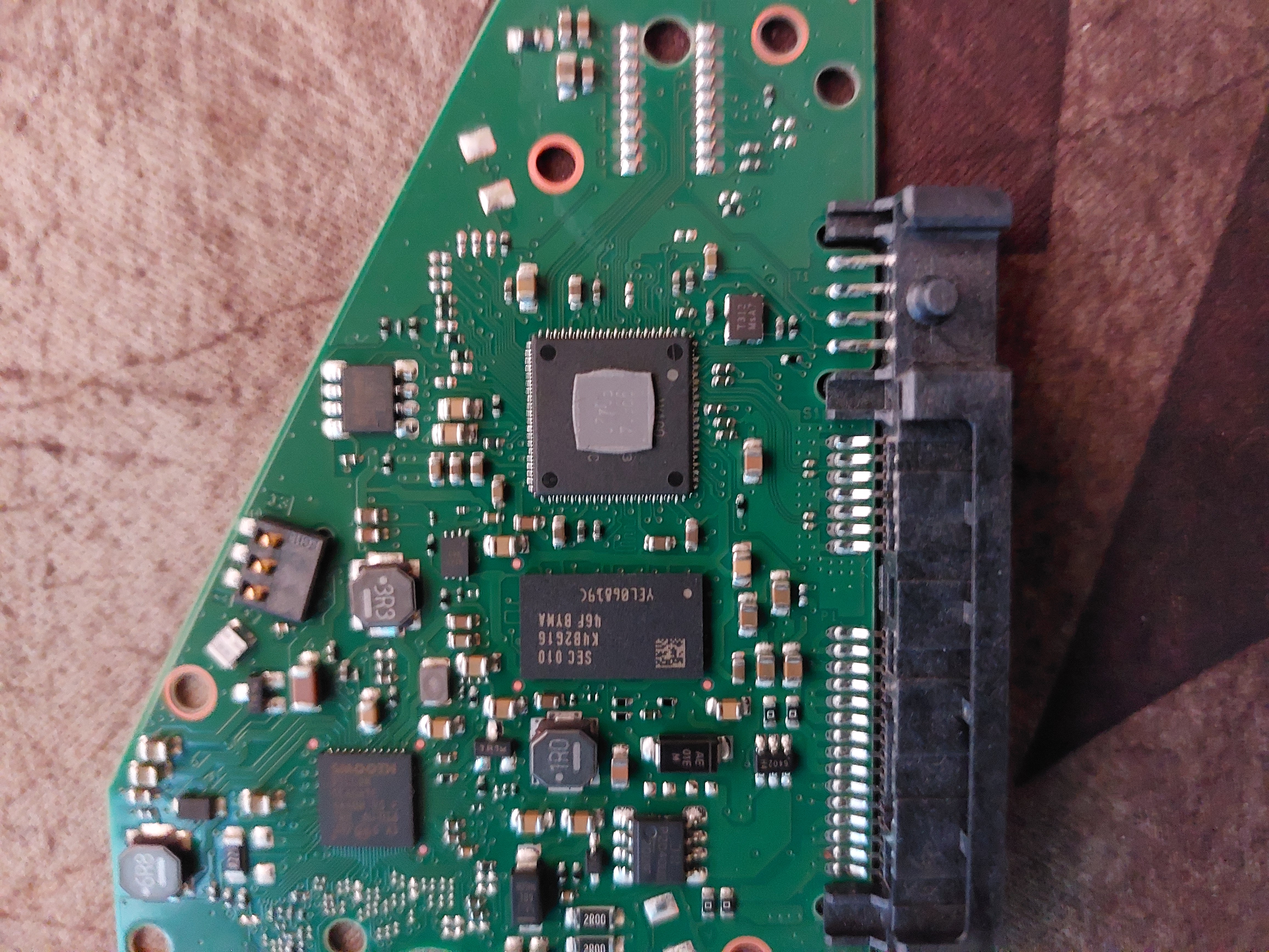

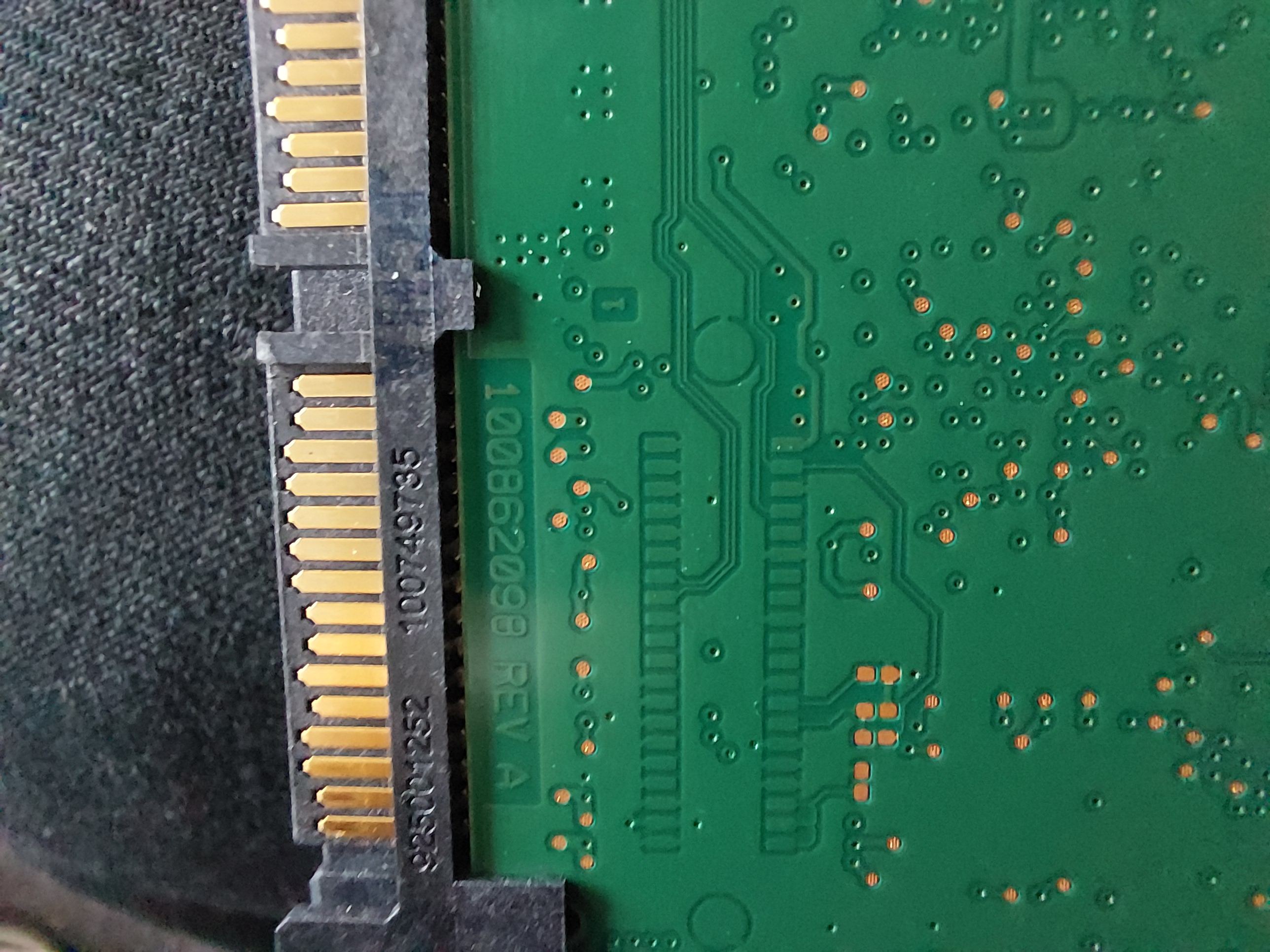

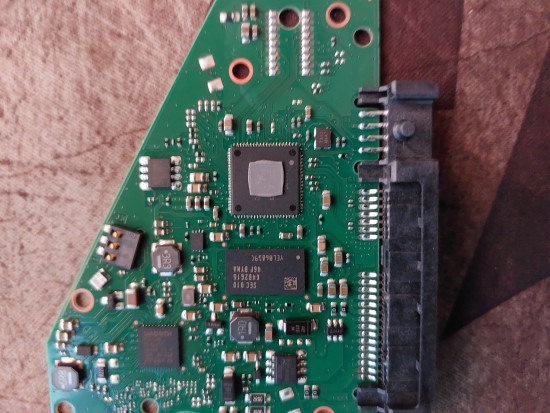

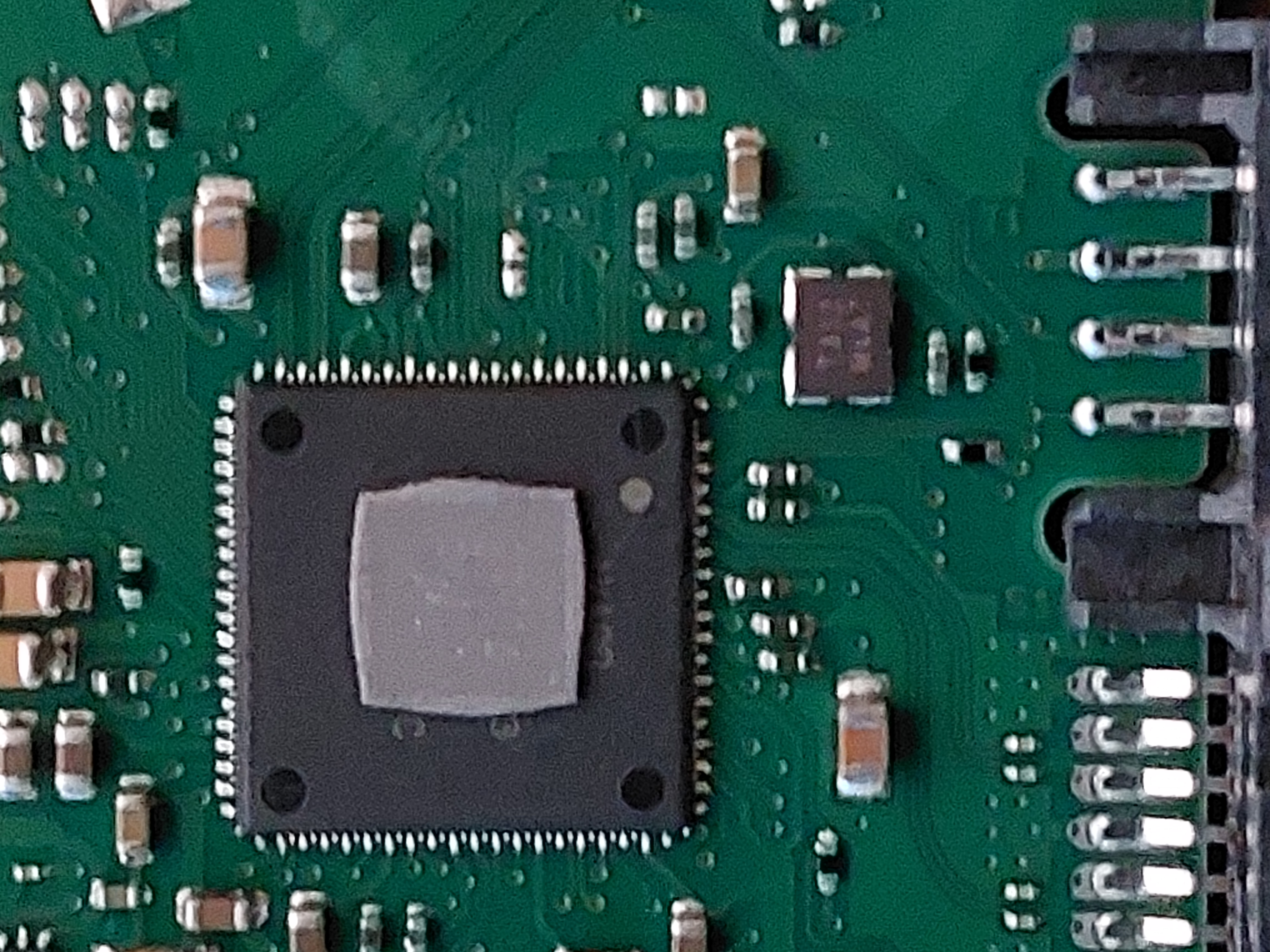

Ok apologies I seemed to have got my drives mixed up
I have 3 SATA drives with issues
SATA WD `12TB
SATA WD 6 TB
Seagate 4TB
I have since deleted all my photos and started again
I am going to upload fresh photos of Seagate 4TB
SEAGATE 4TB
ST4000DM004
PCB 100862098 REV A
SN WFN4B38Q
PN 2CV104-300
FW 0001
I think it would be wise to delete previous post and photos to save any confusion not sure how to do this

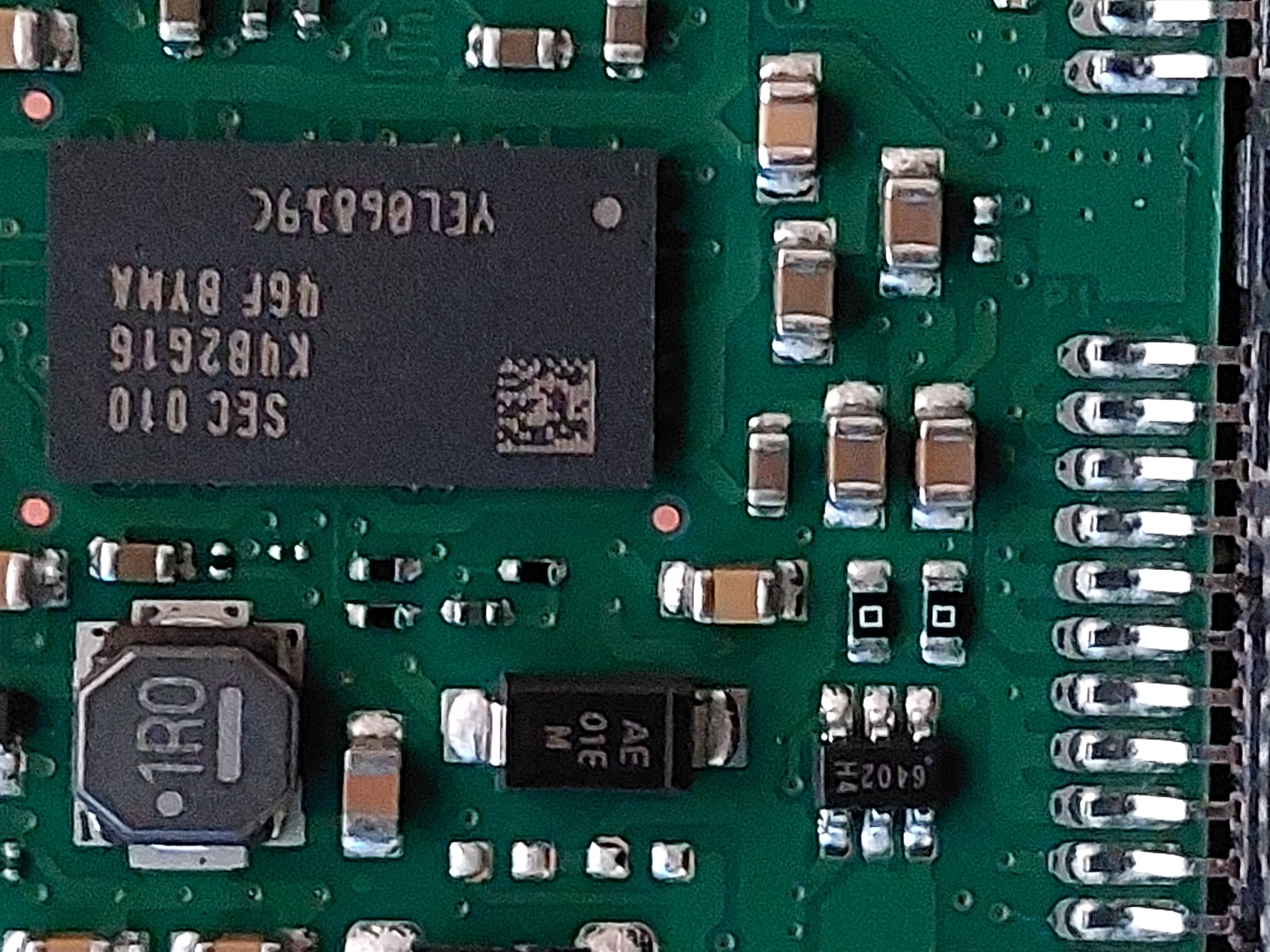

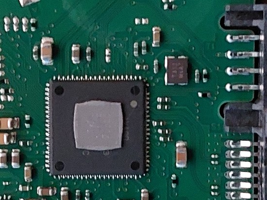

Measure the resistances of the AE and 6B? diodes and the two pairs of zero-ohm resistors ("0" marking).

tested with multimeter AE and 6B diode beeper, short 0 on both diodes both directions.
also tested zero ohm resistors also 0
this was on 600ohm setting
are these dead or do I need meter with lower ohms setting
 Post subject: Re: Seagate 4TB Dead not spinning
PostPosted: March 6th, 2022, 7:50
Posts: 1323
Your diodes should have low resistance in one direction and high in the. The 0 ohm resistor should have 0 ohms, make sure it does and is not open line which may be displayed as OL on your meter. Continuity check (a beep) is easier for those.
It's unusual for everything to give exactly 0 ohms on a meter, and for both power rails to get nailed. Put your meter in the 200ohm range and poke a round again.
